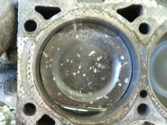

    Here's the situation. I Blew my car up (not quite sure how yet), but I will tell once I take the heads off and get into the engine. I had a track day less than a week ago, and my I/C pump was being very difficult to say the least. Once again, not sure. Could be a beat out rod bearing, failed oil pump, or anything else. The car had 193,398 miles, and ran a 13 flat in 96 degrees earlier that day without the participation of the intercooler.

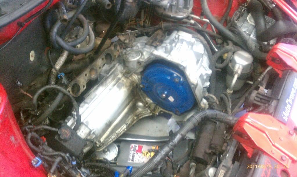

    Screw the big extravagant build. Stuff has popped up that will change my plans.
    I'm going XP or S1x/ Leaning toward XP. I've got a 2500 Mile L26, I'm reconditioning the heads, no milling "maybe slightly" to resurface them. And I'm gonna dial the E85 tune in and be done. (Shouldn't need an intercooler with a good tune) The VS cam and the intercooler are sold and are helping fund the rebuild.
    I figure the XP fights KR better than the VS, so without an intercooler...Yeah. Plus I will get a little more top end out of it than the VS.

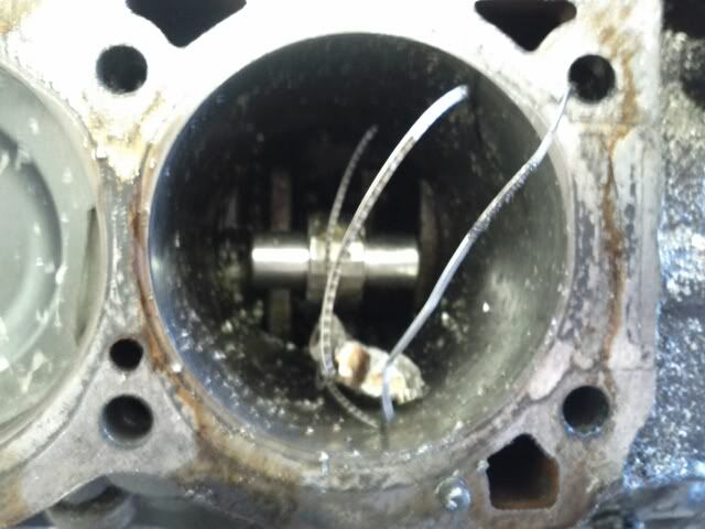

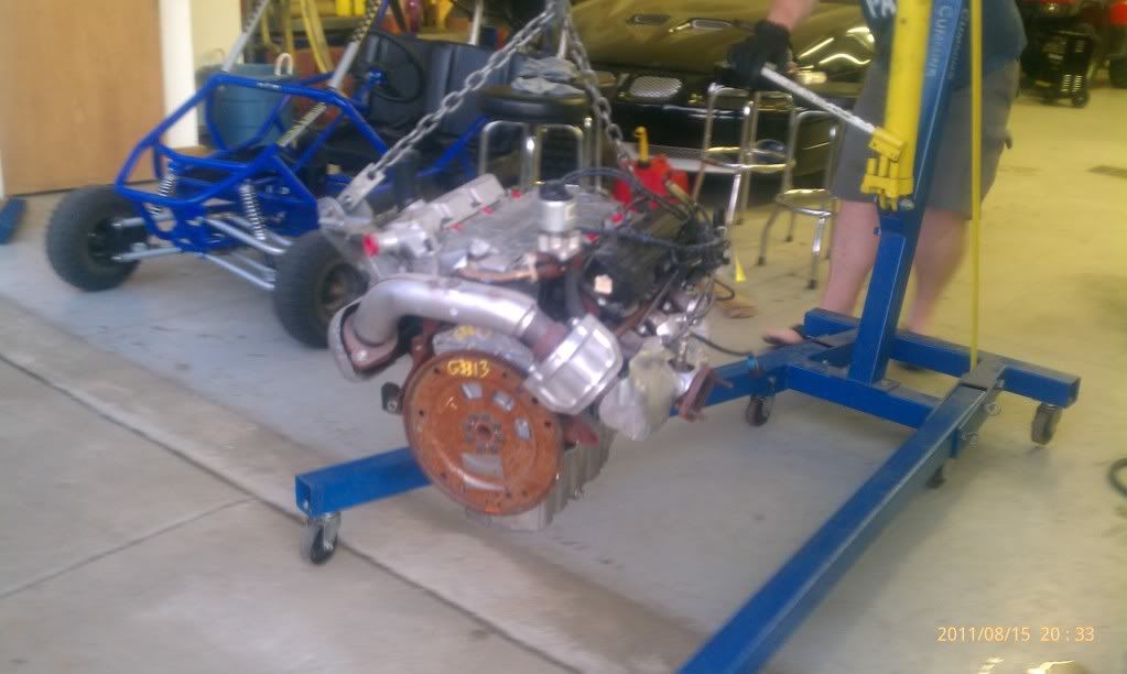

    Anyhow, Everyone love carnage SO HERE'S THE BIG BOOM!!!.
    My Engine died. I was sad
    New block looking all purrty
    No pictures of the chunky piston soup in the oil pan, but I'm sure you guys get the picture. I should be able to make a little more horsepower with the new plan. It will have to do for now. If everything goes smooth, I should be done by the end of this week. Just need to try to find a used cam, or suck it up and buy a new one. Also need one cylinder head because I found out that The big boom cracked my other head
    I will update as this unfolds.

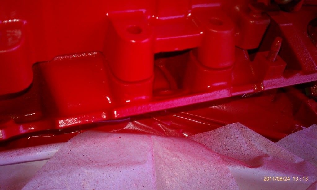

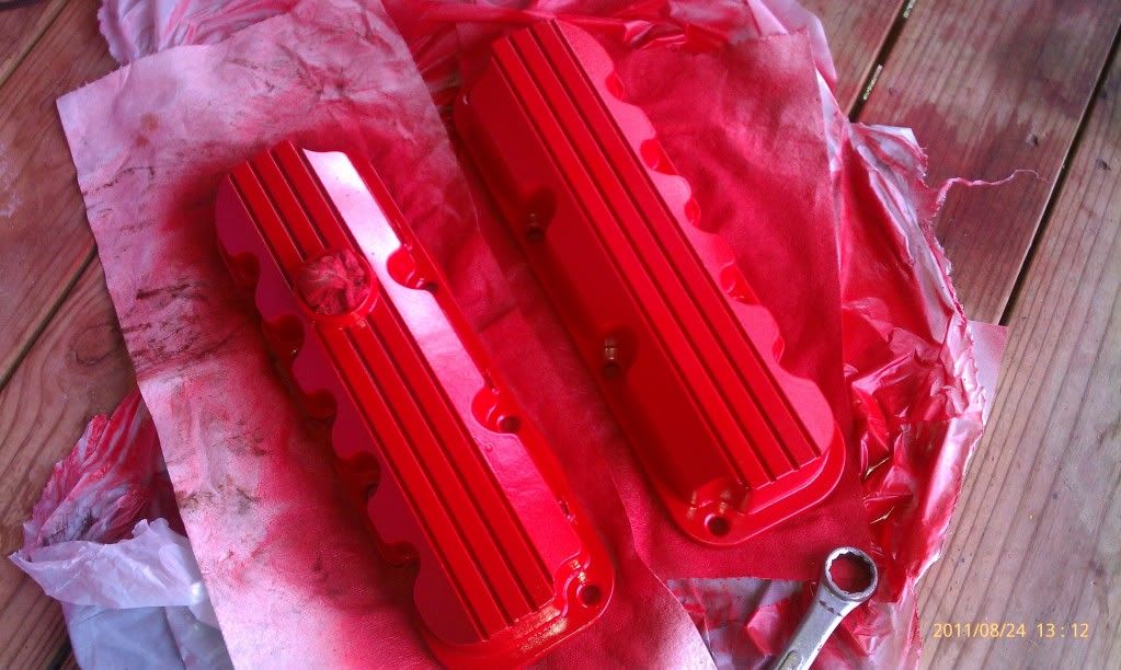

    Just got my cam ordered, and I will be running the S1X. I found it for a good deal so the XP is out the picture. These cams are a little bigger than the VS, and the performance is nearly the same with basic tuning, But with a GOOD TUNE the XP and S1X should out-perform the VS noticeably (especially in the high end). The heads are almost finished. Got a good valve job and they will be very lightly ported. I decided to mill them down .020 for an overall compression ratio of 9.73:1. I like the thought of higher compression with Lower boost. This should be better for throttle response and gas mileage. I also like the thought of not spinning the blower and creating a ton of extra heat to get power.
    While waiting for all the parts to get finished, I had the LIM hot tanked & lightly polished the ports on it. Then I prepped and painted it. I also Cleaned, primed and painted my valve covers, Blower, fuel rails, Throttle body, and TB adapter.
    Early this coming week, She should be re-assembled and running again
