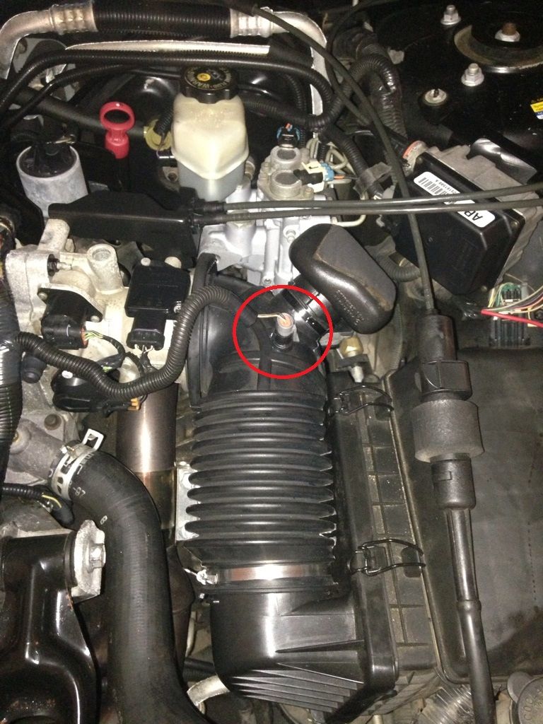

    OK so today I have officially put 100 miles on the Regal, but now am having an issue. I have a P0742 code, TCC stuck on. The car will go through all the gears just fine and normal when I get on it, but when cruising, especially under load (uphill etc) it acts like the TC is strugling to stay engaged. Another thing I noticed is that yesterday, and earlier today my AFR reading was 12.1 at WOT, now tonight I noticed it reads 11.7 at WOT... not sure if there is reason to be concerned, but I found that interesting.
    Now I am also curious about if I was to put a cone filter or "hot air intake" right onto the TB, what do you then do with this sensor? I am pretty sure it is the intake air temp sensor?

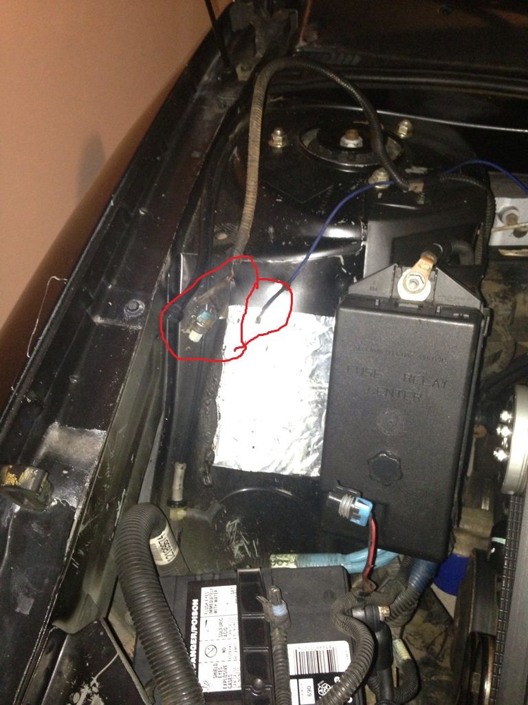

    And after looking around under the hood a little bit I found some stray wires that were just 'hanging out' and have no idea what they are for, where they go, or if they are even necessary.

    You can just drape the sensor over the throttle body so it doesnt interfere with anything. GLW the wires
  7. #227 Re: Build Thread: The Fiero from Hell! Last update 2/21/2013
    i drilled a hole a popped the ait sensor in the pvc elbow i used. or you can zip tie it to the cone, or put it inside the cone.

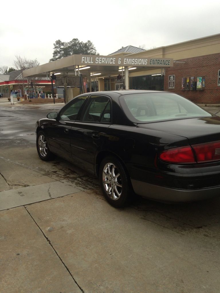

    Today I went and got my emissions testing done, and passed! The PO told me it had a dummy O2 so it shouldn't be a problem. They threw in a free $15 car wash too... Now today I put a big K&N cone filter on the TB so I could hear the blower, I left the IAT tucked up out of harms way. I did a couple WOT pulls and the wideband is now showing 12.7-12.9 AFR when yesterday it was 11.7-11.9, and the day before consistent 12.1. Are fluctuations like this normal? Could it have to do with the removal of the stock air box?
    Another question is about the exhaust. The car has sd headers, catless 3" down pipe, and a high flow 3" cat, then the stock single cat-back. I have heard that this cat back can be a restriction with the regals because it is single. Regardless I will be changing the set up. I am thinking of putting either a 2.5 or 3" glasspack that is about 3 feet long where the resonator is, running 2.5 or 3" back from there to a Y pipe that split to either dual 2" or 2.25" tailpipes. I am not sure how loud and or ****ty this setup would be, but I will probably be finding out! And my final thing I am wondering is if replacing the cat-back exhaust would have an effect on the tune the car currently has? ... Still very happy with my purchase. IMO I got a great steal on a good car!

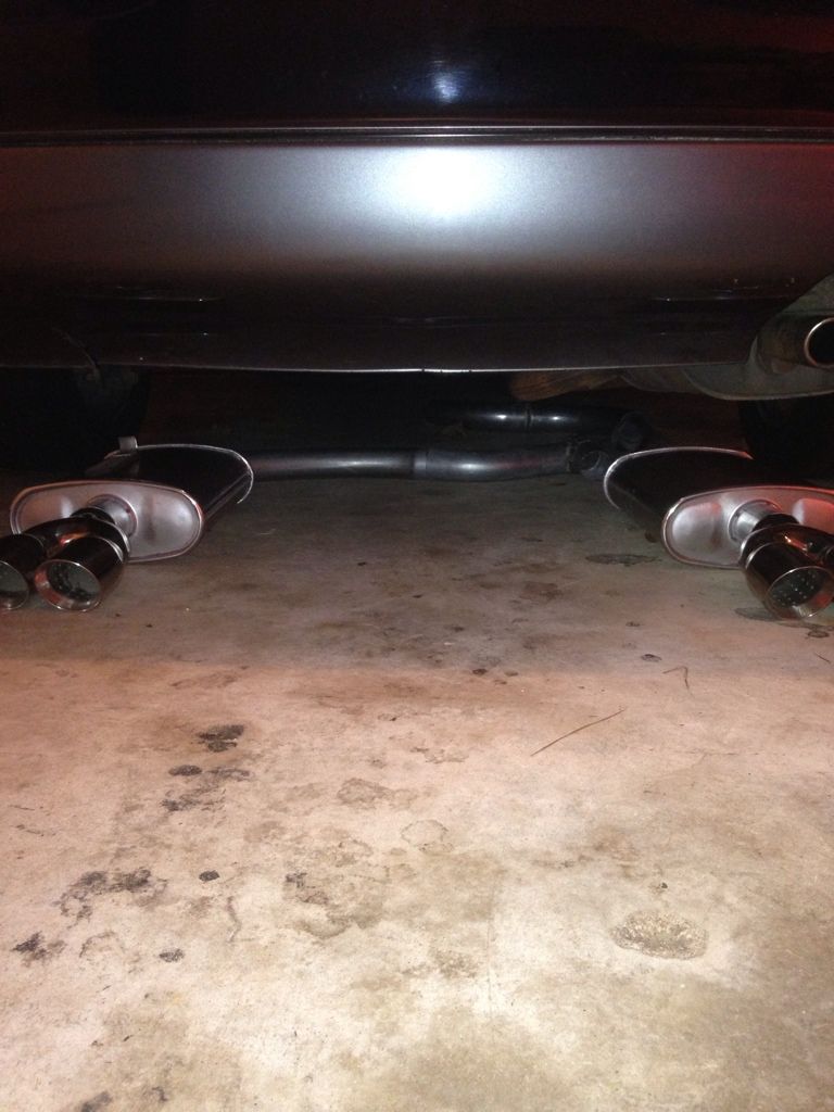

    Made my descision on the exhaust setup! I have a left over 2bolt flange from the speed daddy's that I put on my fiero motor, so I will take that, weld a 30" long core 3" glasspack I ordered today, run 3" after that back to a Y pipe that will split to dual 2.5" pipes back to dual 2.5in/out Thrush Turbo mufflers, and then a a set of those C6 Corvette resonated dual 3" tips. I spent a lot of time watching YouTube videos of many different exhausts, and an fairly sure this will be exactly what I am going for. Not really loud, and no droan or raspyness, but a decent little rumble to it. I think it is kind of funny that the cheapest mufflers sound the best.. Pics will come soon, I am going to start making my Y pipe tonight, and the whole setup throughout the week, the glasspack should be here by Thursday, and already got the mufflers from the local auto parts store. The guys there hook me up with employee discount so they were like $23 each! I would expect to be hooking the new cat-back system up sometime next week!

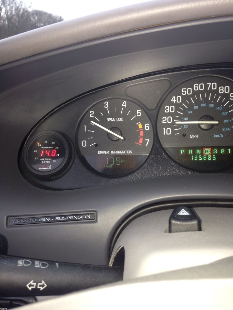

    How my wideband is mounted in the dash..

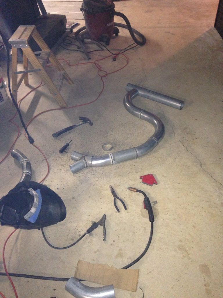

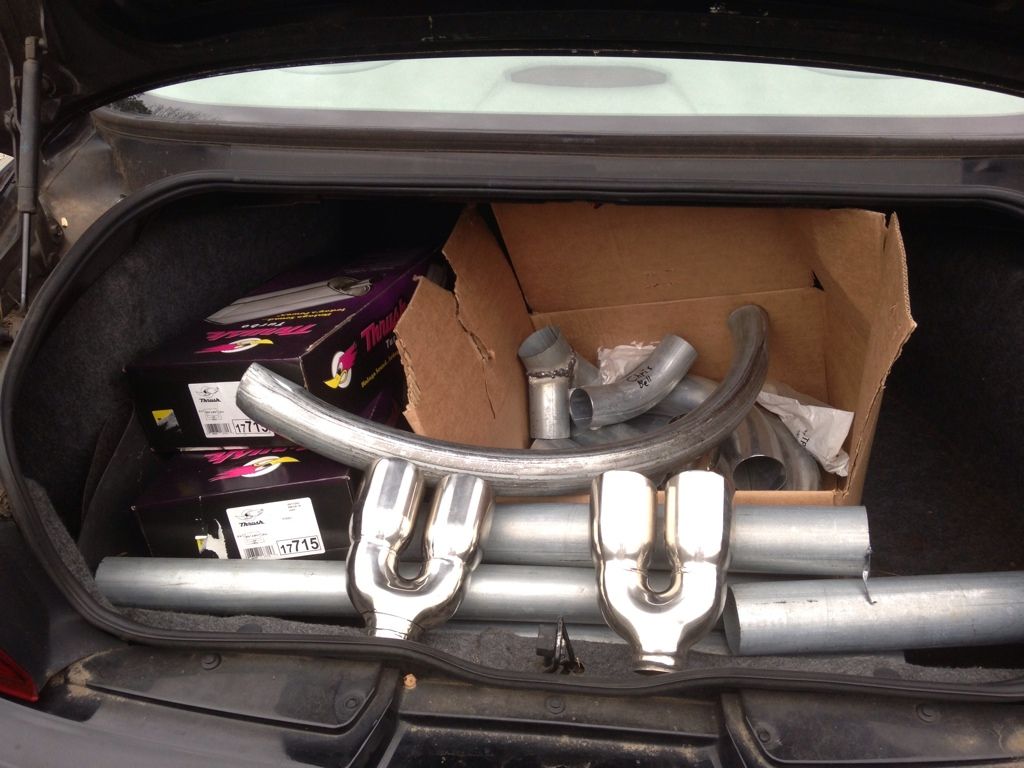

    Got some parts from work to start peicing my exhaust together. Found a good amount of 3" mandrel bends to work with. Glasspack should be here by Thursday, hopefully bolting the new cat-back on sometime next week.

    I thought about those thrush mufflers, actually i was looking at those exact ones 17715 at work. I didnt really think they would sound good but now i think ima pick up a pair cus im sick of my stock mufflers. Not sure what res im going with though. Thinking just a thrush glasspack as long as i can get it.

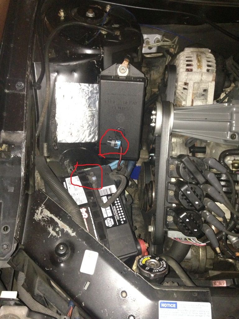

    did you ever figure out what that blue wire by the fuse box in the engine bay is for? my car has the exact same wire and i have no idea what its for
    I listened to just about every youtube video of exhaust on these 3.8L's and boy do most of them sound like a nasty wet fart.. I ordered a 30" glasspack through Ebay from Summit for like $48, it is the same length as the stock res (30"). From what I understand these mufflers are really quiet for aftermarket, and should make for a good deep tone. Jones Exhaust Muffler Glasspack 3" Inlet Outlet Steel Blank 30" Overall Len Ea | eBay
    No I did not figure it out, but after doing some more looking around I am pretty sure it is a power wire that was ran at one point and time for a aftermarket speaker setup. The other end came out in the trunk.
    And just for fun, here are some pictures of the exhaust build as it sits so far..
    Here it all is roughly mocked up
    And the progress I have made thus far
