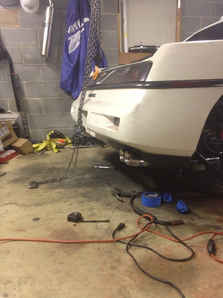

    As of right now yes, but he has plans to "roll" the rear bumper so it is all flush again, it will look as if it was never intended to have tail pipes.

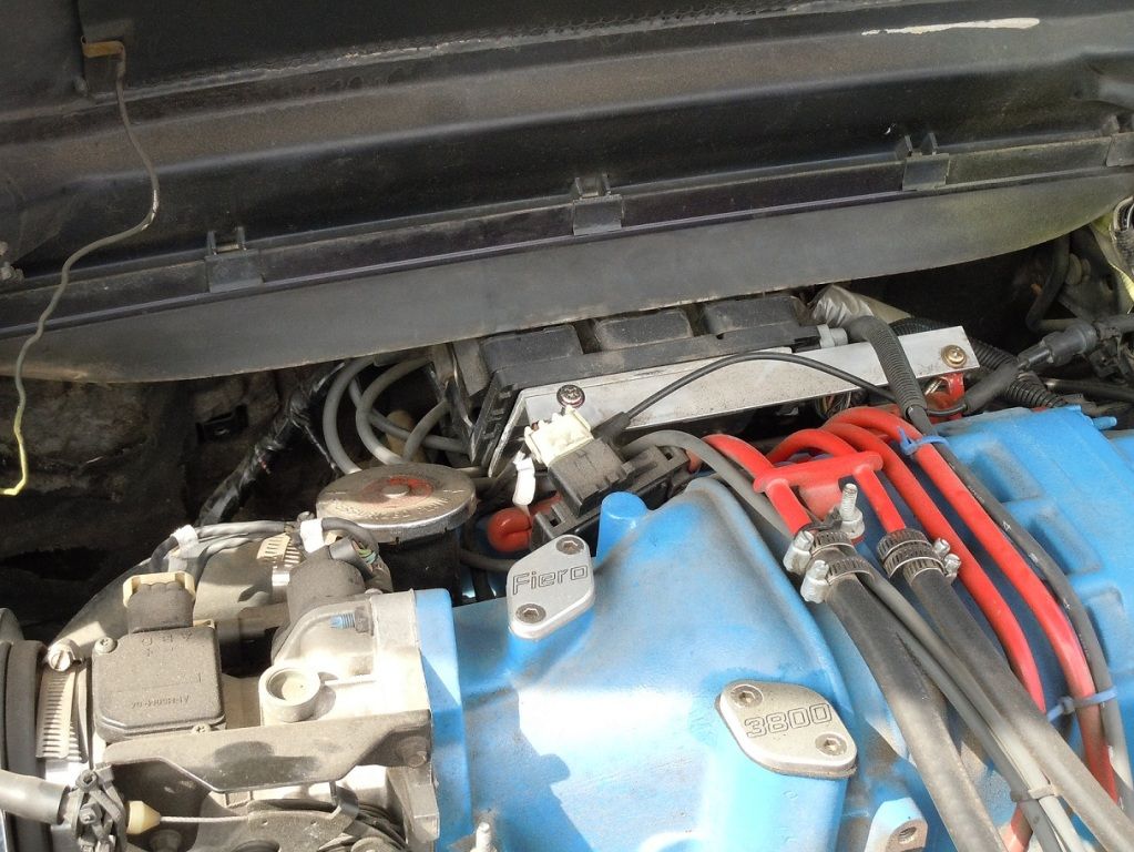

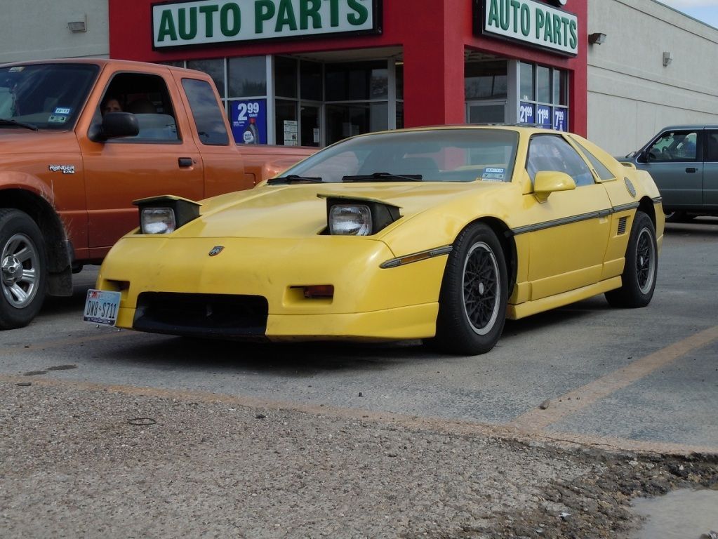

    Next time I'm home in TX, I need to go by the parts store, a worker there has a Fiero with SC 3.8 in it, 3.4 etc etc. It also has a chopped top. I will get some pics for you to enjoy.

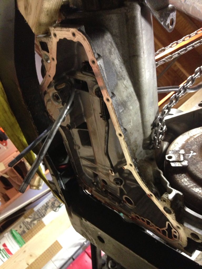

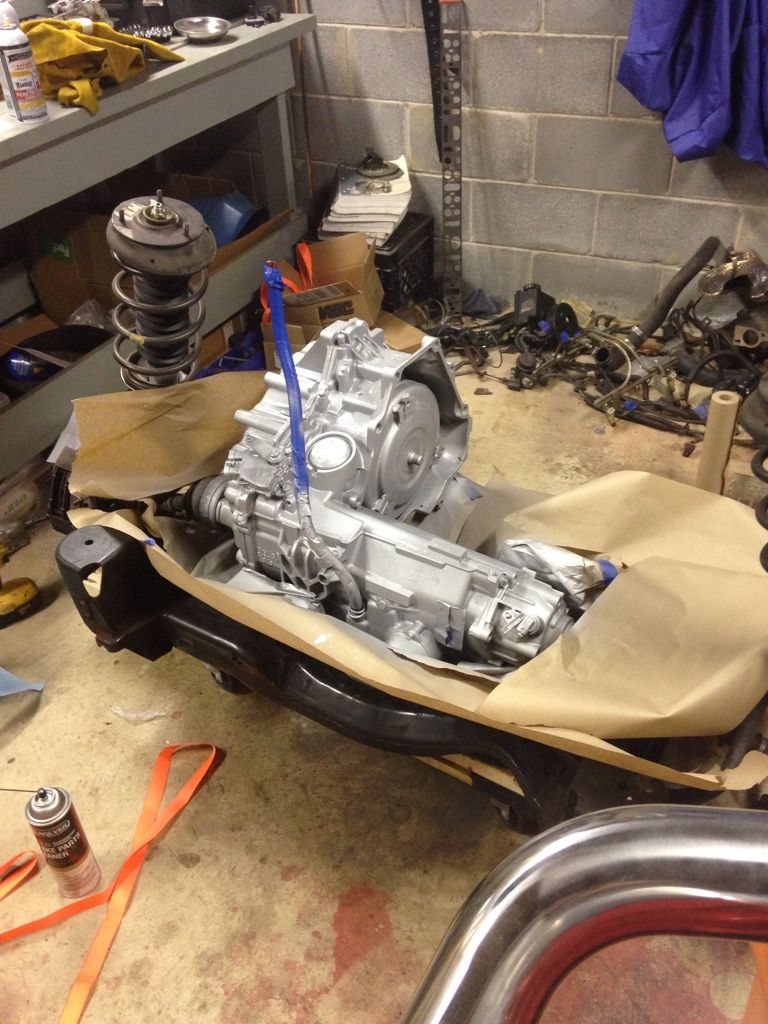

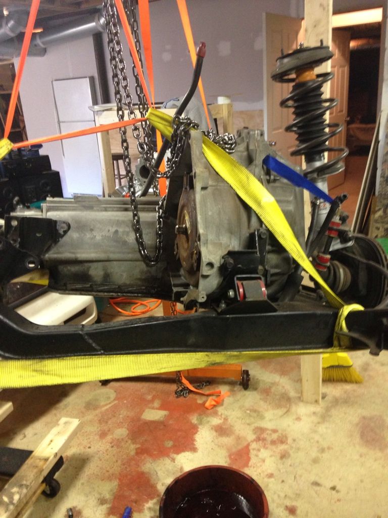

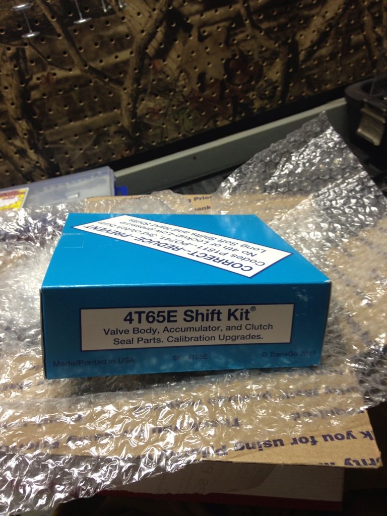

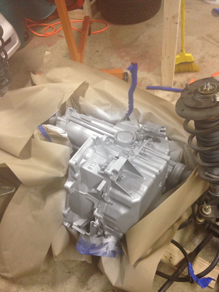

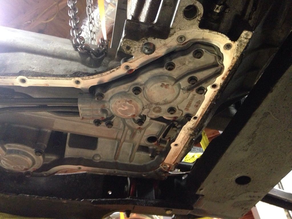

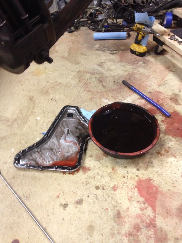

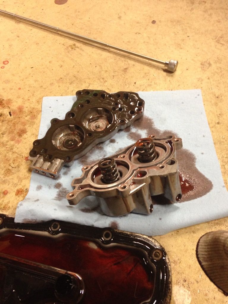

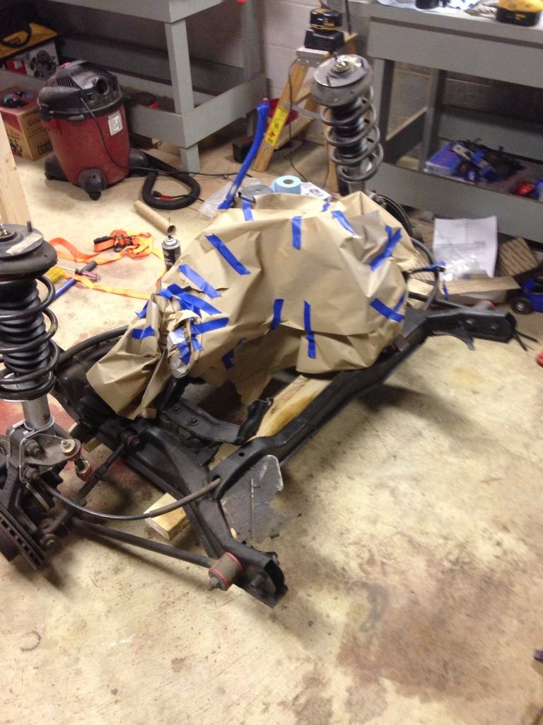

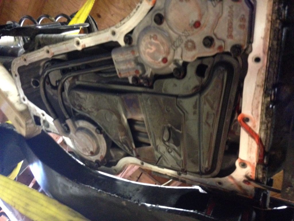

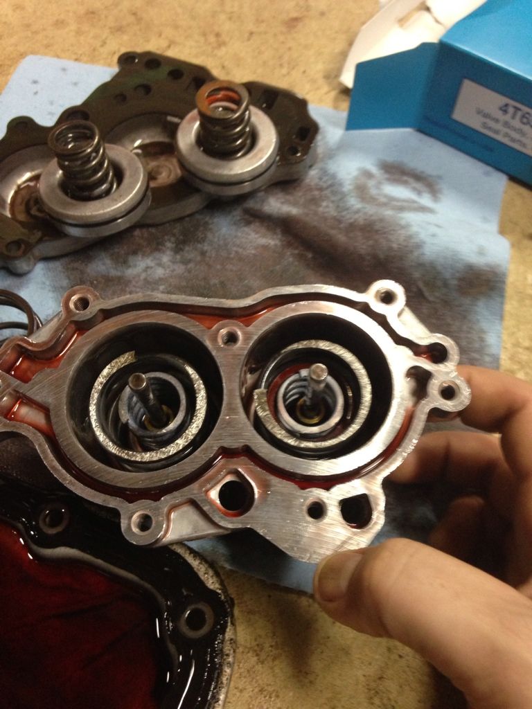

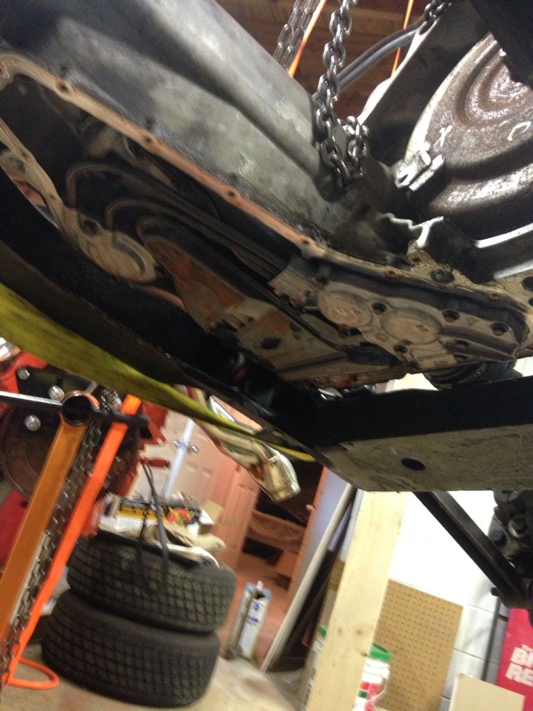

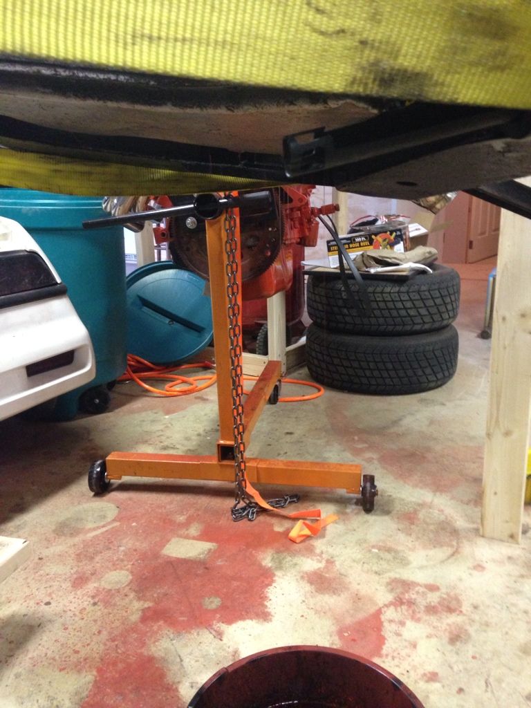

    Well got the renovations in the downstairs "done" for now, so I hit the car today. Installed a TransGo shift kit, new filter, and new gasket. Then gave it two coats of paint.
    shift kit
    getting ready to drop the pan
    Draining the fluid
    pan dropped
    Filter removed
    Accumulator removed
    New springs, and shims installed
    Transmission reassembled and painted

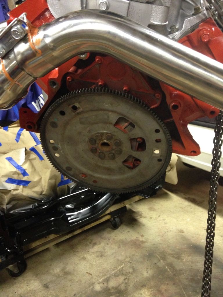

    new flex plate and the long awaited remating of the motor and transmission should come tomorrow!

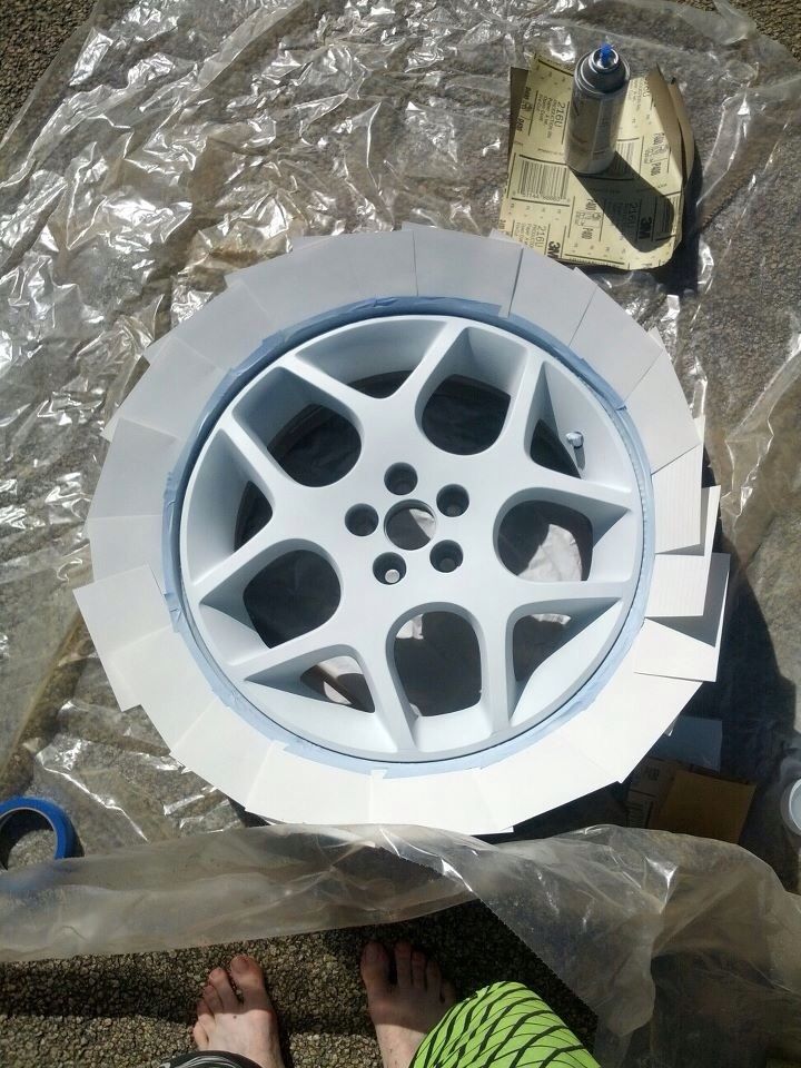

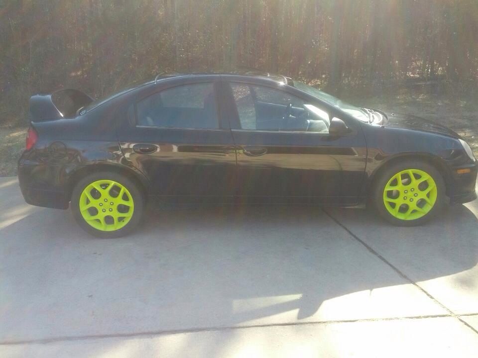

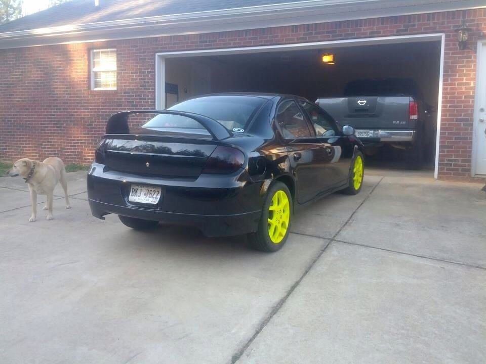

    also some updates on the SRT-4, he decided to paint the rims lol... And a pic with the rolled bumper.
    Rolled bumper, and finished product with the rims.

    Didn't realize they made 4x4 srt4's lol. Did you track any trans fluid into your room? I'd hate working on my car so close to my room because I'd never get any sleep.
  7. #187 Re: Build Thread: The Fiero from Hell! Last update 2/9/2013
    GT Level Member 88formula's Avatar
    Oct 2012
    West Branch, MI
    341
    You would be surprised how clean I managed to keep the floor considering that I dropped the trans pan. Everything but a few drops made it into my drain pan. Maybe I set a record or something? Lol

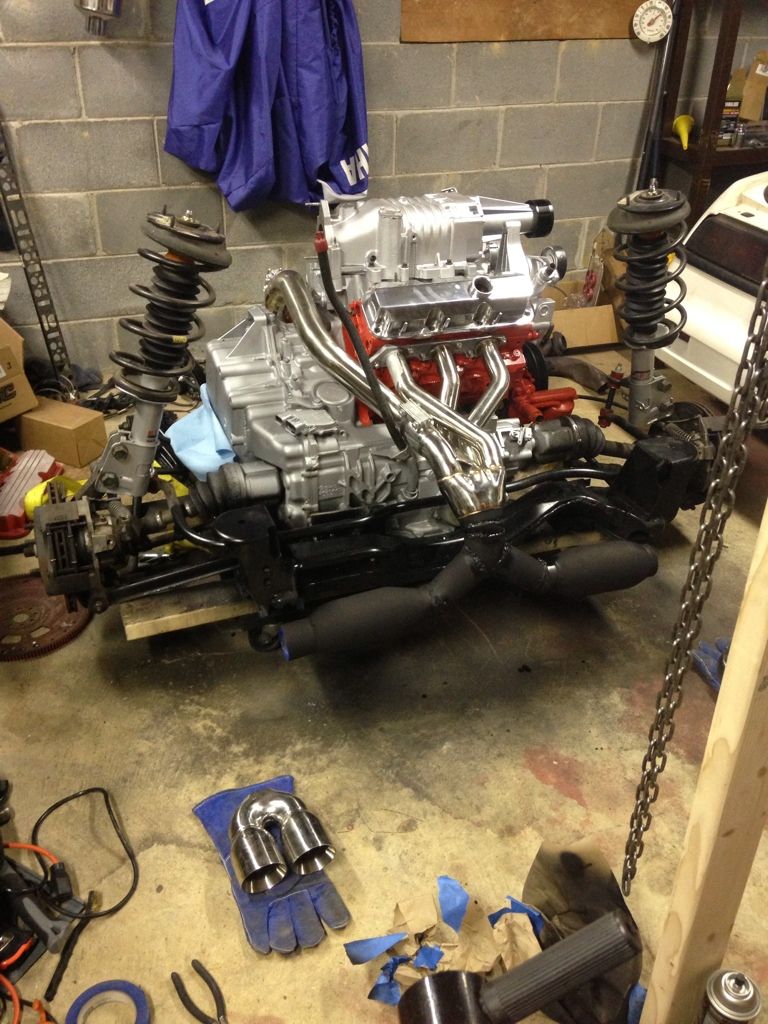

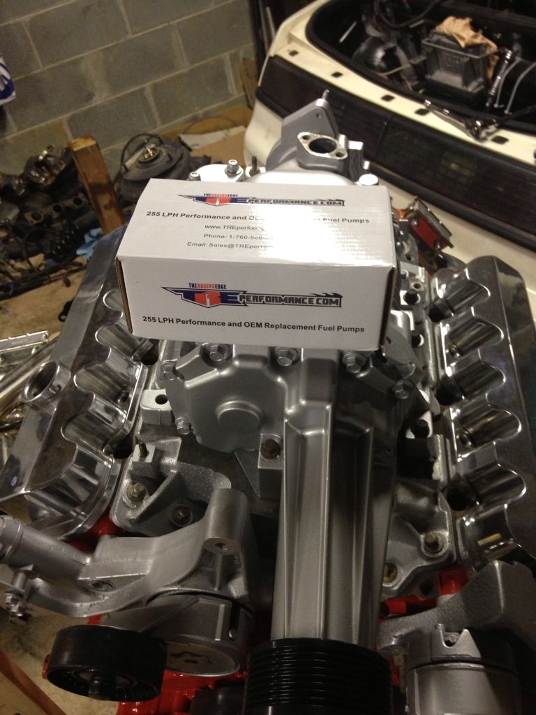

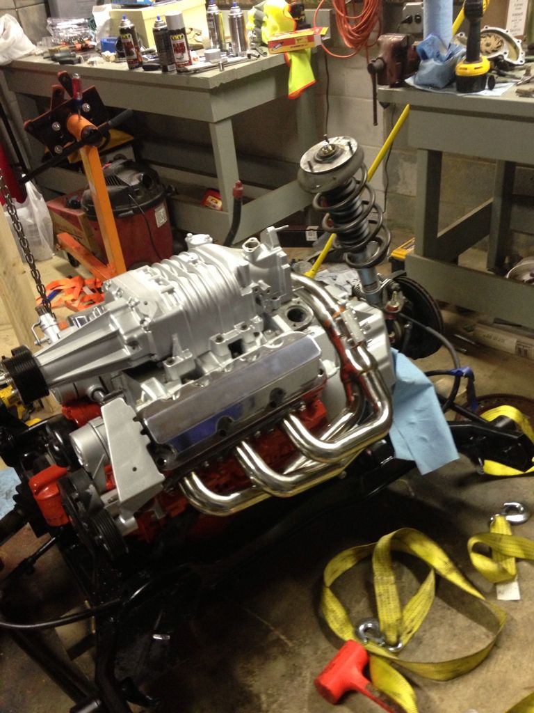

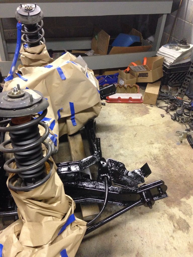

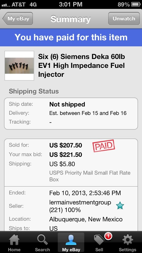

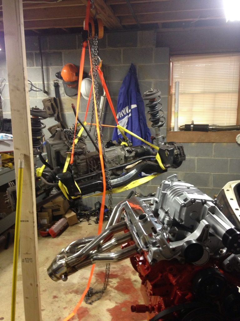

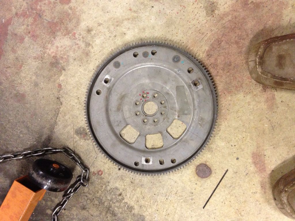

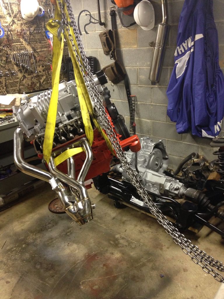

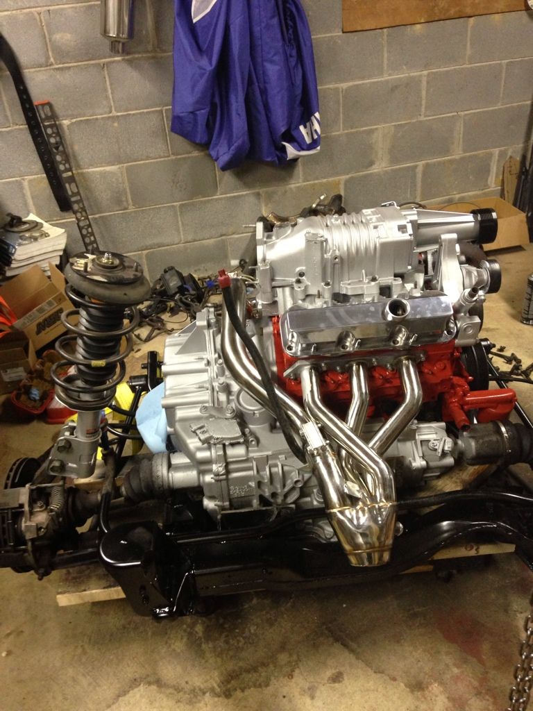

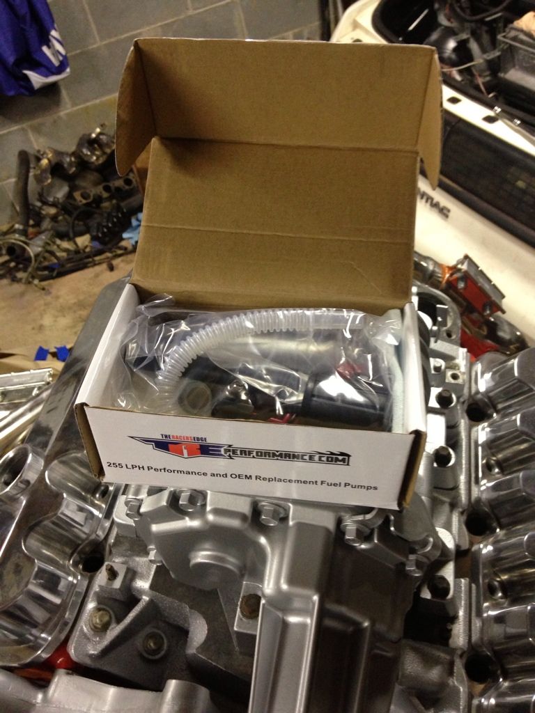

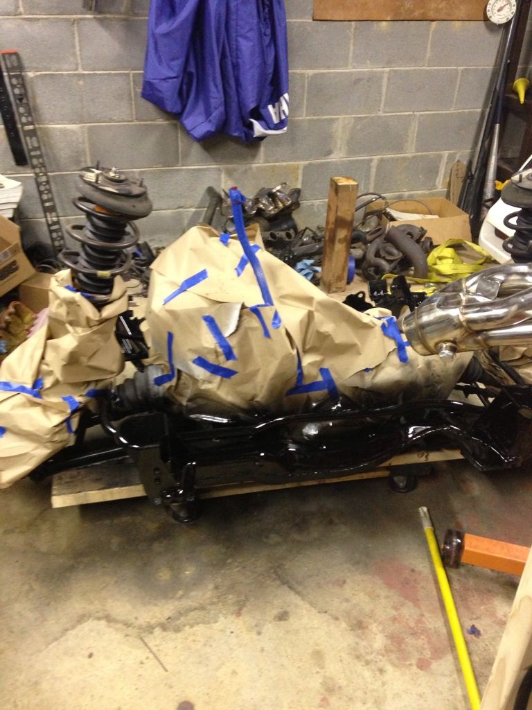

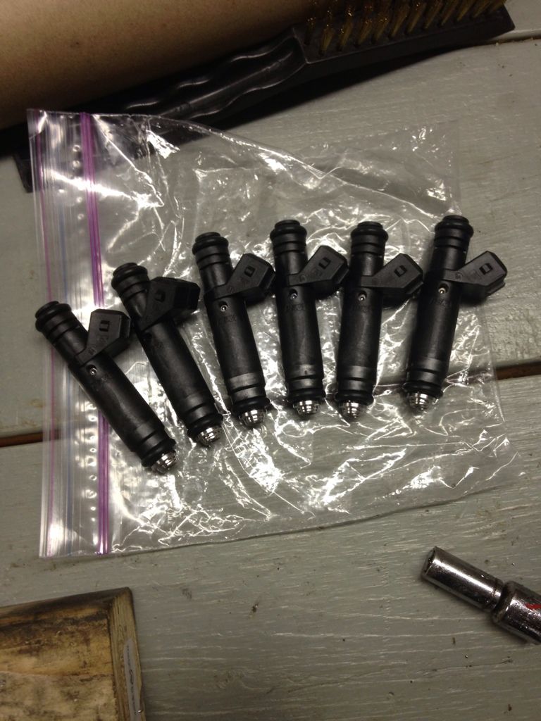

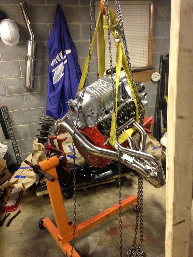

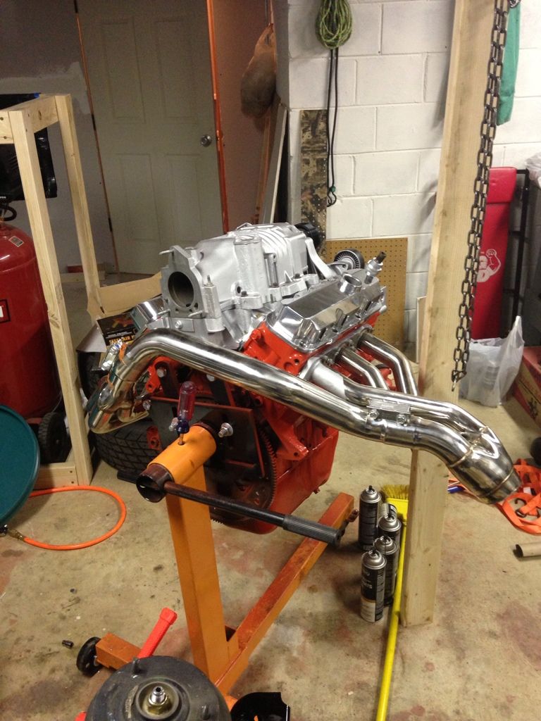

    Did some more work on the car today, and finally purchased some injectors!

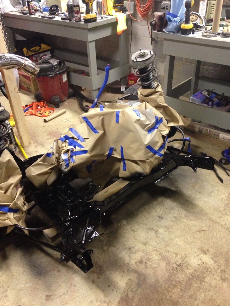

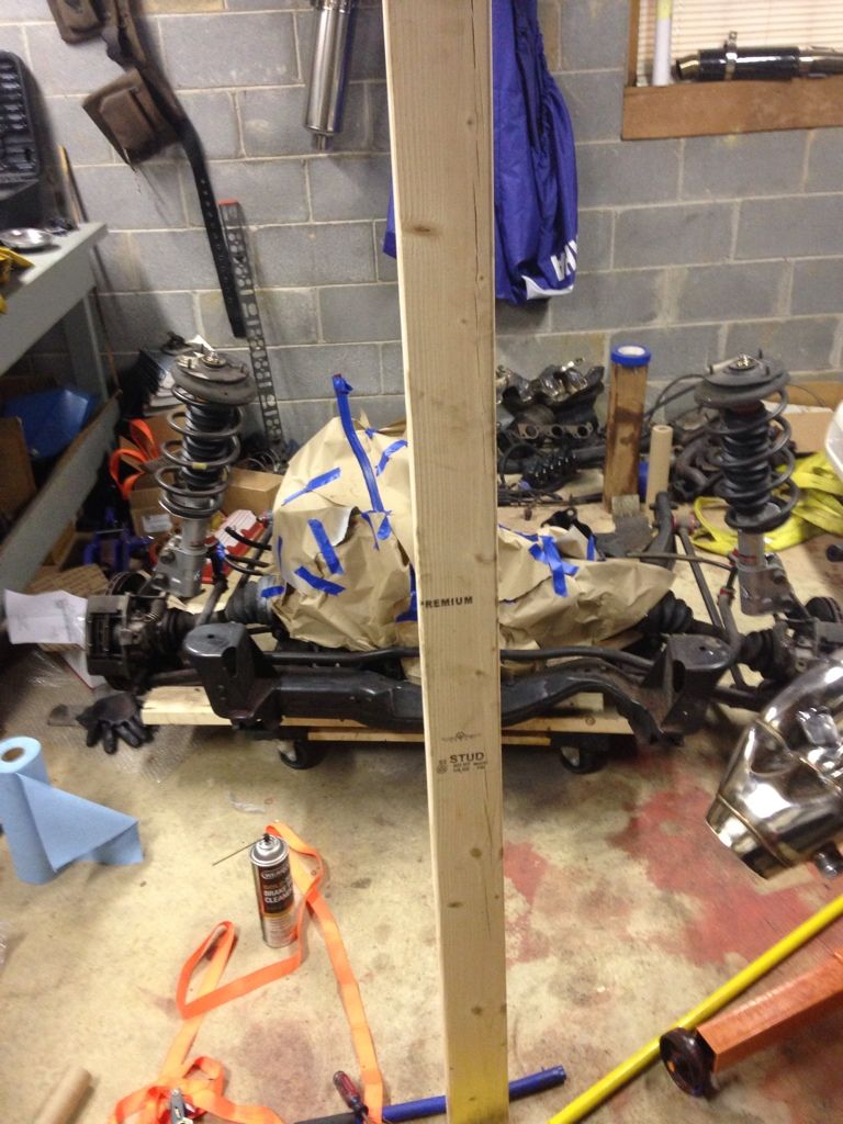

    Cradle prepped for painting
    cradle painted
    headers installed
    Got my brand new injectors for $213 shipped
    new 255LPH fuel pump

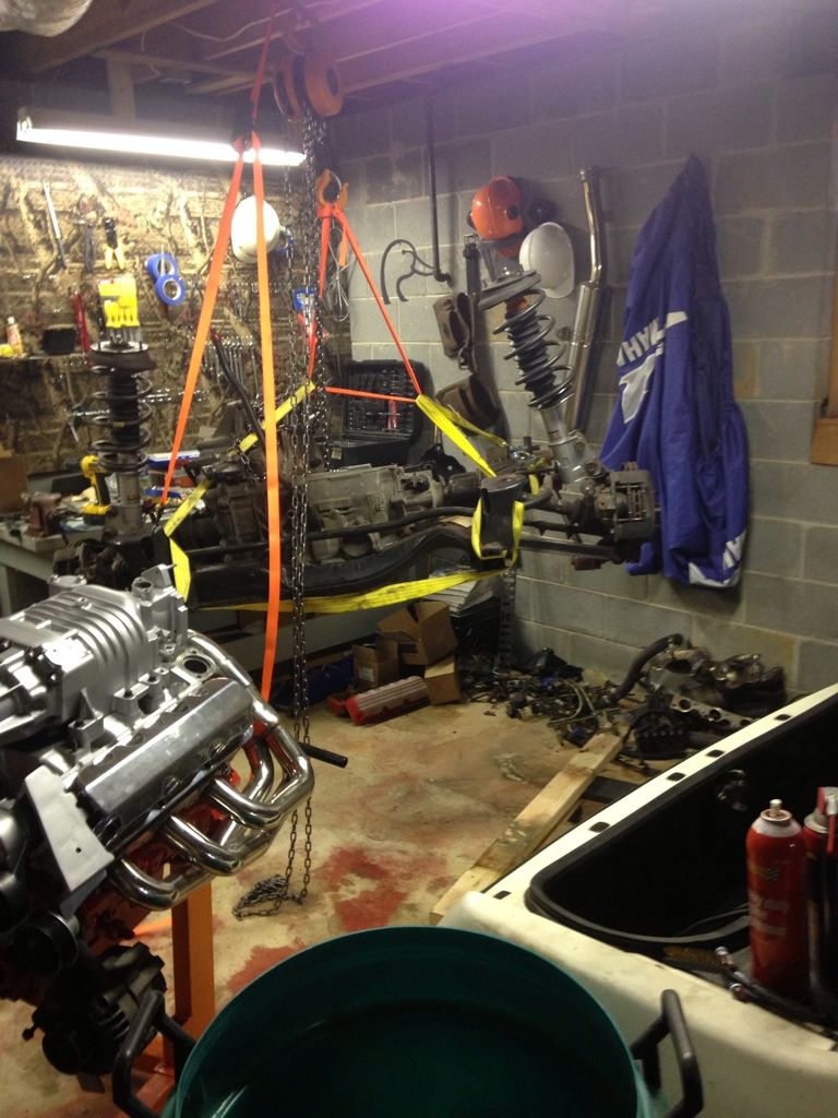

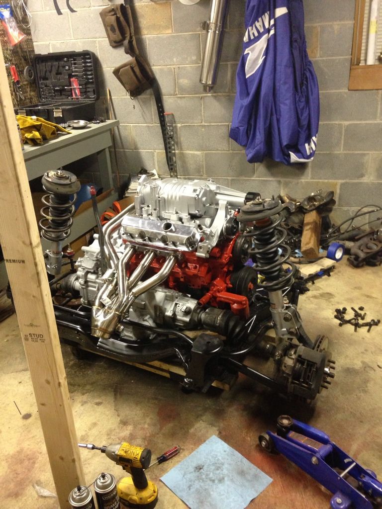

    Putting my new flex plate on
    Time to rejoin the motor with the rest of the drive train!

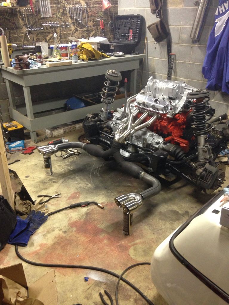

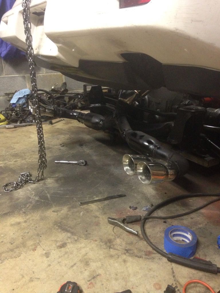

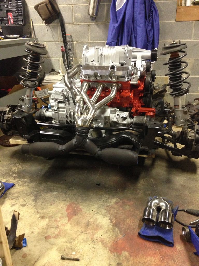

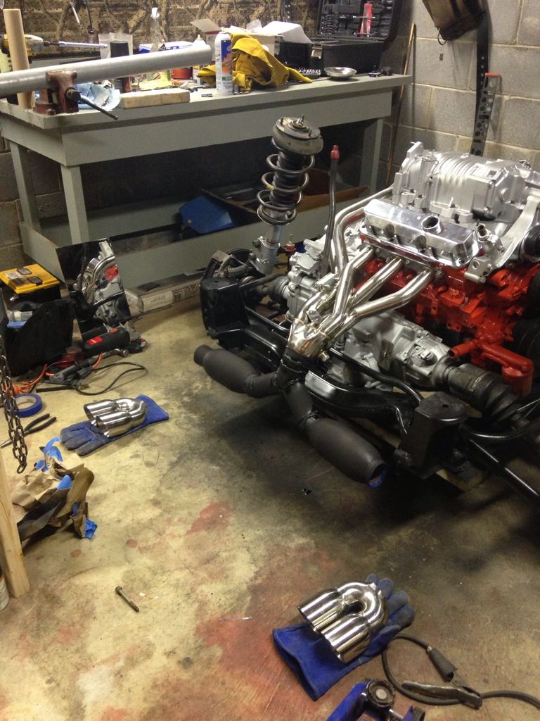

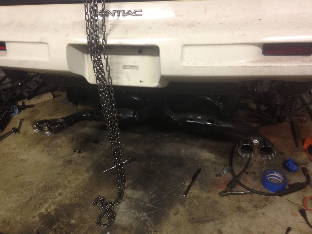

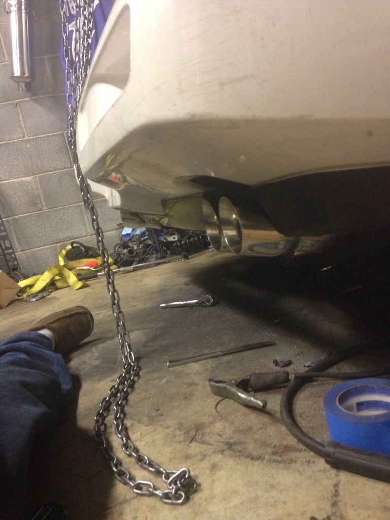

    Got my new #60 injectors today, and have been working on the exhaust. I put a lot more time into it than what I probably should have, but I am not complaining! All the seams have been welded from the inside and outside, then die grinded until it is all nice and smooth, and to the original size of the pipe, I wanted to make sure there is absolutely no restrictions in flow from harsh angles, or protruding welds. The "Y" also has a vane in it to split the exhaust gases into the dual pipes, so that they dont 'bounce off a flat spot'. Just need to put on some 90 degree turns and weld the Corvette C6 tips on!
    Also today I talked to a co worker of mine who runs the shipping and receiving department of the company I work for, and drives a red 1997 GTP coupe. I never really have talked to him about the car much until today, He has owned the car since it left a dealers lot in 97', has all the service records and receipts, the car just clocked 200,000 miles, and he said that it has never had a major problem, worst thing that has happened to the car is thermostat getting stuck, and the oil pan currently seeps just enough to leave a couple drops on the driveway.. Never changed the LIM or anything like that. It is a really clean car, and I would guess has been babied like none other! I will try to get some pictures tomorrow at work to post here... best part is, he said he is probably looking to get a new car, so this one may be on the market soon! Oh also forgot to mention he put a 3.5 press on and CAI on the car many years ago. Any opinions as to what the car is worth?

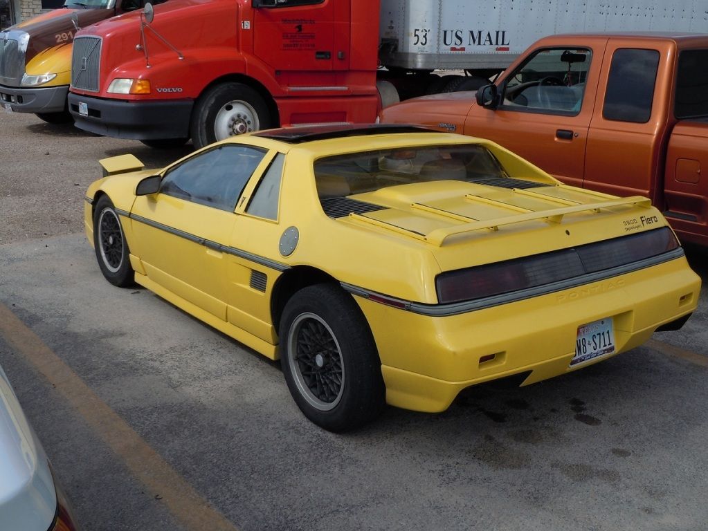

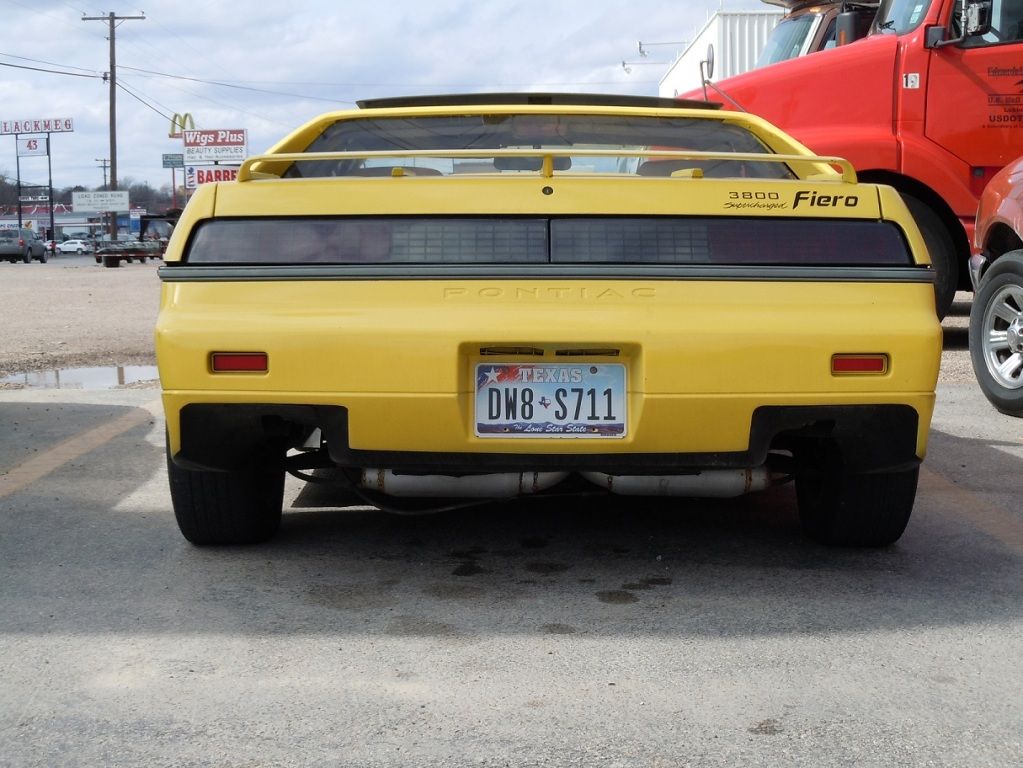

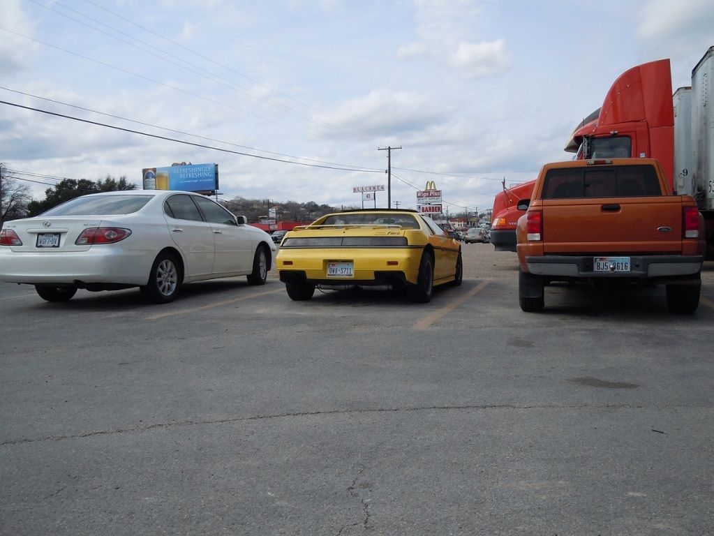

    88formula, as I said, next time I went home to Texas, I would get you pictures of a 3800 SC Fiero that belongs to a parts house guy. I just don't like the yellow, but it's still a cool ride.
    He said it has been chopped, not sure how many inches he said.
  17. #197 Re: Build Thread: The Fiero from Hell! Last update 2/14/2013
    Oct 2012
    West Branch, MI
    341
    That my friend is an amazing looking fiero. I love the chop top! Too bad those kits are 1500 in parts and TONS of work. Also not a fan of the yellow, but it looks original, and correct me if I am wrong but that would be the rarest color for these cars. Probably less then 500 of those were made. Thanks for the post!

    Your Welcome, not sure if original paint. He bought it like this from a guy in Houston, TX. IMHO though your motor blows this one away. It's just cool that I know someone in my hometown with a SC'd Fiero.

    Yellow Fiero wow never seen that and I actually like it.

    Finished the exhaust today. I have 12 hours into the full custom hand made exhaust but it was well worth it!
    Mock up
    Finished product
