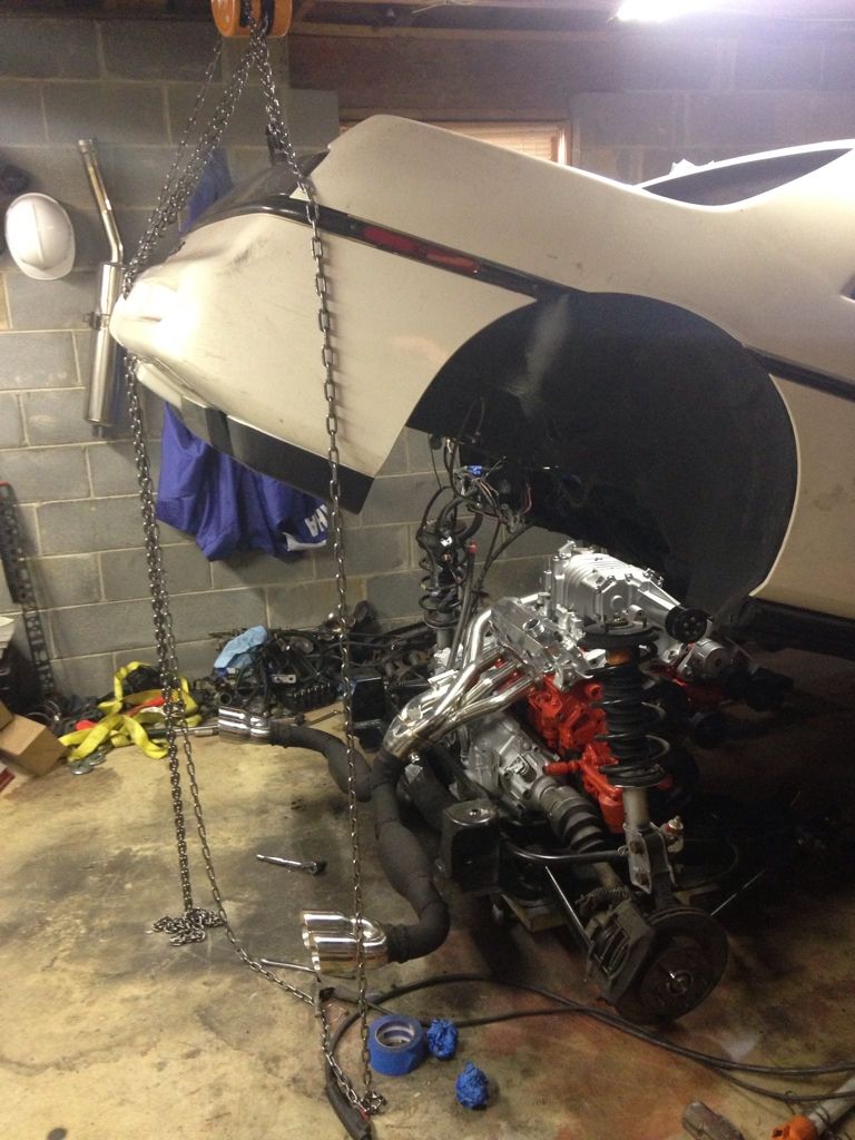

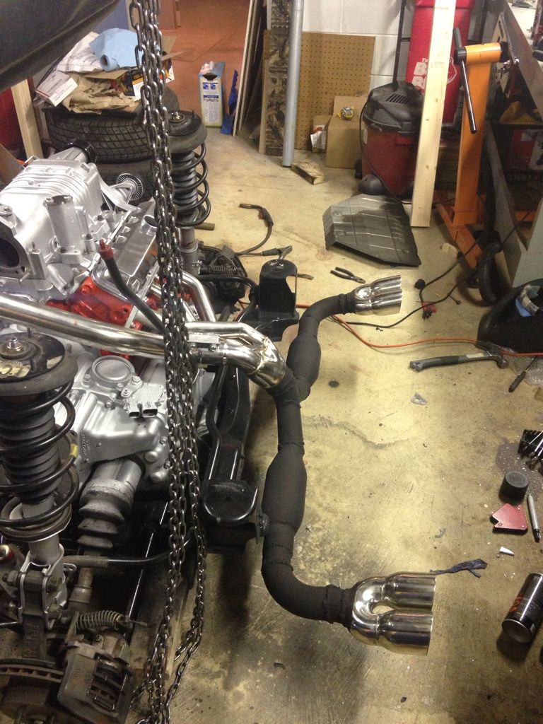

    So... silly me. I dropped my tank today, to install my 255lph fuel pump I had ordered from TREperformance.com, I had ordered a factory fit replacement for the Fiero, which is in tank. Well come today when I dropped the tank I realized that the previous owner had gotten rid of the in tank fuel pump, and hot wired a inline fuel pump "E2000" which is for late 80's ford V8's I guess back when he did the swap it was the common pump of choice, but I know from looking at the specs that this fuel pump will not support my needs, so I just ordered a Walbro 255lph Universal inline pump model GSL392. It should be here Thursday or Friday, so that will slow me down some.. On another note I now have like 8 gallons of old gas to put in my DD, and here is some more pictures from today!
    Here is a good view of the exhaust
    Tank dropped

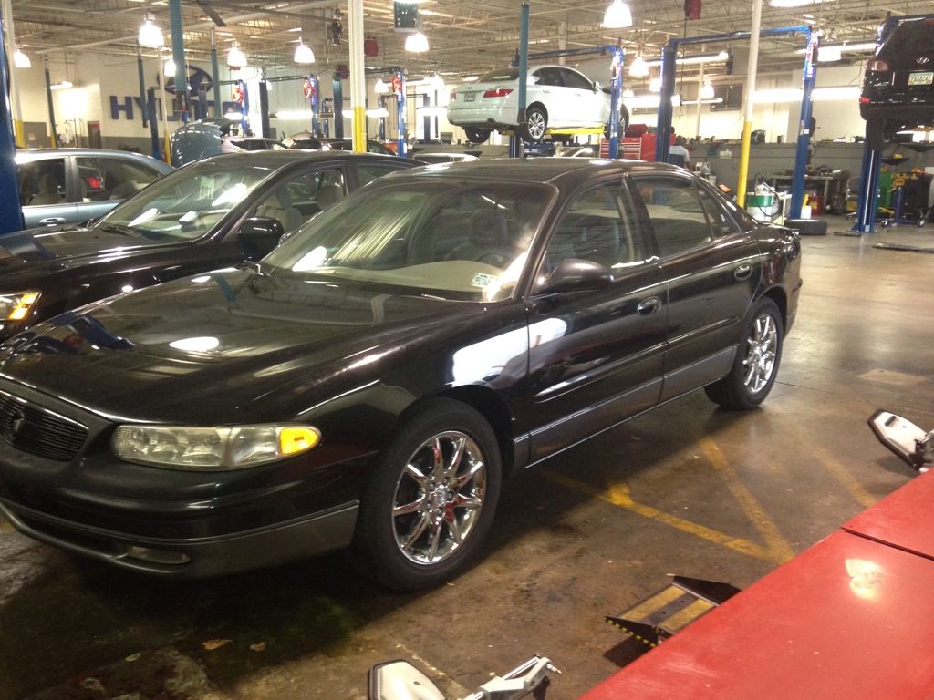

    Sadly I will be taking a break from the Fiero for a while... but it is for a good cause, today I picked up a black 1997 Buick Regal GS, and will be spending my spare funds on getting it set up how I want it for my DD. I am thinking intake, running dual cat-back exhaust, lowering springs, and a window tint job. Then back to the project car!

    i got one of them, enjoy it. they are as good as a GP if not better. if the seats are in poor shape, look for some 01 and up seats, the back seat has a 60/40 split and fold flat.
    and dual cat back wont happen, you would want the same cat back for a GP, and its just got a Y pipe to the mufflers.
    and f body brakes make for a nice upgrade when your due for new brakes.

    I have F body brakes in a box that came with the car, how hard is it to put them on? The seats are all in great condition besides one small tear on the drivers seat. Honestly I prefer the cloth seats in my Century, much more comfortable! Especially the headrest! If they werent in such bad condition I would put them in the Regal. Why do you say dual catback wont happen? I will probably make my own exhaust for the car. I was thinking replacing the resonator with a long glasspack like 3 feet long, then running it back to an ideal location, then a Y to dual tips. No mufflers. I just want to make some noise, not stupid loud, but obviously not stock. Same idea with a intake, just want to hear the blower more. I will probably pull it off the motor sometime and make a block off plate for it like I did to the one in the Fiero.
  20. #220 Re: Build Thread: The Fiero from Hell! Last update 2/21/2013
    if you can change your brakes you can do it. its easy. you look to be able to handle it, its easy compared to building a engine up.
    its a tight squeeze to get another pipe to fit down the tunnel. there are pics out there of headers someone fabbed up, true dual exhaust.
    and i rode for a day with no muffler and just a res till i picked up the new one, its not like real loud, but it got old real fast. i was done after a day. but then again, im not a kid any more, you may like it. so i wont judge you lol
