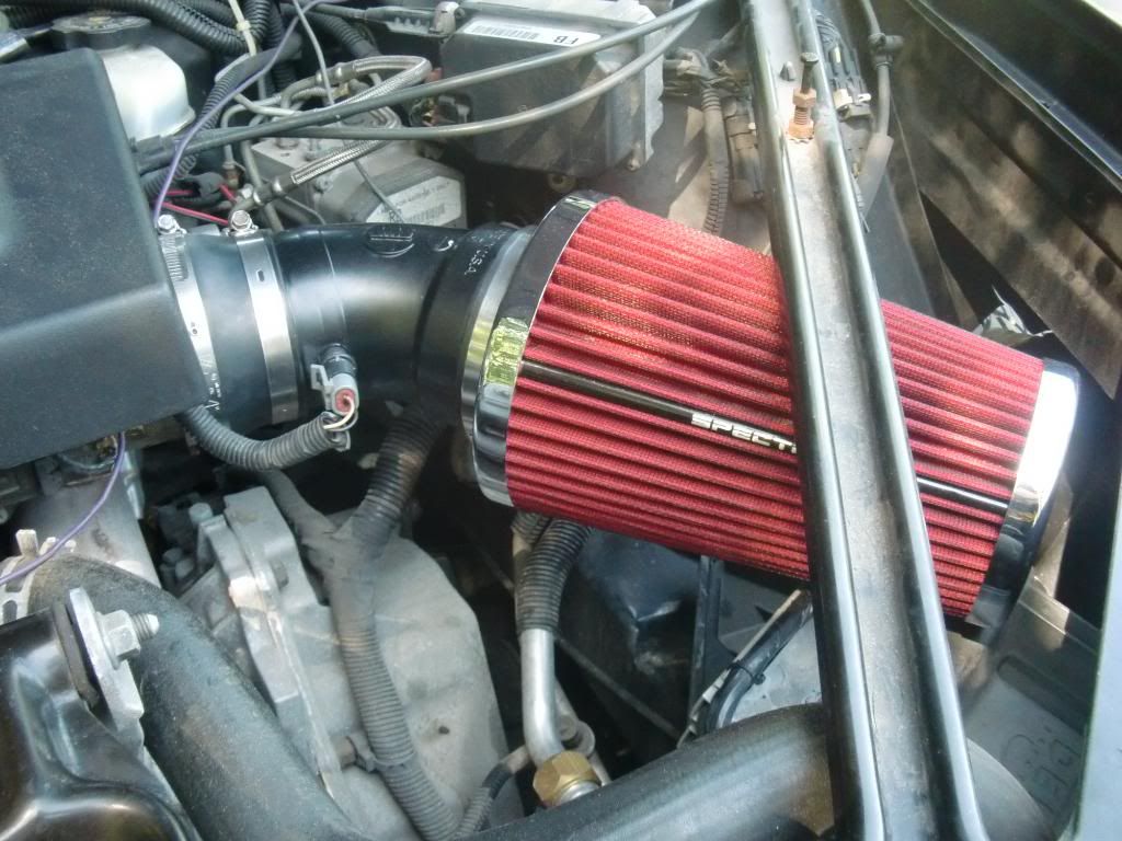

    As so many members have, a mandrel bent 4" 16-gauge 45 degree aluminum elbow. 9" K&N, and a 3.5" to 4" coupler. Haven't gotten the IAT sensor all sexily installed yet because I had to finish up the process early.
  12. #12 Re: Simple Intake (pictures)
    Looks like a decent spot for the IAT for me.
  13. #13 Re: Simple Intake (pictures)
    drill a hole in the silicone piece.
    no grommet needed.
  14. #14 Re: Simple Intake (pictures)
