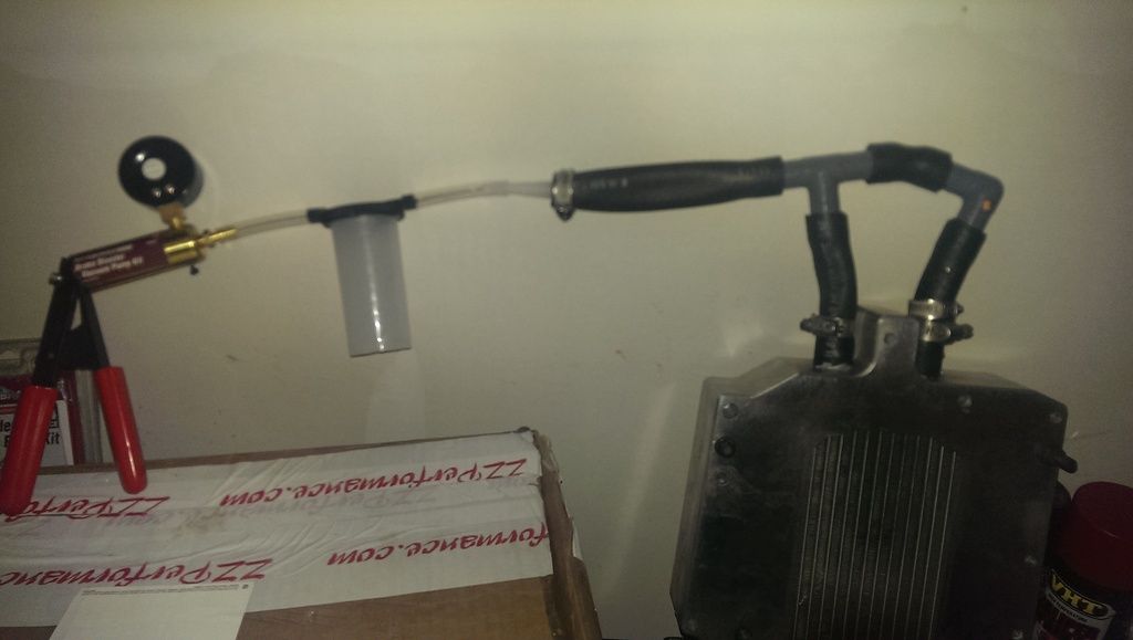

    So that connection goes inside the housing? Maybe that's where the leak is. That would explain how it leaks only when installed.
    g2g on plane heading home.
    Jeff

    I tried it standing up like this, and laying down.

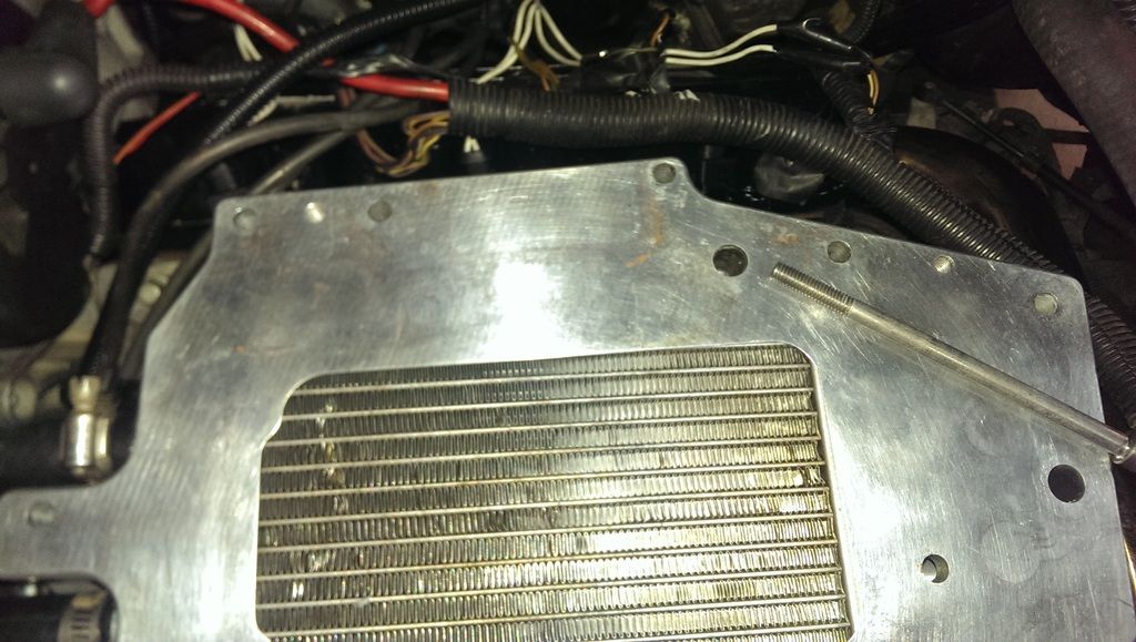

    Where the bolt is pointing is the only place i saw a drop of coolant. Which is a pcv passage.
    You can see here how the npt plugs are recessed in. I did a vacuum test and they both held up.
    02 Grand Prix GT Mods' Top Swapped Gen 3, Stage 2 IC, 3.0" MPS, 42# injectors, 1.8 Yella Terra roller rockers, Speed Daddy Headers, CAI, Self Tuned, 180 tstat, ram air hood, front/rear sway bars/and STB's AL 104's, 12' Dual Piston Break kit

    Man, I'm about as confused as a cow on AstroTurf. Now in your lower pic the PCV is the small hole that is half cut out closest to us in the pic (not the bypass) right? I've removed a bunch of M90's from GM cars but never really got into where everything is located. With that said then you would have to have a LiM leak near that port, but since it doesn't do it without the IC I don't get it, and can't make heads or tails of it.
    I've seen a missing PCV valve cause so much vacuum in the engine that it caused the crank seal to suck in and squeal on the crank journal. Opening the oil cap relieved the vacuum and placing a the PCV back in solved the problem. That was an NA series2 engine that had the UIM (composite) replaced after a backfire and the mechanic didn't put in a PCV. That's the only other thing I would think of that may be relevant.

    Circled is the only pcv passage that is used in my setup. I have a front valve cover breather. Yeah at this point im really at a loss as well.

    That looks like a threaded bolt hole, what is the hole next to the red circle?

    That threaded hoke is for a fuel rail stud, the pcv is the bigger hole next to it.

    Ok, that's what I was thinking. Is there and coolant there?

    OP. These are the pcv holes..make sure your rear is not blocked by rtv, and make sure you put rtv around the front one even though it's blocked off by the ic, you can still get a Vac leak from it. Doesn't fix your coolant issue but possible vac leak, pcv issue...and you should ditch the breather cap imo and do it correctly so it can be tuned better. If you feel heavy sucking on the oil cap while engine running you have a pcv issue that can cause problems with gaskets as stated...hope you get it figured out.
