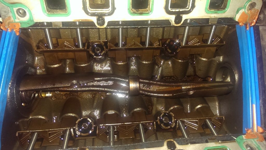

    Yup, found coolant under the LIM, the gaskets look fine but i will replace them. Wondering if the lim was not seated right and managed to leak coolant. Not sure if you can tell from this but do you think that is what happened?
    02 Grand Prix GT Mods' Top Swapped Gen 3, Stage 2 IC, 3.0" MPS, 42# injectors, 1.8 Yella Terra roller rockers, Speed Daddy Headers, CAI, Self Tuned, 180 tstat, ram air hood, front/rear sway bars/and STB's AL 104's, 12' Dual Piston Break kit

    Do you have one of those vacuum pumps that are used for bleeding brakes and such?
    I would use pieces of plastic like plexiglass and put vaseline around the water jackets on the intake surfaces, plug the rest with plugs and pull a vacuum on the water jacket, maybe there is a crack or defective porting.
    Jeff

    Put some oil down the lifter valley to help flush the coolant in the oil pan, then when everything is put back together, give the car an oil change before start up. I'd do the cheapest oil you can buy since it will most likely be drained shortly after, again.
    Coolant in the engine, is no beuno.

    Update for anyone curious. Took the new LIM back off. Ported my old one a bit and put it back on with new gaskets. Left the IC off for now as i messed up all of the allen key heads on them(my fault). Put the sc back on. Changed my oil, i saw only a very small amount of coolant in the oil(in the form of a few white bubbles). Took the car out for a test drive and its running like a champ! I saw no white smoke coming from my exhaust. Lets hope the coolant leak caused no damage, time will tell. Going to order more bolts and put the ic back on at a later date.
    Again thanks for all the help you guys provided me, it was greatly appreciated.

    Did you check if your LIM is warped? Sounds like it might have been. Glad you back in good shape!
