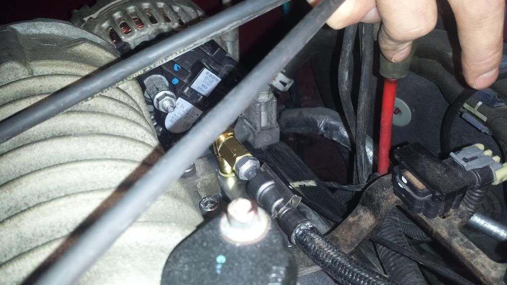

    You shouldn't need to use teflon tape on them, but they shouldn't be leaking. I'd take the braided line off, clean all the fittings really well, wrap the male fittings with a little teflon tape, and reinstall. Mine I go until they are snug, then just a little bump, never once had a leak.
    Those IC lines aren't being pinched ontop of the coil pack are they? First spin I took after my IC install, I hadn't purged all the air out of the IC so it was basically useless. Saw 13* of knock on part throttle. Purged all the air, now I'm seeing 0.

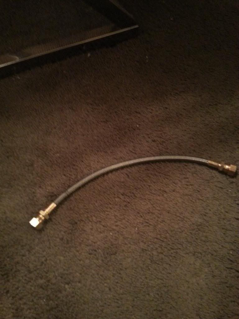

    This is another line do I need to use this one?

    Mine were leaking because I had to add some barb fittings..i tried pipe sealant n it didn't work. Then I used red loctite, cuz that's what zzp originally used and that worked well. Make sure you let it dry and cure tho. Haven't had a problem since. Was gonna try the tape next if the loctite didn't work.

    Quote Originally Posted by GrandPrix06GT View Post
    So loctite on the fittings? Or on top of them? I'll try teflon tape but i'll start with loctite
    Sent from my SAMSUNG-SGH-I747 using Tapatalk
  5. #25 Re: Modded fuel rails leaking and engine knocking when mashing the gas
    Feb 2013
    Detroit, MI
    2,800
    Well mine were for fuel logs and leaking right out of the logs, the ss lines were leaking at first and I just tightened them without anything n that stopped the leaking. Then I used loctite for this contraption.
    Thanks i change my lines along with the using loctite and teflon tape if they continue to leak

    Update.. ended up using loctite thanks for the help guys
