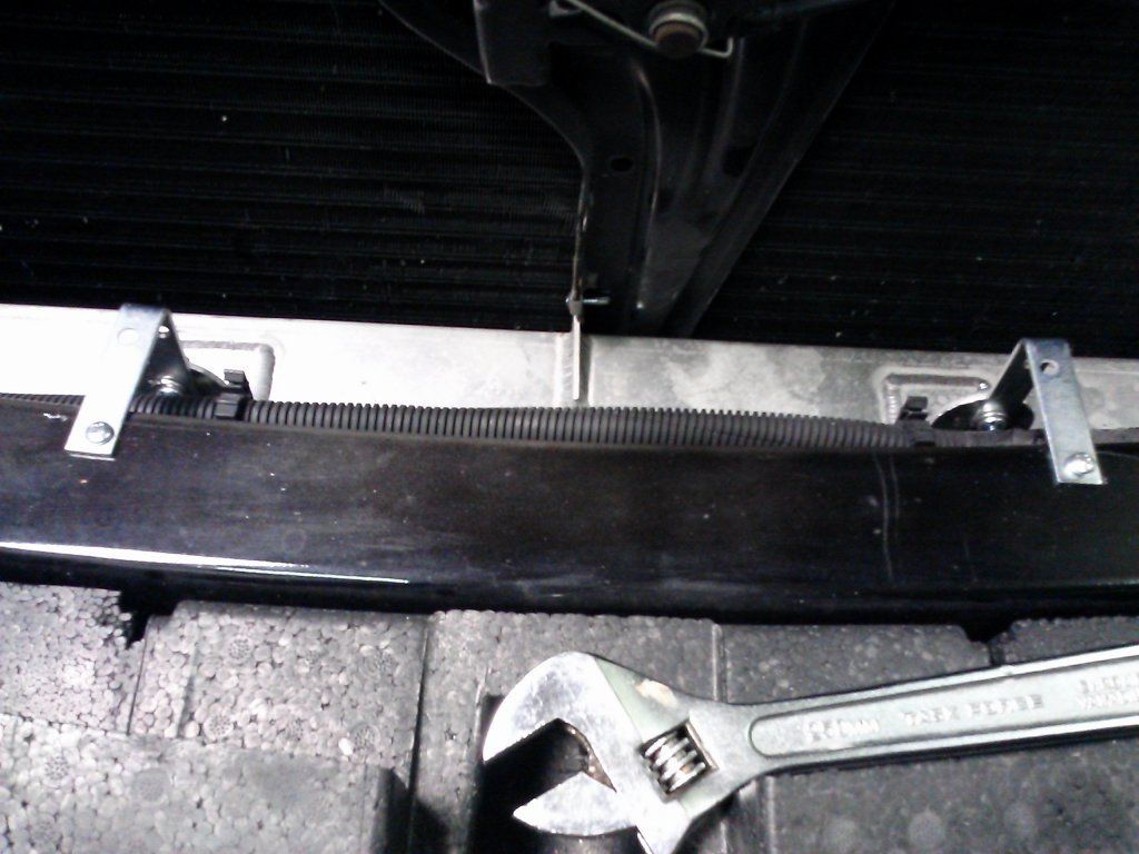

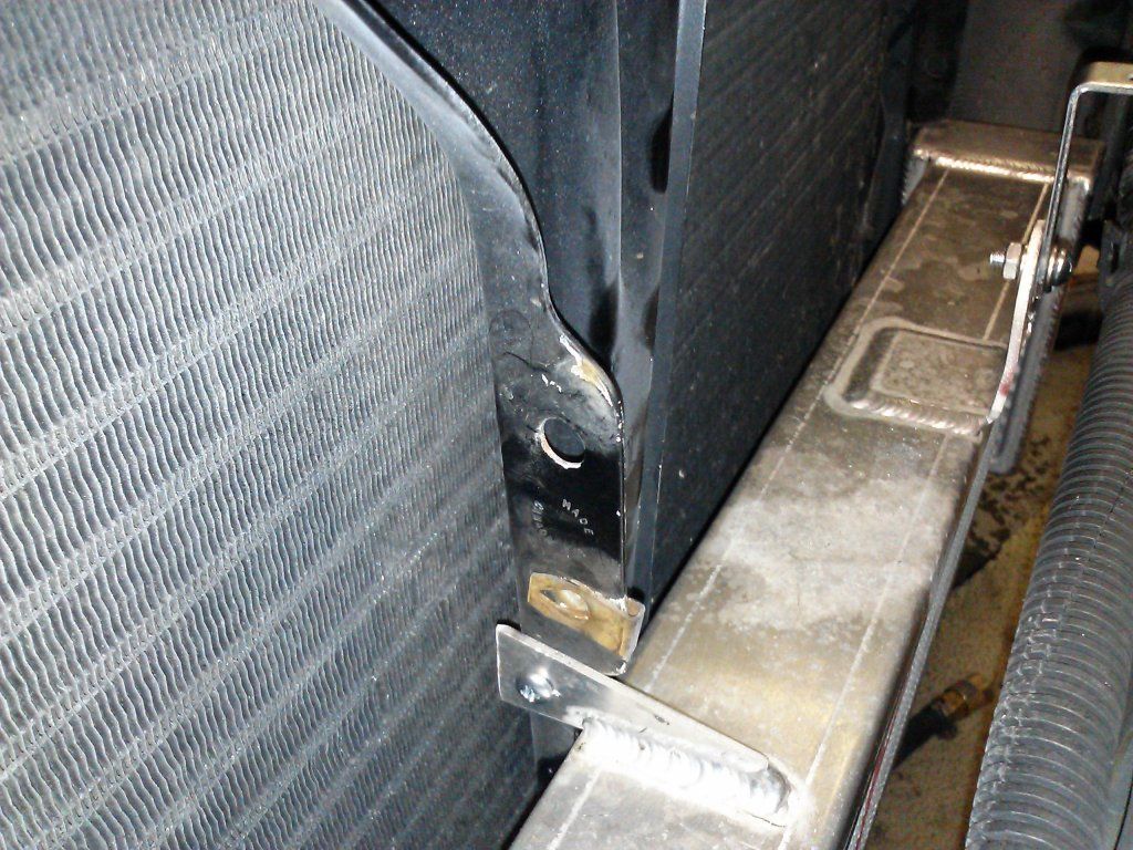

    you need one tube of rtv, fuel rails of some sort, a res tank is nice, but not needed. i used 3/4 hose only.
    no idea id a gp has the room to mount like this, but i welded two bolts to the rad support and nutted it on. made two holes and mounted in and outlets for the hose's.
    used marine epoxy to seal them up, bone dry since day one.
    you also nee to raise the icm and coils, or grind the bracket, drill new holes and move the icm over some to clear the belt.
    how to for that mod http://www.grandprixforums.net/threa...-BillBoost-way
    i got a frozen boost 101 fmhe, this mounting bar came with it, i got it used, the ends are capped and threaded, you drill a hole on the side of the rad support and bolt it in, the lower two tabs get bolted to the lower rad support.
    the you need to mod the hood latch, this how to install a ic thread covers it http://www.grandprixforums.net/threa...BS-Intercooler
    you need to cut the bottom off, then i welded it to the support bar.
    my 20 dollar modded fuel rail made from a stock rail and 20 bucks worth of tubing and compression fittings.
    and all done
    getting your fmhe up high keeps the curbs from killing it too.

    If you don't have that fancy bar like Scotty has to mount it on you can do it this way. I took a torch and bent the tabs up and got some L brackets from the hardware store.

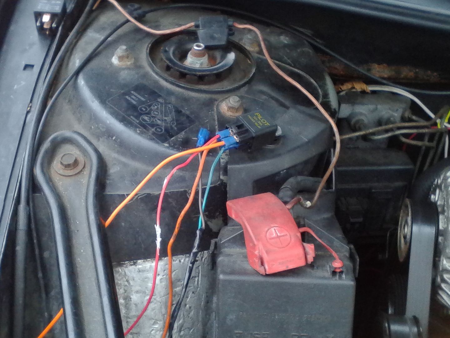

    Get one of these to tap into the fuse block for pump power:

    best to run a relay for the ic pump. thi sis mine in the rigged testing stages. its been soldered loom and mounted next to the fuse box now.

    You should get that pigtail with the pump. I just connected the black to ground. Use a ring terminal and screw it to the frame. Use the add-a-fuse to tap into the fuel block. I think you will need a small piece wire and two splices to cover the length needed. Find a fuse that is hot only when the ignition is on. You will need to cut a slot in the fuse block cover for the wire to slip into.

    The amperage draw of the IC pump is small and IMO doesn't need a relay. I have using the add-a-fuse with a 10 amp fuse for 4 years now. Never an issue.

    cant hurt, keeps it from sucking volts off the battery.
