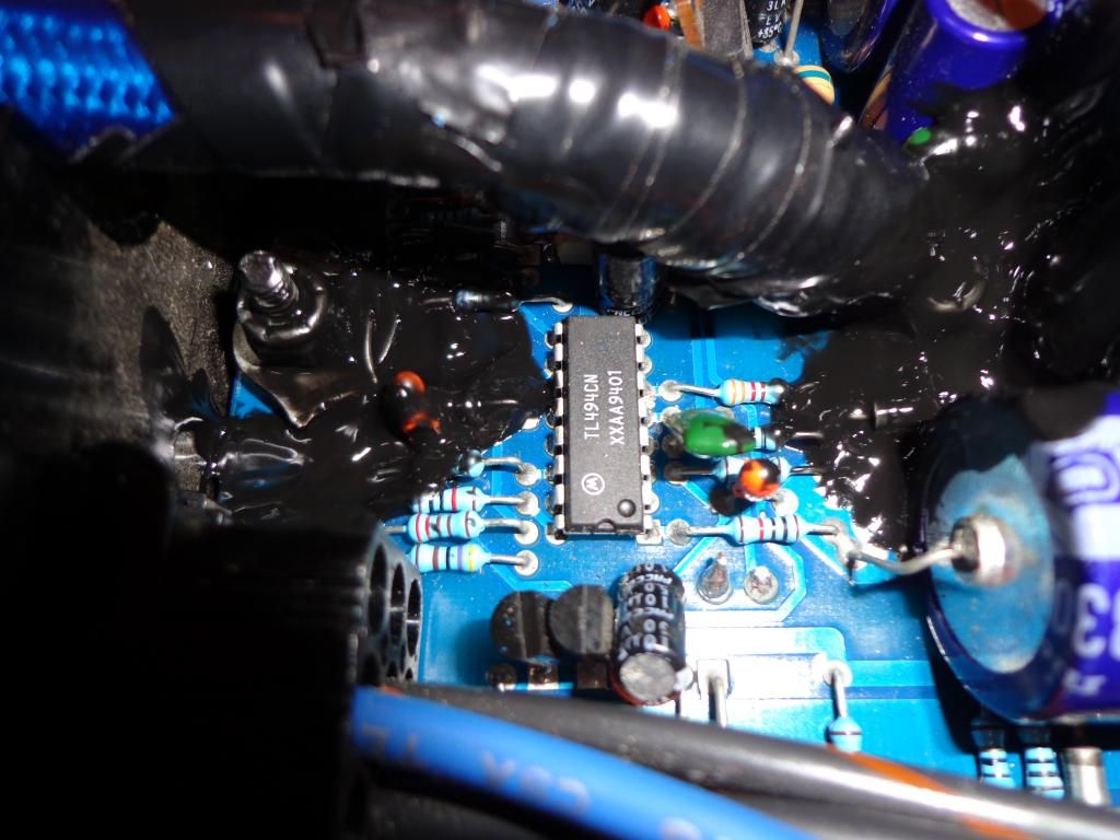

The Memphis amp is sitting on a shelf for now, until my dad comes down for a visit later this month. I did pull my sub amp to upgrade the power wires. This amp is crazy, the wires just bolt down to the circuit board. It's a 700+wrms amp and it only had 8 AWG wires, so I stepped it up to 4 AWG crimped and soldered connections. I also scraped away the top layer of the coating to give the wire more contact surface (I should have gotten a pic of this). Once installed, I covered everything in liquid electrical tape, to be safe. I'm letting that set up and dry over night, then I'll reinstall the amp tomorrow. Here's some pics...
This liquid tape is like a thick paint on plastidip, it'll peel off if I ever need to:
http://i14.photobucket.com/albums/a3...ps014e0693.jpg
http://i14.photobucket.com/albums/a3...ps98edb888.jpg
Comparison to the original power wire, I also had to wrap the ground wire in electrical tape because I didn't have any black wire, lol. I used the blue wire for positive because the main run of wire for this amp's positive is blue:
http://i14.photobucket.com/albums/a3...ps99841876.jpg
http://i14.photobucket.com/albums/a3...ps9a684211.jpg

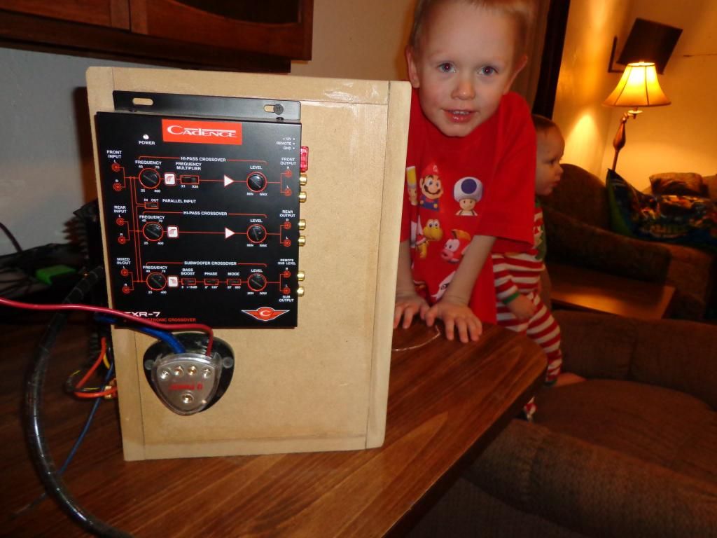

Finally some warm enough weather to put Peal N Seal in the trunk, so I did. Didn't get to spend as much time as I would have liked on the car today so I didn't get much done. I did the 95% of the Peal N Seal in, the rest will wait til I know exactly where the amp grounds will be. I also was able to sand the box down to fit, my belt sander made quick work of that, lol. I brought the box inside for the night to make a gasket for the Sub and put a bead of silicon on all the joints, then it'll all go back together tomorrow. I did get some pics though, I'll get more with the sub out and such. It dusk at 4:30PM here so the camera took a blueish picture...still trying to find a way to post smaller pics, but photobucket doesn't have any thumbnail links:
http://i14.photobucket.com/albums/a3...ps4b7030b3.jpg
Here's a pic of the box on the couch, lol:
http://i14.photobucket.com/albums/a3...ps99ae6cbc.jpg

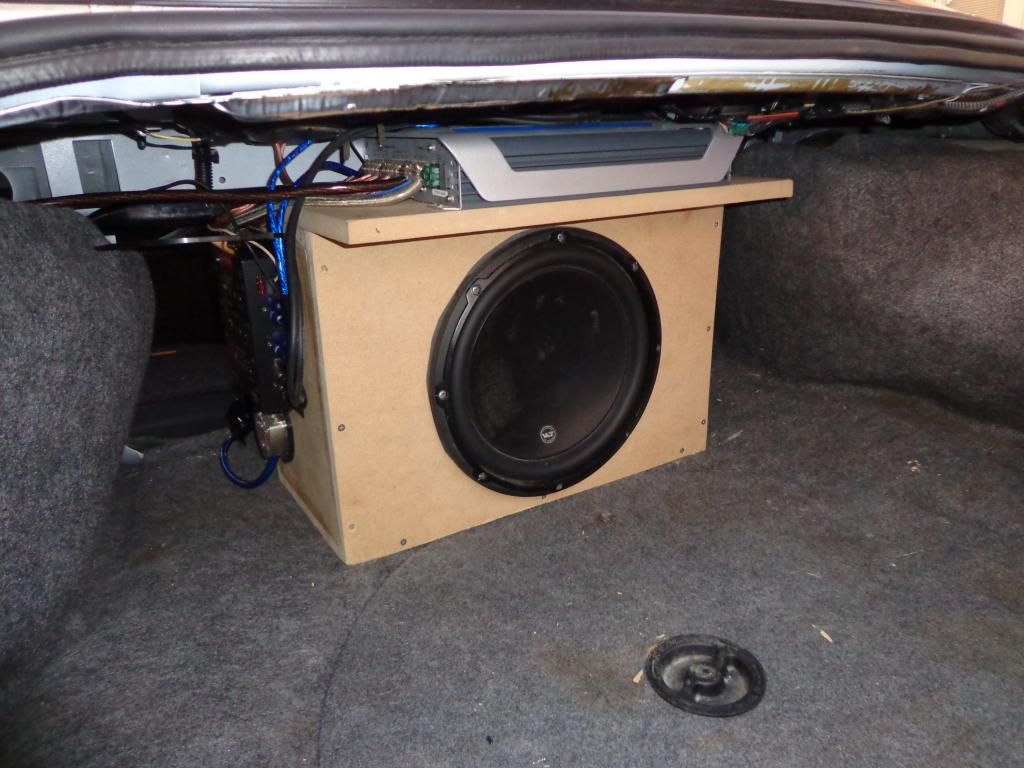

Pulled the sub back out, sanding more of the front and adding a gasket to seal it more. Snagged a few pics of the interior. My dad deals with pro audio and had some heavy duty speaker connectors laying around so I used one. They are really hefty, he says they're $35 each and I wouldn't be surprised. I just drilled 2 holes, ran the wire through then filled the holes back up with glue, so it's still sealed there, lol. Tomorrow I'll be screwing another piece of MDF down to the top that'll have the Infinity amp mounted to it, so nothing will be on the floor except the box. It'll slide 4 inches under the strut tower brace, and give me 18 inches on the side of the box to fold the back seat down.

All back together, and it's probably the most sealed box I've ever built, lol. I'm really looking forward to having my trunk back. Here's a pic and a video of it being sealed and all:

How many inches is that woofer? by the way, a great job.
It's a 12 inch 4 Ohm W3. Thanks, it all works in my head, so here's hoping it'll work in real life, lol.

It's basically done! Install didn't go exactly as planned, I didn't want it centered, I wanted it off to the passenger side, but oh well. Sounds great and everything is a very solid connection. The Infinity amp is grounded to the strut tower, sanded to bare metal, and the sub amp is grounded to the trunk floor where I drilled a hole, sanded, and used a STB U bolt thing, lol. Lights barely but noticeably dim under full tilt at idle, so oh well. Eventually I'll make a new floor for the trunk and everything will get new carpet then. For having 2 power wires, an external crossover, 4 channel amp, and sub amp, it's as pretty clean install, really:

if you keep the sub facing toward the trunk but push it all the way towards the trunk itll sound louder
You mean face it toward the back of the car, but move it closer to the back? I was trying to save trunk space by this, that'd kill it more. I thought about pointing it at the back seat, but I dunno. Everything is already mounted to the box to have it sit the way it is, so I might just leave it. who knows. I'll have to rip it all out to do the strut towers anyways...
mine faces the back seat and is pushed up as far to the seat back as it will go. i have no idea if its wrong or right, but with no grill on my box i didn't want it getting hit with all the crap in my trunk.
i prefer rear firing as i think it sounds better but there probably isnt much difference.
^^^Kinda the habit I picked up in my Civic. Probably doesn't make much difference, really.
