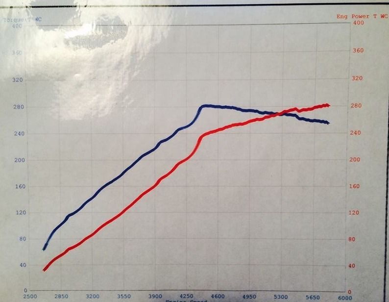

    I didn't read thru the whole thread but I have a dyno sheet from my run, are you still looking? It's from my Fiero with a L67 Gen V N* XP cam 140# springs, 3.1 pulley and a double roller chain on a Mustang dyno. I have a copy of the run I can post but he did let off early because he felt fuel pressure was dropping, since then I upgraded my pump but won't be back for another run till next week.

    post it up, that would be great.

    This was done on a Mustang dyno (the heartbreaker) not the final tune, as you can see it was still making power at 5750rpm when he shut it down. With the current setup it revs to about 6250 before shifts but he seen it slightly loosing fuel pressure, I since upgraded the fuel pump to the DW300 and need to go back for final adjustments.

    when you get that other dyno done, I would be interested in the results.
