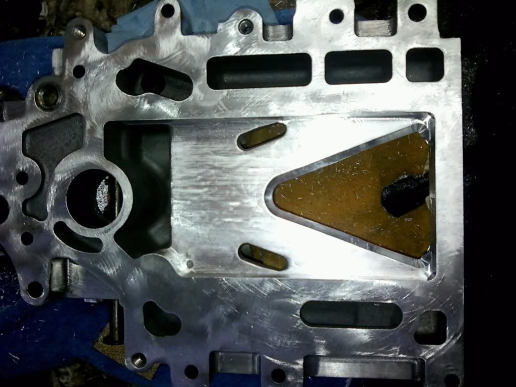

    I do them too. Here is my work:
    http://www.grandprixforums.net/f51/m...6hp-26928.html
    Gen V:

    Here are some pics of Gen 2, 3 and 5 -
    1997 Pontiac Grand Prix GTP
    1969 Pontiac GTO

    God no wonder the gen v is so much better look at the outlet on it.

    Works real good like this -
    that is NOT a stock outlet shape.

    Now that's bling bling. Yeah I just though about the gen v comment and it def looks alot more like the gen 3

    To me thats not the correct way to port. It has been proven you lose velocity of air with the larger porting and just the basic h bar removal and 45 degree outlet chamfer seems the to yield the best results.
    And that's mild compared to some of Stiegemeier's work. They guy is really big with the Ford crowd, but I don't understand his porting at all. Doesn't mean it doesn't work, it's just beyond me.

    They go for all out flow. Now for more power at the track thats fine. But when you are talking about VE and part throttle driving it will suffer because now you are decreasing velocity of the air. I dont think that we need to go that big of an outlet for the 3.8.
