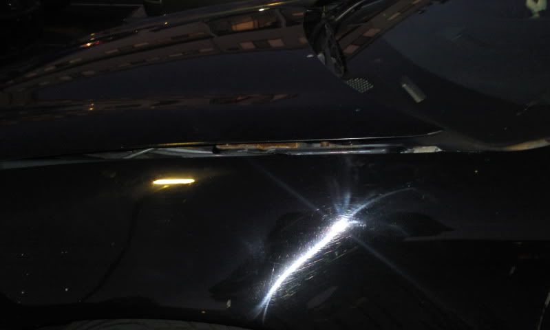

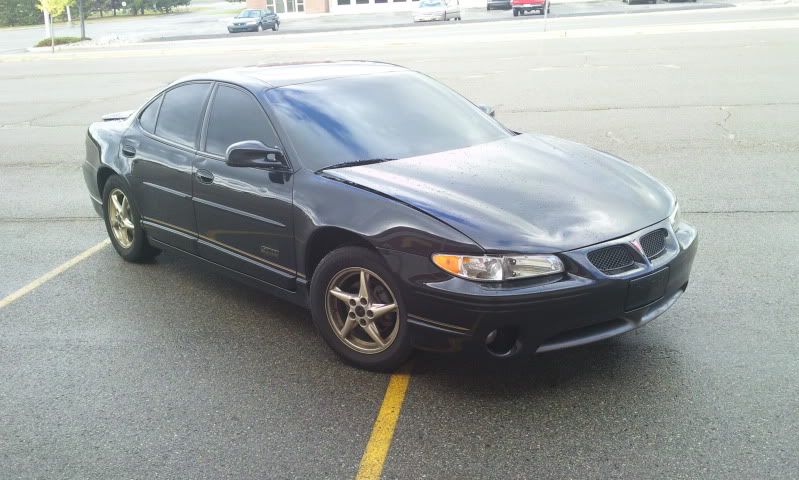

    i can't believe there's isn't a thread about this (that i could find). this is my first run modding a GTP, i'm a little new to this, all cars before have been (turbo) hondas. car is a '00 GTP sedan Gold Edition, as it stands has a thrasher intake, zzp downpipe, zzp PCM, 3.4 pulley, MSD plug wires, custom Alt. wiring including ZZP stage 1 booster, 1.9 rockers, yellow GM springs, front log manifold. so when i got the car ZZP told me my intake temps where a little hot, about 115 degrees. so my first order of business was to cool down the engine bay. first thing i did was order some gold heat wrap from Summit Racing (Design Engineering DEI 010393 - DEI Reflect-A-GOLD Heat Barriers - Overview - SummitRacing.com) and wrapped my thrasher air box. second thing i did was order a 6"x6"x.025" teflon (Amazon.com: Teflon PTFE Sheet, .125" Thick 6" x 6": Industrial & Scientific) and made myself a throttle body heat barrier gasket. (i know it's after the IAT sensor) installed that along with 2 rubber gaskets (zzp). my third and latest mod was hood spacers and removing the rubber seal at the back of the hood. i got the brass (non rustable) spacers at Lowe's, they are 1" spacers, a little extreme but i'm all about function>form, and it still looks better than all the ugly ass hoods for these cars with the gaudy scoops and vents. here are a couple pics of the spacers , wrapped air box, and thermal gasket.
    after going back to ZZP and having tim check the car again i had intake temps of 91 degrees on a high 80s day. not to bad if you ask me. soon i will be adding a fog light hole intake tube leading to the air box. updates later! give me some input!!!

    So your hood sits up an inch? You dont think that looks gawdy? Buy an intercooler. Your intake box would look like a gift box if you put a little red bow on top.

    I'd rather have an "ugly ass hood" with "gaudy scoops" that functions than having my hood sit an inch up and look like it's busted to the average every day person. just my 2 cents.

    hmm.. I've seen intake temps of 130 on a 90F day. Maybe that would help me... better pic of hood?

    like i said, function>form. scoops look like ****, i'm not really into the whole nostril scoops, painted dash, neon lights, and ebay tail lights **** that most prix owners go for. IMO the lifted hood functions and looks a lot better then most hoods made for these cars.

    IMO grand prix's are not aggressive looking cars, they have very smooth flowing body lines, so IMO a hood with 2 scoops sticking out the front looks extremely gaudy. these cars just do not look right with scoops.

    I understand what you're saying, but I do believe the SD and the GTX hoods are quite attractive. The GTX hood has NO raise, the intakes are pretty subtle unless you're looking at the car straight on and actually paying attention. The SD hood isn't raised much, but enough to look different.
    You could also go for the Cowl hood. You'd get your function and still maintain a pretty stock looking appearance.
    All in all, it IS your car, and you should do what you want. I was just throwing out some suggestions.

    You should take some daytime shots of your car, I'd like to see how the hood looks from a different view.
