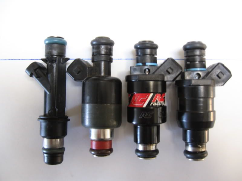

    I wouldn't mess with those injectors. I think you got hosed on them.
    Left to right:
    1) OEM # 25313185
    Blazer, Envoy, Bravada / 28 lb/hr
    2) Stock 1999 Alero V6 / 19 lb/hr
    3) RC Engineering SL2-370 / 35 lb/hr
    4) Lucas 42.5 / lb/hr
  12. #12 Re: Injector data question?!

    I honestly don't think that's what they are, there are several injectors made with that body and mine aren't red at the bottom. I've seen 42lb injectors on reputable sites with the same black and green body

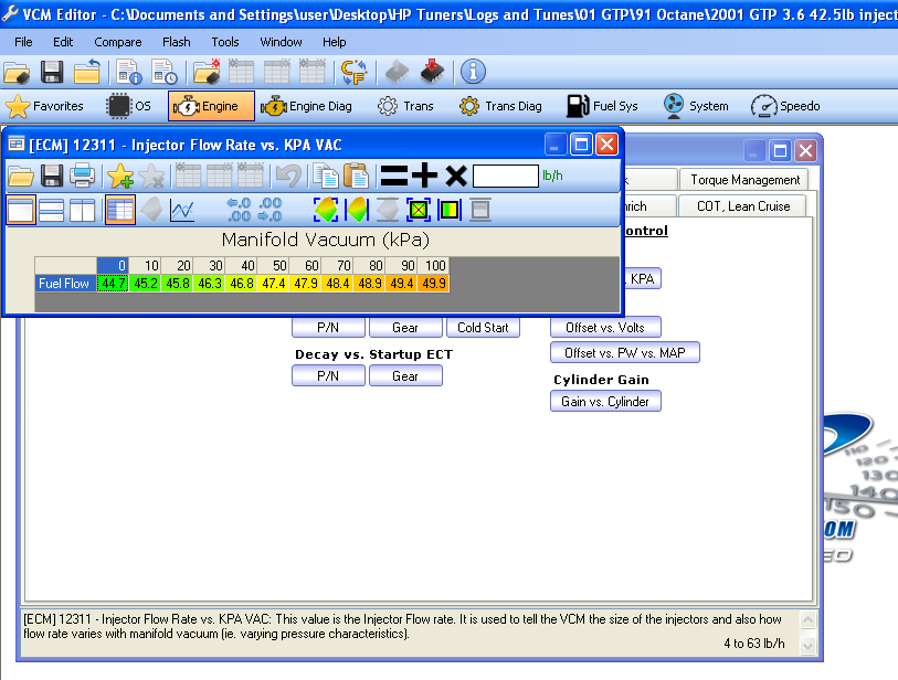

    They look like the Alero injectors that spade posted above.
    However, if they are 42.5 lucas injectors, this table should get you pretty close to correct if you enter these numbers as shown.

    Those are mult-tech injectors if I recall and they are probably off of a turbo Buick. The old school one AKA the LC2 3.8l sfi turbo. I have a set of those that are 42-pound hour

    A lot of people still sell these injectors. I've seen them on racetronixs web site. And the thing I noticed different about my injectors is that the colored ring at the bottom is black, on the Alero injectors they are red.
