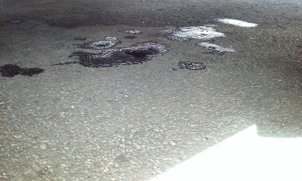

I didnt install the coilovers yet. I did install my racetronix 255 and rewire though. I also discovered a nasty looking oil leak under the passenger side. It appears to be a oil pan leak. Im losing a quart every couple days or so. Thats my fun chore for tomorrow.
oil pressure sensor leaks like that.
Ill take a look at the sensor as well. Thanks for the heads up.
unplug the neon green connector and look for oil to drip out of the terminals/sensor.
I finally decided to delete the TR's OE sensor after having a few more of them damned things fail around me.
too scary. 1/4" npt plug it.
though im willing to say ill be getting an adjustable hobbs switch at some point so it can be set at a couple psi below what hot idle is....instead of "its already ****ed" Oem sensor
mine was plugged off 5 years ago. 3 failures and you learn a lesson for sure.
now i got a o/p gauge hooked up to it.

plugging it is fine. the plug costs 50 cents, it dont fail lol
I was thinking that without signal from the oil pressure sensor, it wouldnt start. If that isnt true, what am i thinking of?
mines been dangling for 6 years lol fires right up.
all that "signal" does is feed the dash needle
I was thinking of my old car. When the oil pressure sensor went out, the car wouldnt start because it thought there was no oil pressure. Looks like ill either be using a tube of black rtv or a brass fitting tomorrow.

that hole is where your oil feed line comes from iirc.
This is what im working with currentlyhttp://i304.photobucket.com/albums/n...ps9wj2af6v.jpg
