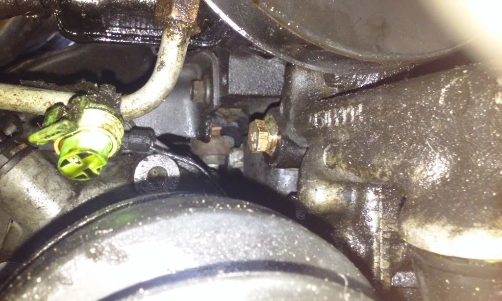

see the green plug over the axle there. start the car, see if oil leaks from the plug.
I really hope its the sensor. I dont want to drop the damn pan
at that oil leakage volume, its the sensor, rarely do I see a filter neck gasket leak unless someone puts rtv on it...then ive seen em split and leak

Good call guys. When I unplugged the sensor, oil dripped out.
