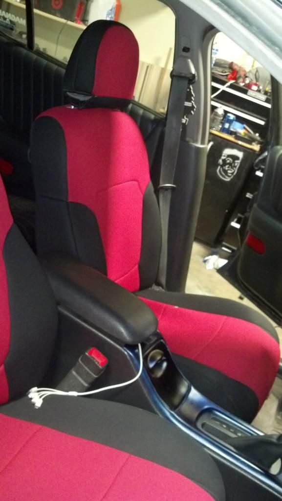

    Well, figured i'd let you guys take a look at some of the interior.
    I had the dumb cloth interior. the back seat had turned pink in some areas due to the sun which was fugly, the back door panels had tears and were cracked. I think i got lucky though cuz I got all for door panels and the back seat wrapped in the graphite "leather" for 75 bucks.
    that's a sub wire in the door jam. that was temp routing, ill be sending it through the firewall sometime this week.
    The front seats were worn though so i passed on them. I also don't like how the leather front seats feel so i went with what i see as a better solution.
    Coverking neoprene seat covers.
    they are actually a dark red. phone camera sucks.

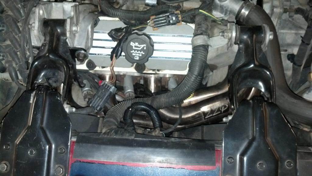

    Here's a few shots of the engine bay as it is.
    Cant wait to have the new top end all nice and shiny in there.
    Here are the headers. they've turned slightly bronze
    Here's what i like to call the double barrel strut bar. made it myself haha. its prolly the beefiest strut bar i've seen on any of our cars.

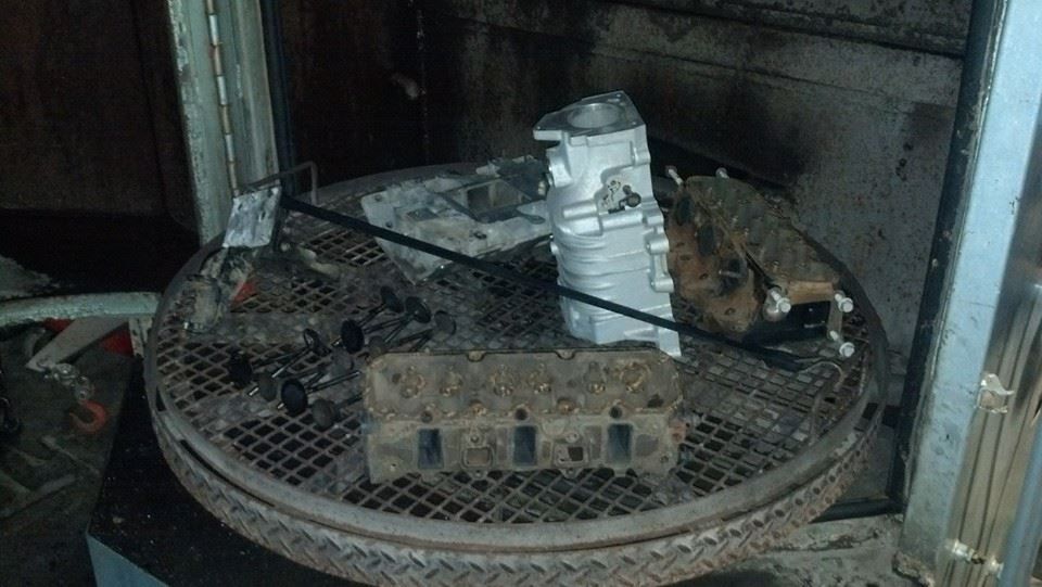

    oh heres a fun picture i took during the process of cleanin up the parts. I detail semi trucks at a shop/dealership. Nothing like being able to wash all of your parts at once! haha.

    You would think me working on an active duty post with plenty of motorpools all over and an autos shop I'd be able to find a damn parts washer like that.......... Nope I dont have one in my shop neither do the other 3 I checked or the autos shop! I have a set of heads I want to clean up and prep for a turbo car, but since I cant find a parts washer like that I might as well drop them off for magnaflux'd and checked out then they will get cleaned up anyways.
    That parts washed makes me jelly since ive been looking for one for about the last 2 weeks!

    If you wait to you're back in GF I can toss it in that one for ya! Haha. Magnufluxing is never a bad idea though
