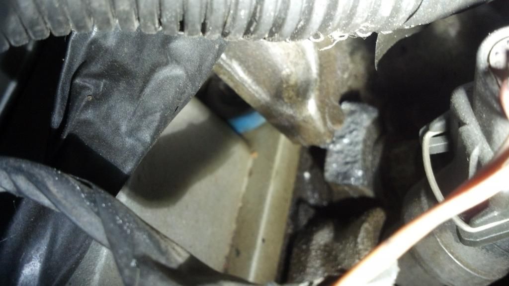

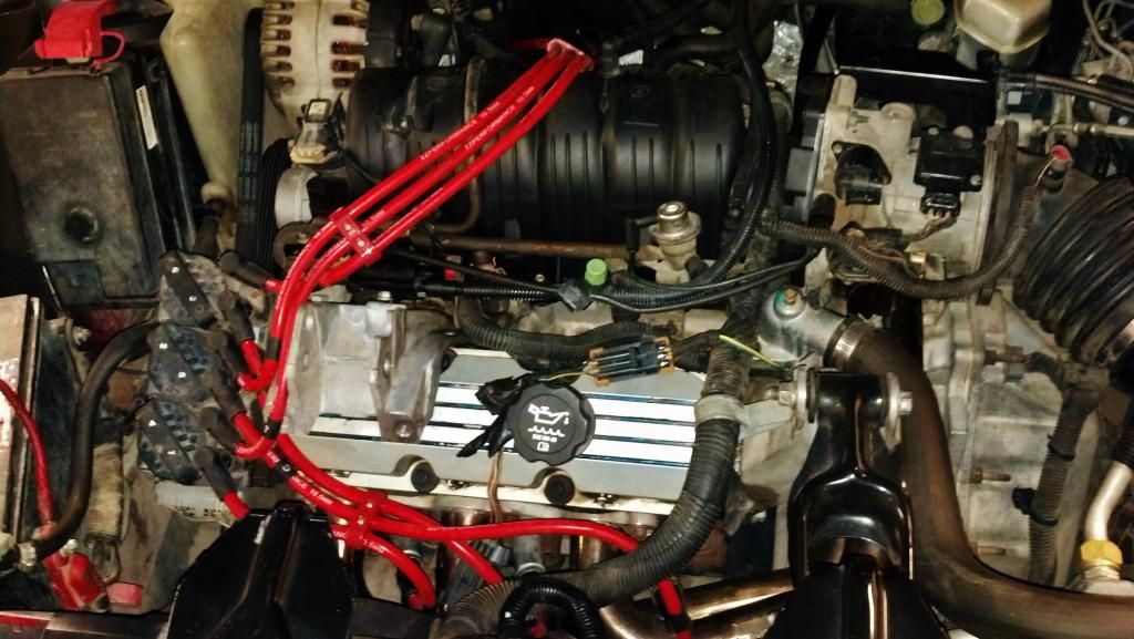

    So, i got a set of 10.5mm ZZP plug wires second hand from the FS section. I have heard some bad reviews of these wires but they didn't cost much more than an OE replacement so i figured id give them a shot. so far no issues and i've been running them for a few days now.
    Unfortunately there was a slight issue that i noticed while i was installing them. again sorry for crappy phone pictures.

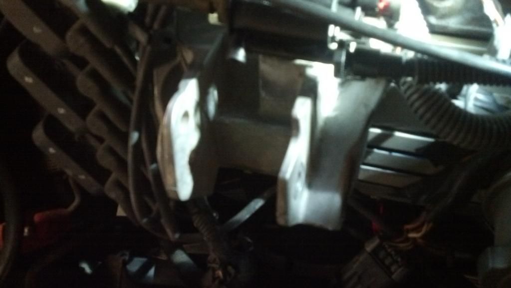

    The aluminum bracket on the drivers side of the motor that the dogbone bolts to was broken.
    here is the crack
    This crack renders it useless as the mount can move freely as it just rotates around the other bolt. I think this was cause due to the bolts being loose. sooo iits my own fault. this pic might show just how much it moves.. that gap lol
    I don't think i'm going to replace it though because it will be omit when i install the cast iron coil pack bracket for the top swap. ill just drive nice until then.
    It was bugging me that none of the pictures i've uploaded show the color of the parts very well, so i fixed the lighting in this one as best as i could.

    If anyone thinks ill damage anything by driving around W/O the right dogbone feel free to let me know. like i said ill drive nicely haha

    doubt it, I plan to delete mine one day and just have one mount from the trans to cradle

    Don't worry about that dog bone, there are turbo cars riding around without them.

    huh that't not a bad idea has anybody done it? i'd like to see how it might look!
    Cool, i have seen them missing in some of the signatures around the forum, i just assumed that they had solid mounts to make up for it or something. thanks!
