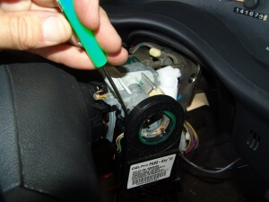

    let it stall see if its got fuel pressure in the rail. leave the key to run after it stalls when you test it.
    try swapping that ring bill talked about in the last page?
    this thing
    how to get to it. your not doing the whole harness, so follow from the column plastic part of the how to.

    thanks Scottydoggs ,but this is what I did change out! I can hear the fuel pump run for the 5-10 seconds whiles hte car is running, then sounds like the fuel pump cuts off (which is what the security is supposed to do right ? ) and like i stated in my earlier post ... I can straight wire the fuel pump and it'll run as long I want it to! So I don't think it's a fuel pump issue.
