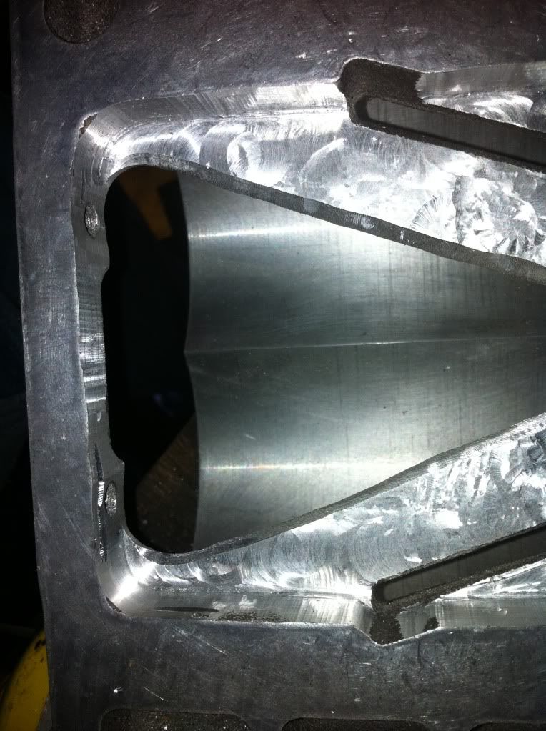

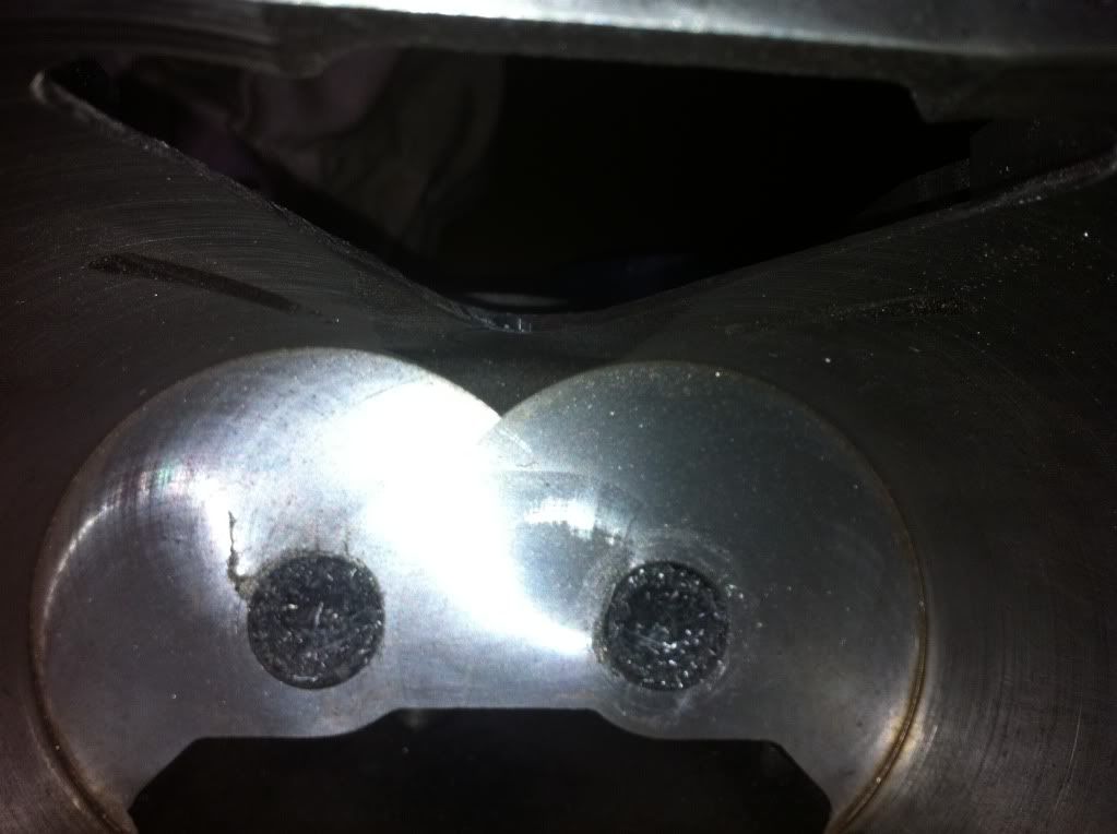

    You want the "V" EVENLY brought down to the "H" bar...bolts and squares removed at the top. I'm not sure if maybe your car just hated you but I'd like to see pictures of your blower that CAUSED KR...and the one that doesn't CAUSE KR.
  2. #22 Re: Porting Your Supercharger
    the problem with this port is that i'm fairly sure youre not supposed to make the outlet any bigger besides extending the V down and taking out those square notches. you dont want to open it up and lose the ability to gain boost. you just want to open it up a little bit, smooth it out, and help with the transition from the rotors to the lower intake.
  3. #23 Re: Porting Your Supercharger
    the one that doesnt looks like a ZZP, the one that does, doesnt match the original angle.
    I did what bio mentioned..

    I had a case to play around with a few days ago and decided to practice porting it... I used a router with regular wood bits and took out the big parts in many layers then smoothed the whole underside and opened up the V then got my 45* bit and beveled the edge. It turned out really well, almost looks like CNC but not quite as perfect.

    Did you check to see if the angle still matches the rotors?
    also, is that your needle bearings full of metal shavings? If so, you're probably going to want to replace those.
    It matches the angle of the rotors pretty well. This is just an extra gen 3 case, I have a complete L32 w/gen V in my car now and another gen V on the shelf so I'm not gonna be using this, I may work on the inlet next and pop those bearings out an sell it or I may just take it in for scrap.
    X2 on the needle bearings.
    Also...porting a GenV is worthless...bench dyno proven.
    I'm not gonna hog the gen V out like this one, I really just need to remove the H bar for my intercooler and I will probably smooth all the rough casting areas out. This was really only to get practice and mainly to see if it would even work... If anyone else wants to try it with a router I used all standard grade wood bits just at very low speed so they didn't heat up and burn

    Quote Originally Posted by Kejross View Post
    I gotcha.
    I believe polishing the inlet/smoothing the outlet like you mentioned would be the only thing to do...basically diminishing the imperfections from the factory, even though there are few to be had on that blower. Steigmeyer (or however you spell that), that ports the Cobra blowers...tried their funky outlet "rain drop" or tear shaped outlet...and it actually lost a decent amount of boost from it.

    So about this differing outlet shapes...
    This is what it looked like before:
    Heres what my blower outlet looks like now:
    I have less KR with this blower on, same rotors and snout as before though.
    No other changes were made.
    For the current shape all I did was continue the triangle up a tad bit and down to the bottom. Then a chamfer.
    Still matches the curvature of the rotor which seems to be the key to efficiency.
  16. #36 Re: Porting Your Supercharger
    Even after comparing...I still don't see much of any difference. I bet you had a vacuum leak and resealing it got rid of your KR
