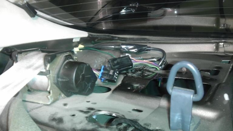

    Minor victory!! I disconnected this plug on the right side of the package shelf and the remaining lights timed out appropriately.
    Looks like the problem is isolated to the overhead wiring. Hopefully I can find what's wrong without pulling the headliner. That's tomorrows problem...

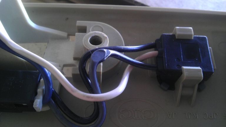

    Found it. Pinched wire at the rear passenger courtesy light. That little post was squishing the wire against the body. Peeled the insulation back, inspected and re-taped. Carefully re-installed, and all is well.
    Full disclosure: This was probably my fault. When I installed the LED's, I pulled the whole assembly out because I couldn't get at the old 194 bulb when it was all together. A mistake is only a mistake if you can't fix it, right?
