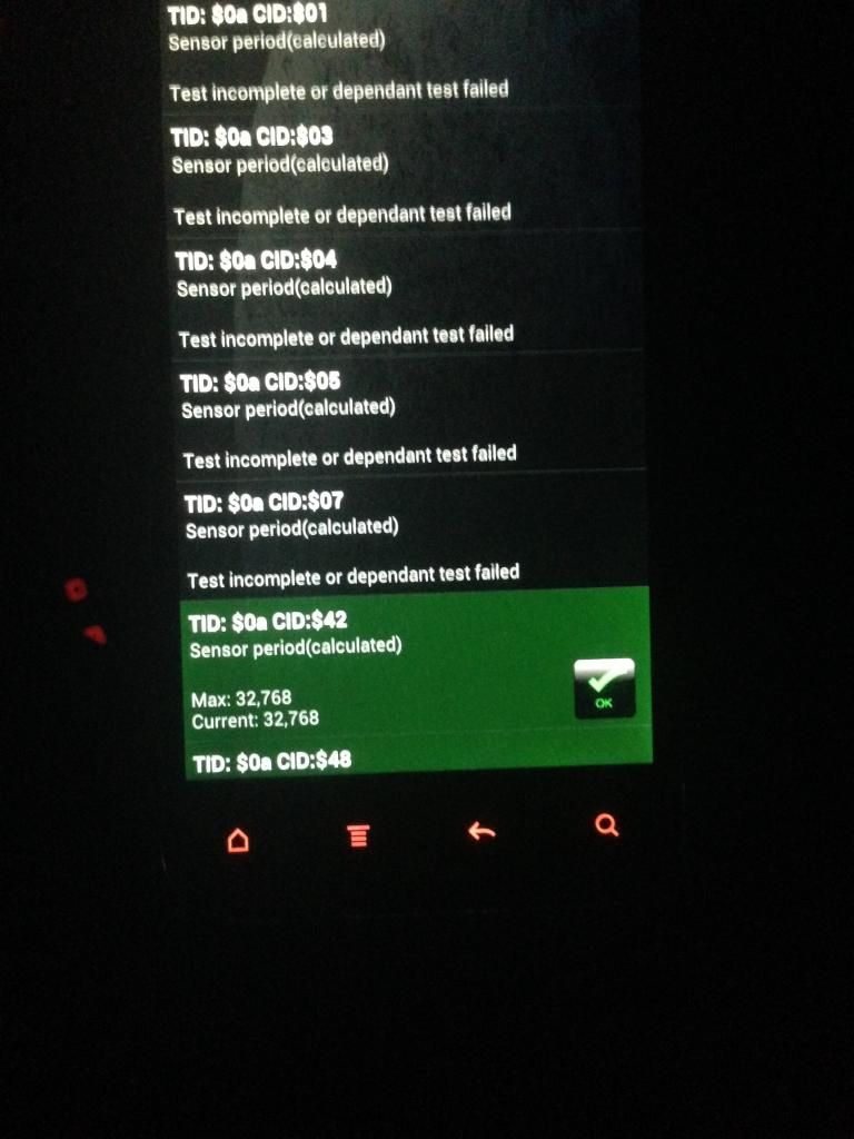

got a little update on this situation. Got a new sensor from a junkyard and soldered my wires. Then i decided to take the negative off the battery to reset the code. Turn the car on and after all of that and the darn light lights up instantlydrove the car around and still knocks around 3* at WOT. Also pounded out the firewall some more so that its not hitting for the kr. Also after i drove car around the block and turned it off again and turned it on a couple min later. it had a surging idle. Jumping between 300-1500 ish rpm. Havent had a vacuum leak when i left for school. MY dad said it has happened to him before.I didn't get a chance to spray carb cleaner or anything around to check but I dont think i have a leak. My questions are
1) Maybe a crossed wire when i made my extension caused this? I doubt i made a mistake like this but accidents happen.
2) Would using a different gauge wire mess with the sensor causing the code? The extension i made is a bigger wire. Does that mess with anything?
3) could the surging be because of this wire?
The car seems to run fine whenever i drive it and still pulls hard but still gets some knock. Gas mileage is down and sometimes i get a strong exhaust smell? Any thoughts? Any help is appreciated I am at school however so i cannot change make changes. oh and my dad does plan on getting an acdelco from rock auto in the near future.
Thanks,
Chris
and i believe the code is p1133 if i remember correctly
