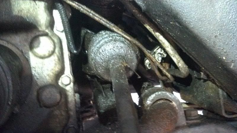

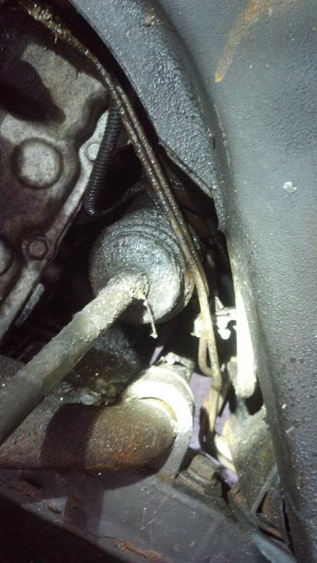

    I think I found the problem. There is something rubbing against the aluminum vacuum/brake lines down near the rack and pinion. it pops them back and forth and since it is right in front of the driver seat it is very loud in the car. When the car is jacked up on the front end it is not as loud, probably because the tie rods are sitting a bit lower with the wheel fully extended. I will do more research and post again.

    Okay so I got a few pictures of the problem. I ended up bending the vacuum/brake lines up a bit to be out of the way of the tie rod's boot. here are some pictures of before, when it was rubbing on the according and making a popping/clunking noise, maybe this will help someone down the road:

    None of the lines are in the bracket. Can you get them back i there? Also it kinda looks like they are dangerously close to the transmission
    Sent from my SCH-R970 using Tapatalk

    That's what I tried to do for a good 30 minutes then I realized they had been replaced about halfway down from the top of the engine and whoever replaced them didn't give it enough slack so they won't fit into the clips.
