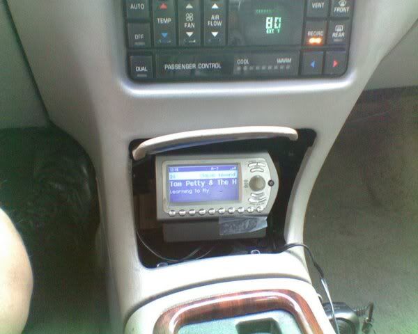

    i need to re wire mine power socket in the cubby to be off when the cars off. i jammed my xm unit in there and i use the outside power socket to power it so i can unplug it when the cars off. that cubby is kinda useless in my book.

    why would i need a relay? ive ran powers sockets right off the battery with a in line fuse, its straight 12 volts.
    my plan was to run a wire with a add a fuse from the fuse box, to the socket, leave the factory ground on it. plug XM into it and drop in in the console. done deal. no more wires hanging out. and it turns off with the car.
