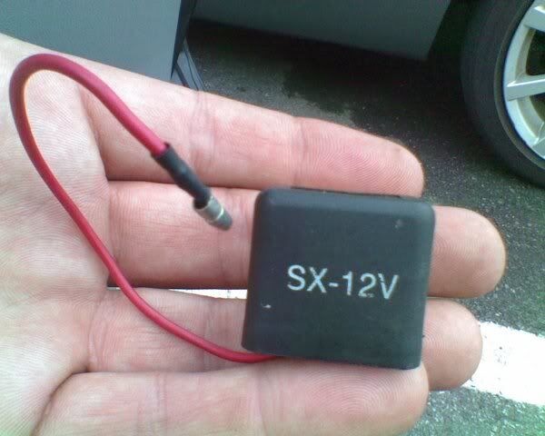

    ok little update i guess, i got to removing the driver side actuator, and was able to turn the shaft and make the d/s go from hot to cold, but the pass side is on its own actuator. so i get that one off, and the shaft is really hard to turn i had to use pliers to turn it.
    i worked the temp buttons and the actuator was turning, but as hard as the shaft was to turn i bet it just couldent get the job done.
    any one ever see this before?
    oh and i found this under my glove box, have no idea what it is....
