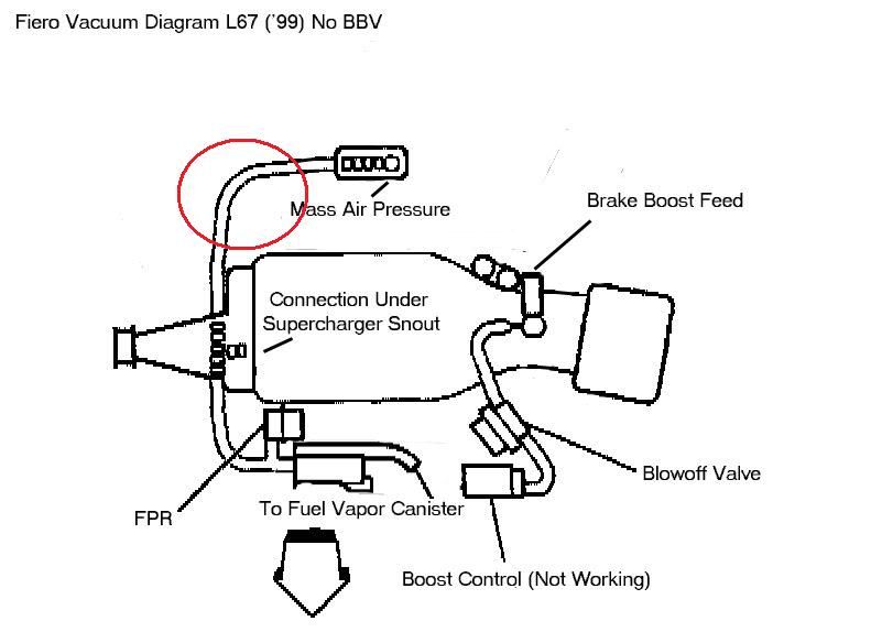

    Alrighty...Mighty google might just help....heres a ghetto diagram...
    You tap between where it says "Mass Air Pressure" and Connection Under Supercharger Snout"...hop that helps.

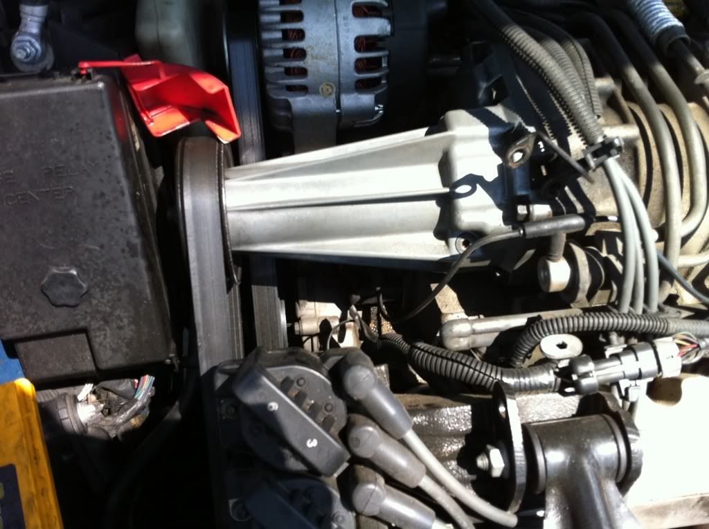

    Is this a good pic?

    Thanks squid! I have a better idea now.
  12. #12 Re: Quick boost gauge question
    Florida
    3,759
    Yeah...See the T ontop of the fuel rail? Follow that down and you'll feel another T. Follow that line, and it leads to the MAP...that's where you tap.
    If it is a hard line (IE plastic stuff) You'll need to get a vacuum line to replace that, so you can actually tap the new T into it. hope that makes sense...

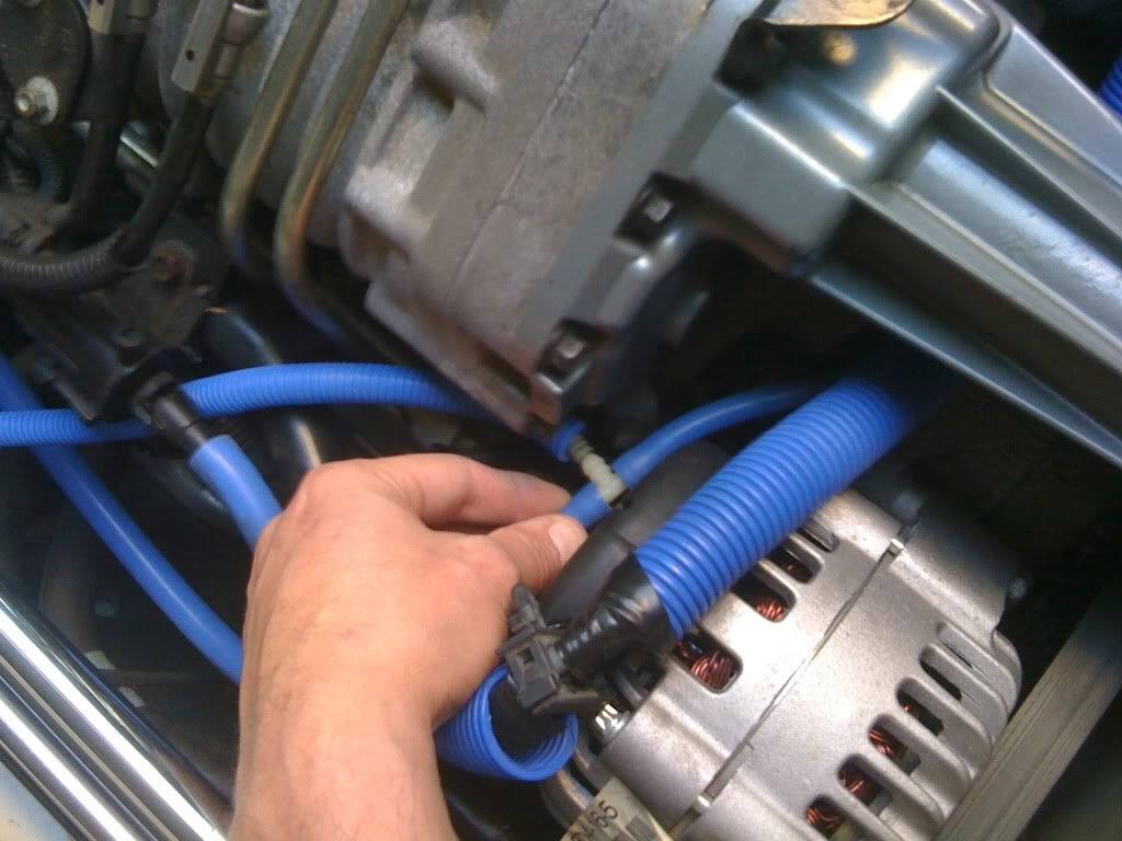

    Yeah right about here.
    And this is where I got my vac lines
    Silicone Vacuum Hose Kit 98 Pontiac Grand Prix GTP Parts - DragTimes.com
  15. #15 Re: Quick boost gauge question
