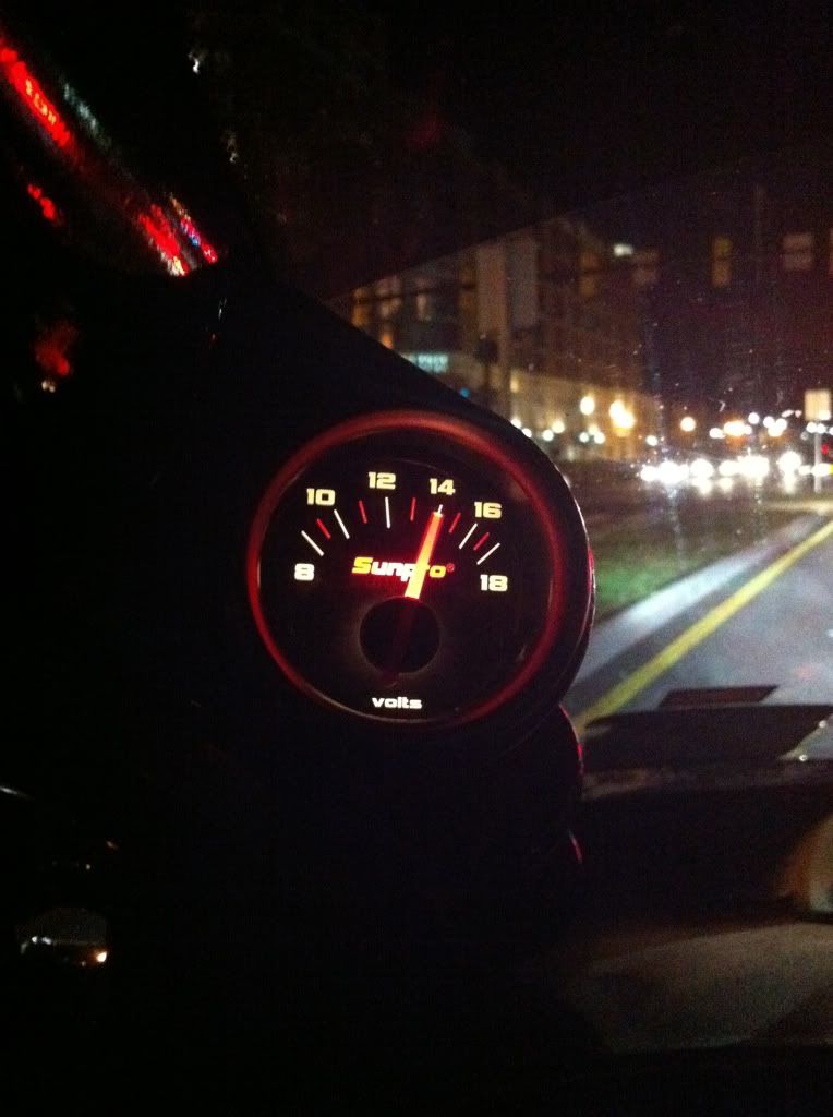

    I'm using Some sunpro st gauges. Here's a pic

    why would you do that when you can just put a T on the map sensor and run it straight into the car from there? you broke a line for no reason.....

    the map sensor has an L vacuum fitting on it. replace the L with a T and run a new line into the car. done.
