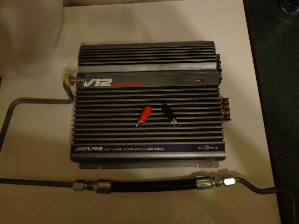

Let me know when the add is up, I might pick up some stuff. I went to the JY today and actually stumbled across a 9C1. Only thing I could really use was the transmission cooler so I picked it up, then had Oreillys make a hydraulic hose for me with compression fittings. Later tonight I'll be installing an old school Alpine V12 (Circa 1996), too:

I kick myself in the booba every time I walk past the couch with roof rails laying on it, buddy. Still planning to use them. I lag. Almost stopped in the UPI here today m'self but it was yeah so dang hot. Took a nap instead under the A/C. Blew out the shop today while mega-sweating, felt like I was breaded in bondo dust til I hit the shower. Hope the amp is a go-er. Ugh, thats another area I gotta tend to, tunes.

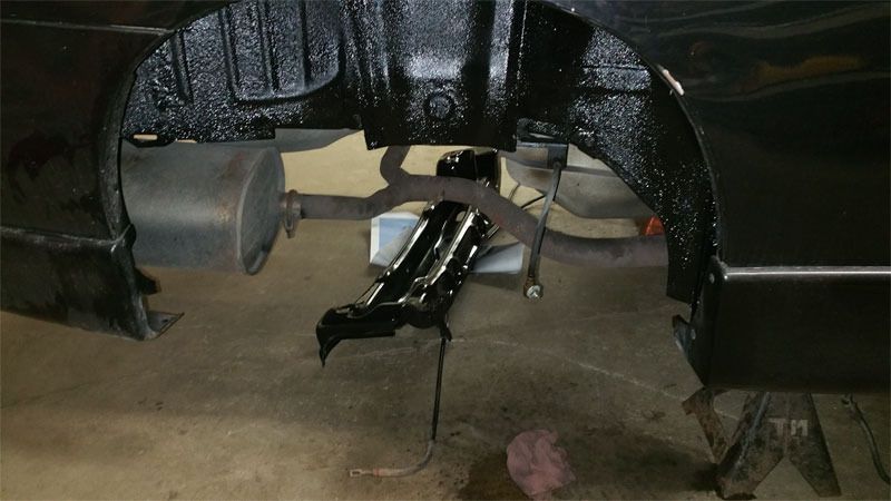

Tore down all of the rear suspension it's all laying on the floor struts cross member trailing arm brackets all of it. The cross member is still attached by the ebrake cable. Looks like it would have to be cut to remove. ??
Not sure, but it probably only disconnects at the pedal then you pull it through the floor.
It works so i just left it hooked up and painted around it. looks like the brackets that hold the cable could have been bolted on but they were welded with some popcorn welds.

worked on it from 8:30 pm till 5 am going back to the shop at 1:30 pm today. i got most every thing under there painted now i need to go put all the new parts on in place of all the 200k mile factory parts. just about every thing was stock except 1 tie rod end, the brakes, 1 hub and some dorman trailing arms i put on last year. Now every thing will be new except the brakes, hubs and knuckles.

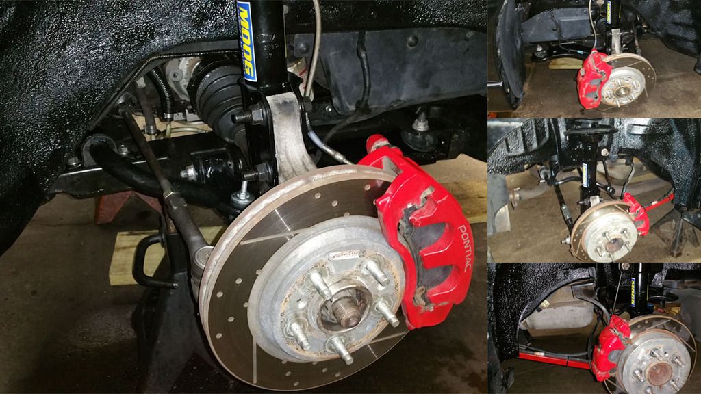

Finished My 97 GTP suspension replacement and dropped the car off for an alignment.
http://i1314.photobucket.com/albums/...psdo95oh0f.jpg
Overall it went well only broke a front sway bar end link pulling it apart. The only problems putting it together were tightening the rear driver-side bolt on the front sway bar mount (what a pita 1 click at a time) and the front nuts on the rear strut inside the trunk.
replaced almost everything, Struts, control arms, tie rod ends, front sway bar, rear sway bar, lateral links, trailing arms, trailing arm brackets, trans mount, and engine mounts. I also rust proofed, undercoated, and painted under there as well.
I know someone will ask so yes, those are 2005 Monte Carlo ss dual piston brakes up front. They bolt right up.
