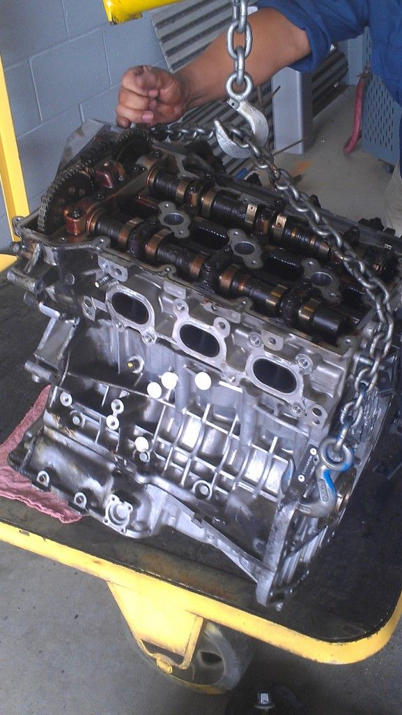

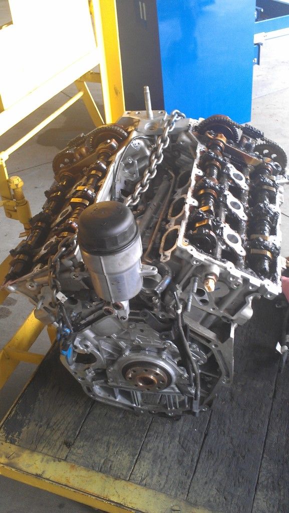

    Ill also take your offer on teaching me some AutoMotive stuff, theres always room to learn new stuff in todays auto industry. Just make sure it has nothing to do with 07' Hyundai Sonatas Quad cam 3.5L V6, bc im tired of rebuilding and learning about those.....more experience then u think, My bad if i was sounding Auto-retardant....heres my most recent build, this lady didnt change her oil in 70k miles...WOW
    [IMG][/IMG][IMG][/IMG][IMG][/IMG][IMG][/IMG][IMG][/IMG][IMG][/IMG]
