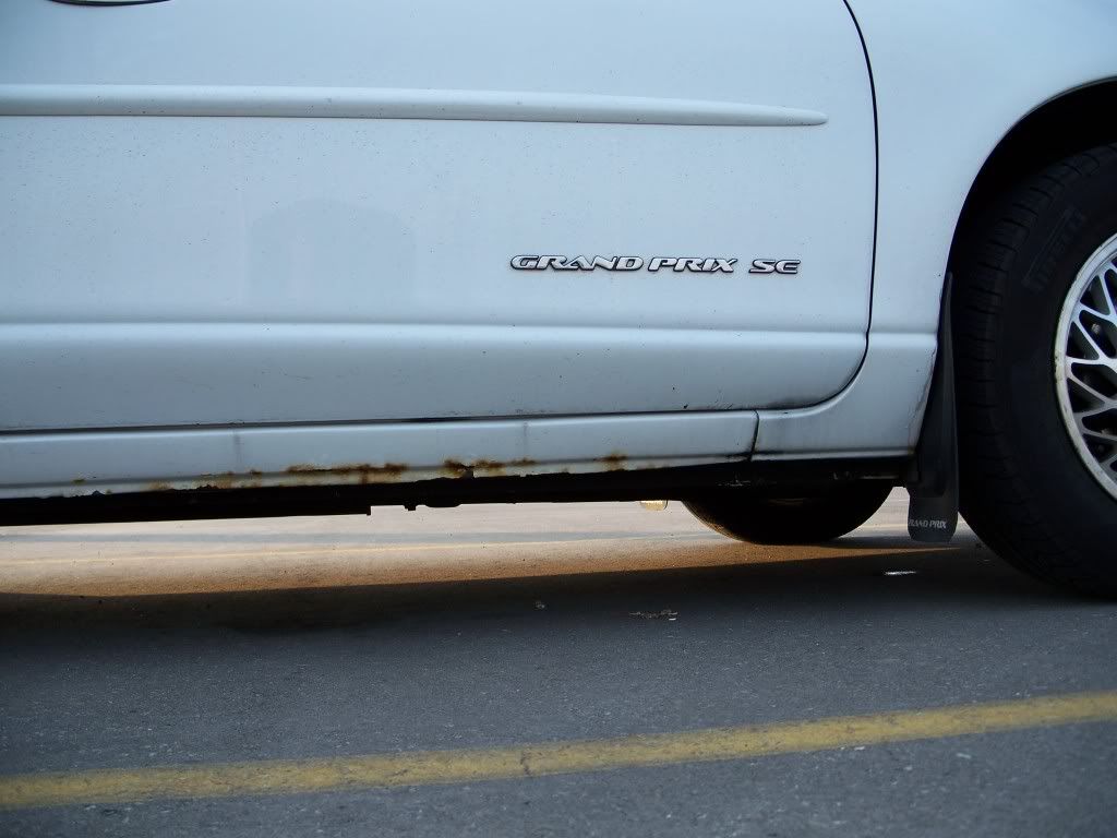

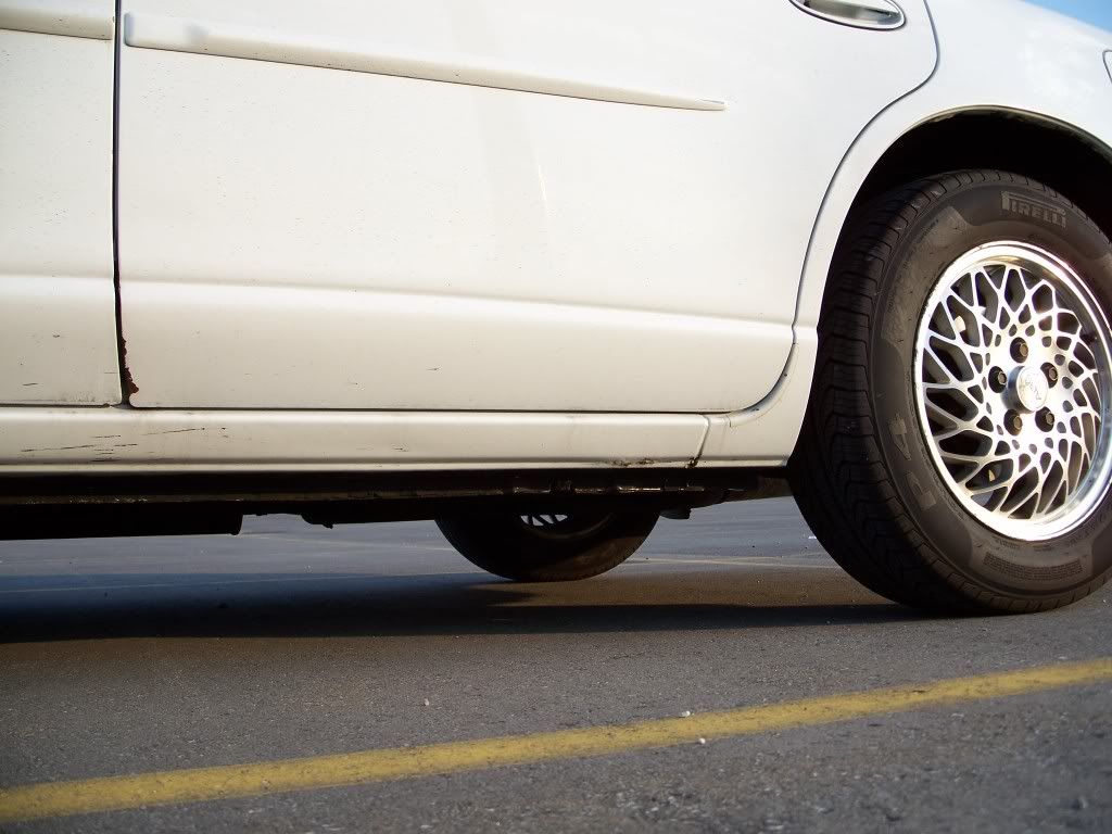

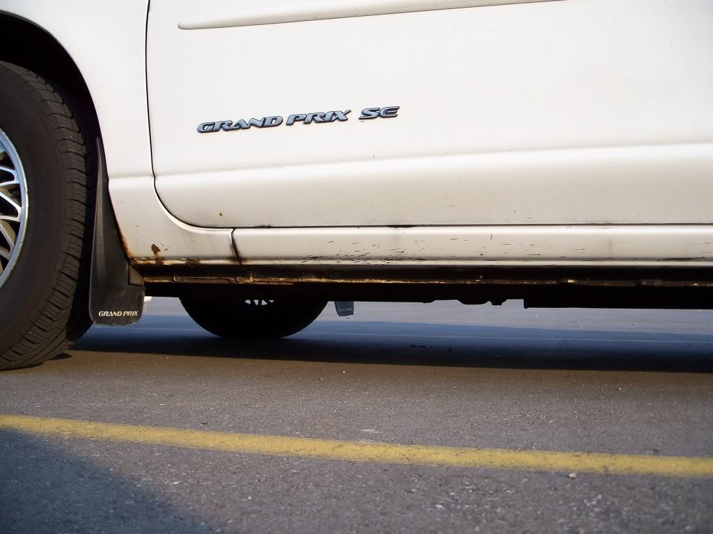

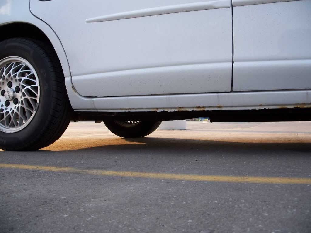

    Body shop will charge you out the ass. Your rockers look pretty decent just do it yourself. Eastwood.com has come internal frame coating and also heavy anti-rust you can spray on the rockers from the under side to seal it up. Exterior paint remover disk or sand blast. Small area you can rattle can and it will come out fine.
