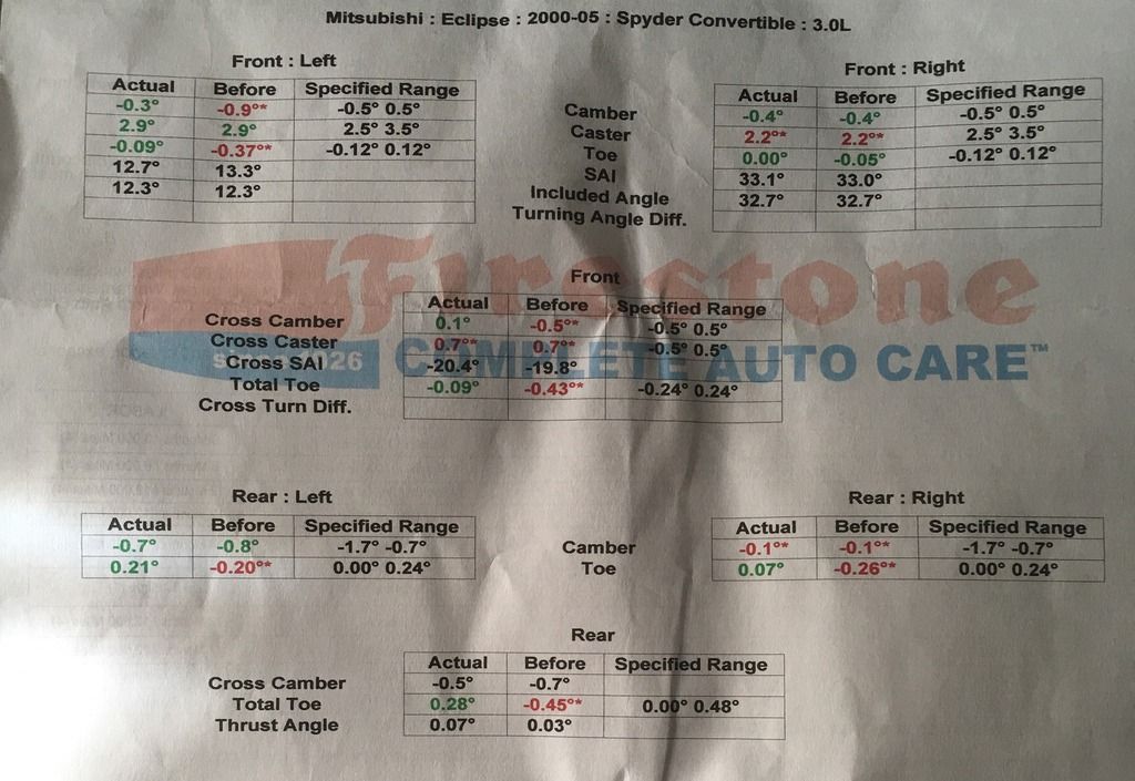

    Just wondering if anyone has any advice before I go forward with a new set of tires
    mods are as follows
    kyb agx struts x4
    tein springs
    camber bolt in front struts
    adjustable camber brackets in rear
    (added 2 more washer behind each bolt on the brackets because last year the adjustment was at the max and the tire was still wearing the inside edge in the rear)
    Tires are 225/40/18
    Now last April everything suspension wise was replaced with new moog parts and I loaded them with poly bushings
    *last week I noticed the inside of the front tires are now worn down to the belts! And the back inside tread was cupped.
    Tbis was after I had it aligned following the work I did
    so I just want to check - it's aligned again and before I get new tires again - any thoughts ?
    thanks!!

    most of the inside wear is/was from the negative total toe settings. the wheels are pointed out and are scrubbing off the leading edge of the tire. toe is the largest tire wear angle by far.
    good that u put in the camber eccentrics to correct the front. the r/r camber is out of spec in the positive direction of the spec, which should wear the outside, not the inside of the tire. have you changed the springs? a -0.1 camber setting will not wear tires. It may not corner as well or maybe change the vehicle load to the smaller outer wheel bearing a bit. I like to keep my settings in the factory limits so I would do a rear adjustment.
    the cross caster is a bit high? does it pull right?

    Car rides straight.
    I had negative camber in the rear from day 1 after lowering. The tops of the tires tucked hard.
    So I bought adjustable camber brackets for the rear. Turning the bolt slides the upper U shaped arm in and out.
    Last alignment the guy said he pushed them out as far as they would go and it's close but not perfect but way better then without.
    So just for my peace of mind I bought 8 new bolts and lock washers (35m long) and 16 washers
    put 2 washers behind each bolt on the brackets - figured this would help kick the tops out more then I have all that room left in the adjustable bracket to kick it in if needed.
    Maybe the tech didn't know I had adjustable brackets back there ?
    The he cross caster blows my mind. No idea ?

    if it drives straight don't worry about the cross caster...its only out by 0.2 which is f-all. I thought it might pull on a crowned road.
    cross caster that is out to much will cause the steering wheel to turn off-centre to the side of least positive caster. the weight of the car pushes the spindles to the lowest point. while driving at hwy speed, if you center the steering wheel and release it...if the steering wheel pulls itself off-centre...either the cross-caster is out or the tires are conical.
    measure your ride height, if its up in the r/r....lower you r/r coil over

    -0.3 and -0.4 when it calls for -0.5,. the toe is -0.09 and 0.00 when it calls for -0.12. HA!
    my only thoughts are: don't go back over there, have a decent shop fix it and ask for you cash back.
    evidently they don't know what they are doing.

    Had an alignment on the 03 at the local fleet farm.(not the best place but was convenient) Here is the before and after specs. Pulled slightly to the left before and still does after. Maybe more. Taking it back today to recheck.
    Any thoughts? Feels like it needs some toe.
  14. #14 Re: Alignment results. Any input?
    It's not an alignment problem, it has equal toe on both side with dead center total toe with 0ยบ steer ahead.
    Unless they started with the steering wheel slightly off center it's not going to pull to one side and even if the steer ahead of slighty off the total toe is within spec.
    My guess is a radial pull from one of the tires, way more common than you think. I'd swap tires side to side up front and see if it pulls the other way.

    ^^^ pretty sure you are right. They rechecked and rebalanced the tires and put the two they could not road force balance in the back ( basically I rotated them) I will know how it drives on the ride home tonight. Probably time for new tires sometime. They are probably out of whack from running with so much toe for who knows how long.
