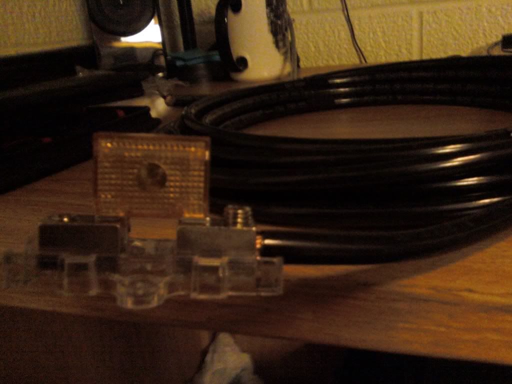

    here is what I got for my new wire for my sub.
    It is 2 gauge wire that I got from home depot I got the inline fuse from wall mart (it accaully seems pretty solid). this look good to you guys.

    I doubt you will even blow the 80, just leave it in and see what it does.
