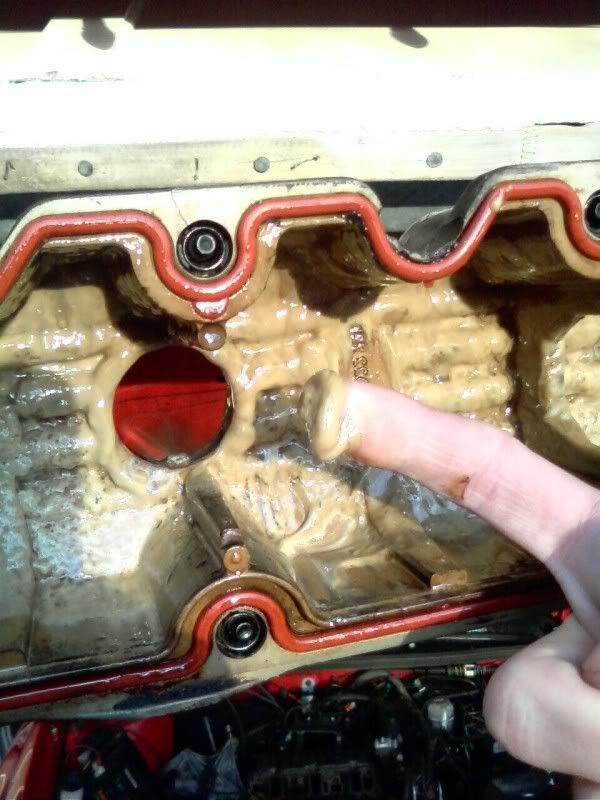

    i wrote the #'s down wrong it was the #3 that was low. but i pulled it all down today and almost threw up....this is what i found under my valve cover...
    who would have know that you cant use coolant for you combustion?!?!

    cleaner? head gaskets? opinions?

    Can you get some pictures of the valve train? Normally I would just say that that is just oil vapor whipped up with condensation, but good Lord that is a LOT of it. If the valve train looks the same Id say it may be time to maybe replace the head gaskets. But IF that is from coolant being dumped in the engine, I'll never understand how you didnt spin a bearing nor how come the oil never showed milky on the dipstick.

    the oil is milky so i drug it home as for the bearings...i got lucky?...but ya, i will post some pics of the VT when i go out to work on it tommorrow!

    For cleaning out the engine once you get it all back together, I would put new oil and a new filter on, start the car (provided it does for ya) and let it idle until its warmed up. Dont rev it up or drive it, just let it idle and get everything warmed up. Then I would drain that oil and put in new oil and a new filter.
    Then I would drive it around the block a couple times with the second oil and filter, again, no heavy acceleration or anything like that. Then I would drain that oil and put in new oil and a new filter.
    Now, since it seems you have probably gotten quite a bit of coolant contamination it is likely you have built up some sludge in places. So on that third oil change and filter, I would get me a bottle of Auto-RX (you can google that and get to their website) pour that in and follow the directions for it.
    Auto-RX is by far the finest engine cleaner money can buy and it will get rid of any sludge and varnish build up and should clean out any remaining coolant contamination. If you buy the Auto-RX, then once you are done with the clean and rinse cycles, you can switch over to any oil and filter you like to use.
