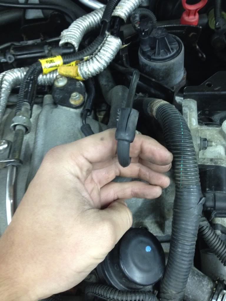

    Could this be causing it? This is the one at the throttle body.

  7. #7 Re: Running Rough after VC Gasket
    oh the busted evap line. i broke that one too.
    i got a fat line, then jammed a smaller one inside it, then the plastic tube into the smaller vac line.

    mine did that after changing rear plugs. the broken evap plug you showed first was the reason
