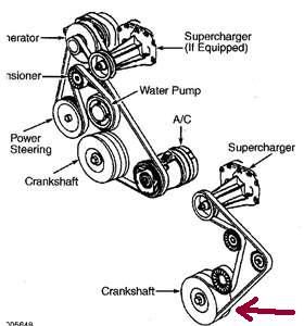

    Likely your belt is not sitting on the crank properly. Meaning it's one groove off. This can happen fairly easily on the SC'd cars as it's tough to see/feel if it's in the right place. I'd feel for the grooves/use an inspection mirror to double check it. Maybe untension it a bit and check that way as well.
    Which side of the belt is worn, side that faces the passenger strut/battery or the side that faces the motor?

    This is the belt diagram. As Bill said, check where the arrow is. That's where mine was off. But mine caused a squeal. I would remove your belts and check for a bad idler or tentioner pulley.
