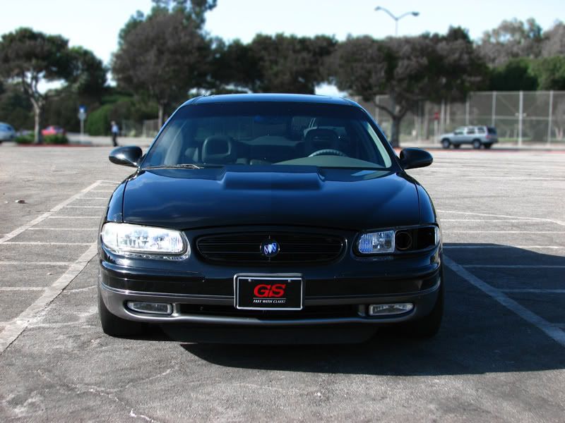

    has anyone ever created a "ram air" box? by that i mean fabbing up a scoop that sits under the bumper, then is routed up directly to the filter be it in the fender of engine compartment?
  8. #8 Re: Quick question on Air Induction CAI
    that would have way too many bends to make any good intake. the only way to do it would be to mold a scoop into the headlight area.
    dean did it to his regal:
    it probably works decently. you might also be able to get away with ducting something from the foglight, but honestly ram air is a bad concept anyway. you have to be going in excess of 150 to get any sort of boost out of it.
