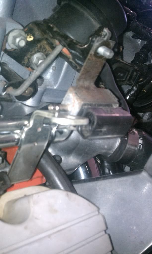

    headers on, oil changed and car is off the jack stands seems so low lol... Does the alternator brace go back on? I don't reall see a way for it to go back on

    No thats stage one weight reduction.

    not necessray. i couldnt find a spot for it either. or all the engine pull brackets for that matter
  8. #8 Re: Taz's Offical Summer/Fall build list.
    Alternator bracket...both engine pull brackets...ABS bracket...need I go on? All those dumb things need to come off.

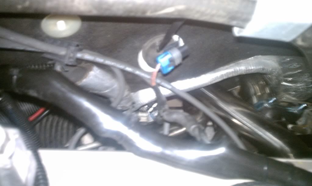

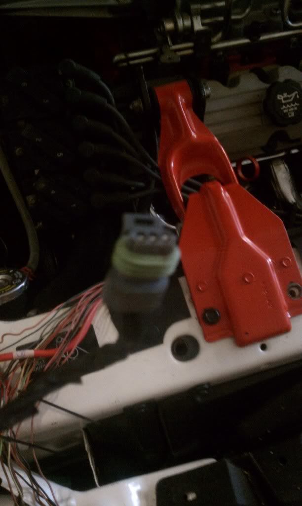

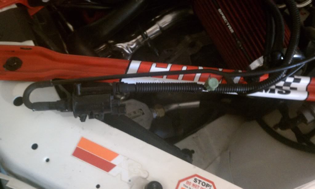

    Got a few questions here
    this sucker has always just hung out next to the alternator pluged into nothing but I think it plugs into
    the little black thing on the fuel rail
    and any reason I shouldn't just chop off this connector and solder the wires together? just trying to get all the extra wire and bulkiness out of there
    also this thing on the fuel lines, does it stay or go?
    and I forget where I unpluged this guy from I know its around the bottom on the passenger side somewhere

    the thing on the fuel line is part of your evap system, it stays. and the last sensor is probably a crank or cam position sensor. it acts like it won't reach, but it does. feel around down there a little bit. as for vac lines, one gets ran from the map sensor to a T on the end of the lim, and the other end of that T goes to the... evap thing i mentioned if i remember right. and after that it's supposed to go to the bbv and then to the throttle body. there's a nice diagram in my build thread

    On the alt bracket. I use the 99+. Yeah..I do.
    heck..had a 2.25" IC on the Bonne and still used it. Just egged the hole out a bit.

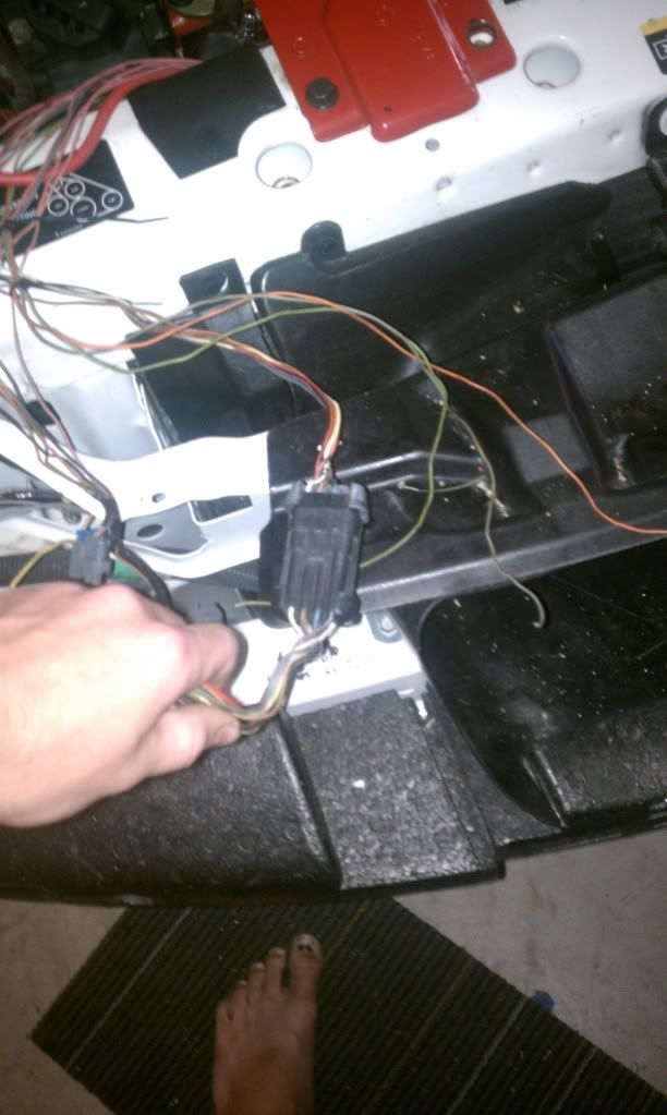

    awesome thing about moving the fuse and relay box inside is that aftermarket wiring other stuff is super easy now

    The one pictured by the BBV is the bbv solenoid, usually if you unplug the connector to this it limits the car to 4-5psi. I would definitely have it hooked up along with the vac lines, there will be one open vac port to free air on that, I'd have to double check which one.
    The other is evap like said above, you can disconnect this an cut/plug the vac line coming from the firewall. Make sure it stays plugged. Paul will have to delete the codes from the PCM. Paul is pretty handy with this stuff as well if you have questions.

    figured out all the plugs just need to do vac and fuel lines and all idlers and tensioner
