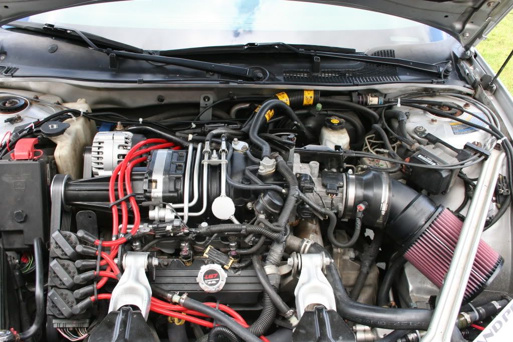

    Yeah just run open cone. FWI is more restrictive.
    Here is mine
    SMGPFC Two Nipple General
