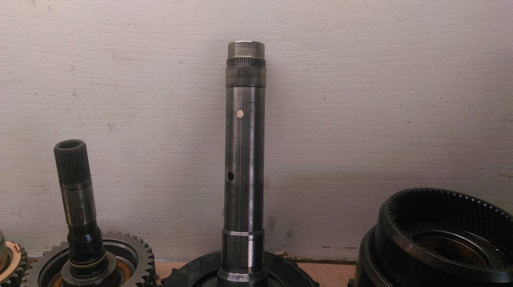

    Swapped out trans with used one..now no 4th gear..not setting any codes..
  7. #7 Re: Transmission Problem
    Mar 2014
    Tucson
    3,192
    10
    146
    Stripped splines on the 4th clutch hub. That's my bet.
  8. #8 Re: Transmission Problem
    Jan 2016
    Southwest Mn
    14
    Oh man, Are you serious?
  9. #9 Re: Transmission Problem
    Mar 2014
    Tucson
    3,192
    10
    146
    Yep. Fairly common on the older units.
