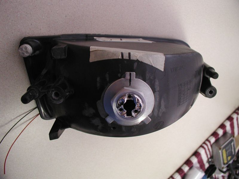

    Last night I removed the shroud and the thick rubber gasket (between projector and housing) to give me more wiggle room. I was able to get the angles and such for correct alignment:
    And this is how the stem of the projector needs to sit:
    I am going to try and make/modify a curved washer with an offset hole.

    Last night I trimmed the shroud and one corner of the projector, and I can now get proper alignment. This pic is a bit low and right, but I can adjust that now upon the final install.
    Thanks for listening.
