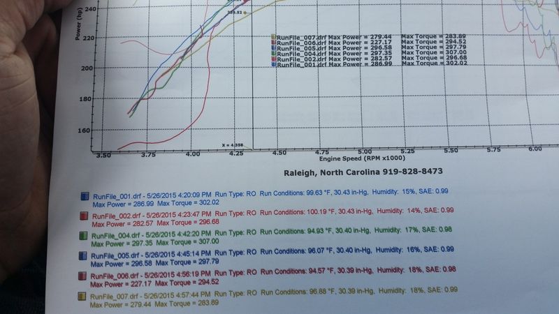

    best runs were like 297whp and only like 307 wheel torque. Knock knock knock knock knock fvcking knock

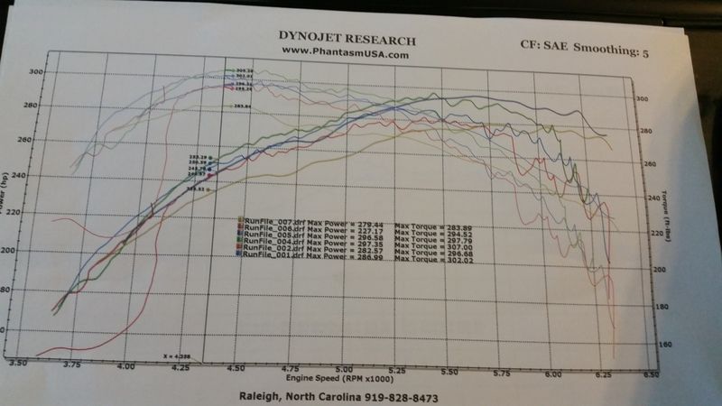

    It was hot as balls there, so that may have played a factor too. All runs were in 3rd gear, and if you look close on the graph you can see a little trans slippage. It was noticeable when i was in the car on the runs.
    The higher number on this one is with the 3.0 pulley on my tuned timing table. The lower number is with the stock timing table.

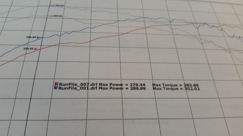

    It varied. On the graph with the two runs on it, the 279 was with stock timing, so like 15*. The other run was with my timing which was i think 18* wot. Both runs knocked like at least 2-3* on the stock timing, and like 5* on the other one.
    On the best runs I had the 2.8 pulley on it. With 14* timing commanded, but according to my log I saw 6* of knock on one of those. So yeah. Engine go boom soon.
    The sad part is i normally see little to no knock. I've been running the 3.0 with 18* timing for like a month and the most i've been seeing is occasionally 1-2 degrees. But it's hit or miss and It's not even on the highest boost or even all the time at WOT. They really thought it was my gas today with a little trans slippage and heat mixed in. Either way i'm disappointed.

    The graph with the two runs, shows the first run of the 2.8 and 14* timing VS the 3.0 and 18* timing.
    2.8 wins.
