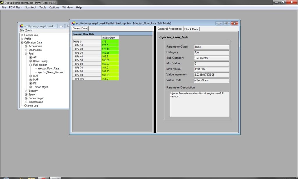

    open dhp, go to file, then "open calibration file", find your saved bin file. then it opens for you, its a tree drop down program, rather simple.
    codes are in the diagnostics folder. top folder find your code# set it to no report, then find the same code in the bottom folder, make it a 0 "zero" that codes gone.
    injectors in the fuel folder, drop down to injectors iirc.

    Got everything figured out but the injectors.
    I downloaded "42#Injector_97to2003_V6.bin" file the firs time around the links were posted. I can't seem to open it with either program, so it isn't a calibration file but just the map for bigger injectors?
    Or do I need to import this file into my bin or am I missing something completely?

    this is my 42 file i started at 161.00 for all cells, then tuned them in to make my ltft right, left the maf 100% stock still.

    Wow thanks Scotty you da man! I appreciate it!
