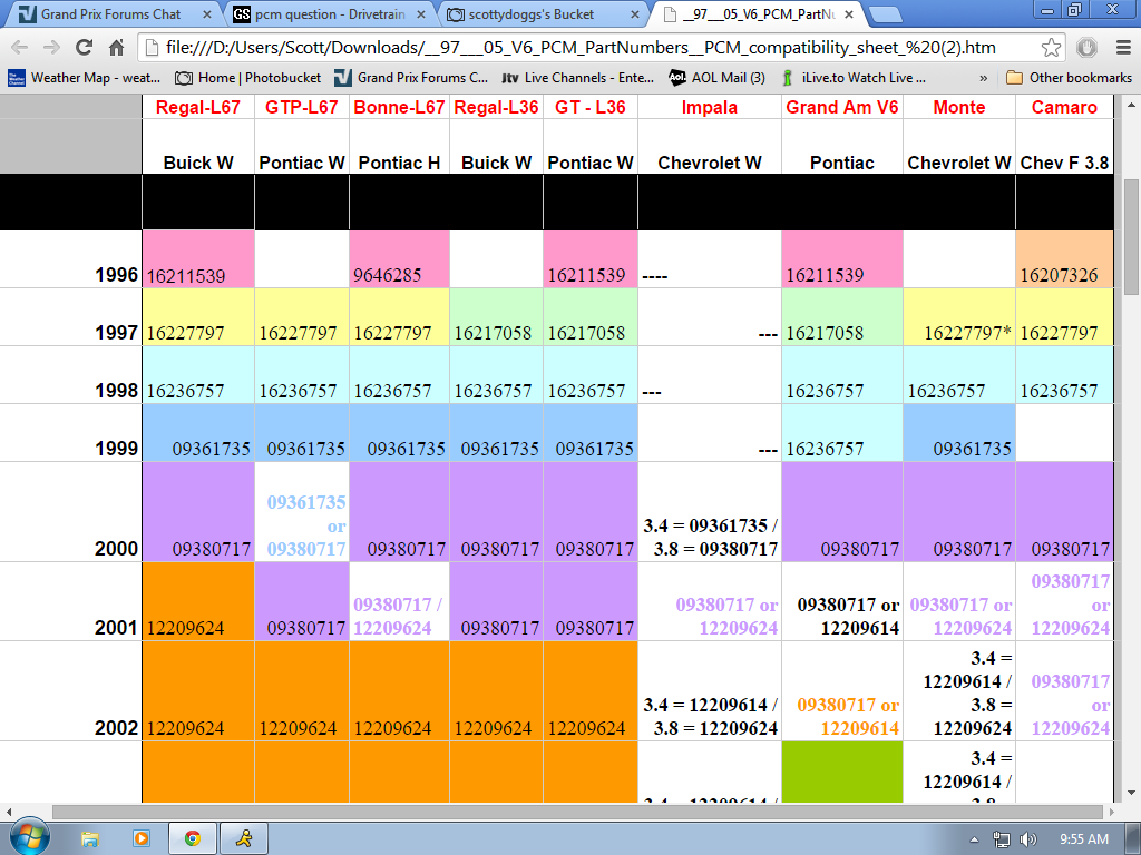

    I have a 2001 gtp that ive been working on lately. my last gtp was a 99. I use the pcm from the 99 as a spare, but for some reason yet to be determined, the 99 pcm doesn't like to be run in the 2001 and when it is, the car does not run as good. I think something might be wrong with the 99 pcm because all the changes I did to it with the dhp didn't register.

    99 and 01 are different pcm's part numbers, could be why. i do have my 98 on a 01 pcm. but that dont always mean they will work.

    when i did the 01 pcm in my regal i did it in the car, and then it went into the compatibility mode window, then i had to pick a years and engine combo that matched my car. and it went fine.
    that compatibility window has not come up on the off board. nor have i been able to make it open up again. so im thinking when you switch a pcm with non matching part numbers it should be done in the car.
    maybe if you put the pcm back to the 99 bin, then try to flash it in the car, it may work better if the compatibility window opens up.
