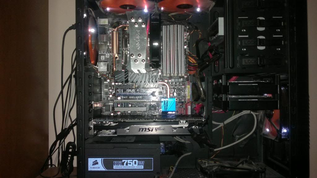

    For example I am rocking a AMD Athlon B65 x4 processor. If you haven't heard of it, its a xII 565 3.4 Calisto dual core, that is unlocked to a full quad, same as a 965. Then overclocked to 3.72Ghz. I peak at 48*c under full load, idle at 30* in a 76* house. Best cooler I've ever purchased.

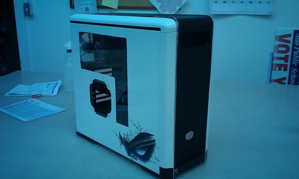

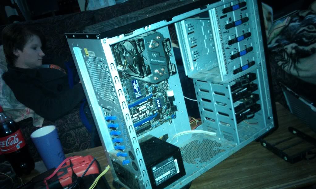

    For some whorage, my rig. Old CM690 Series 1 cast, custom wrap and window mod. Blue lights inside, I need some complete shots, this was just after the case was wrapped and window was installed.
    During tear down, for the mods and frame painting, went Semi-Gloss Black for the frame. You can see the cooler, its HUGE!
