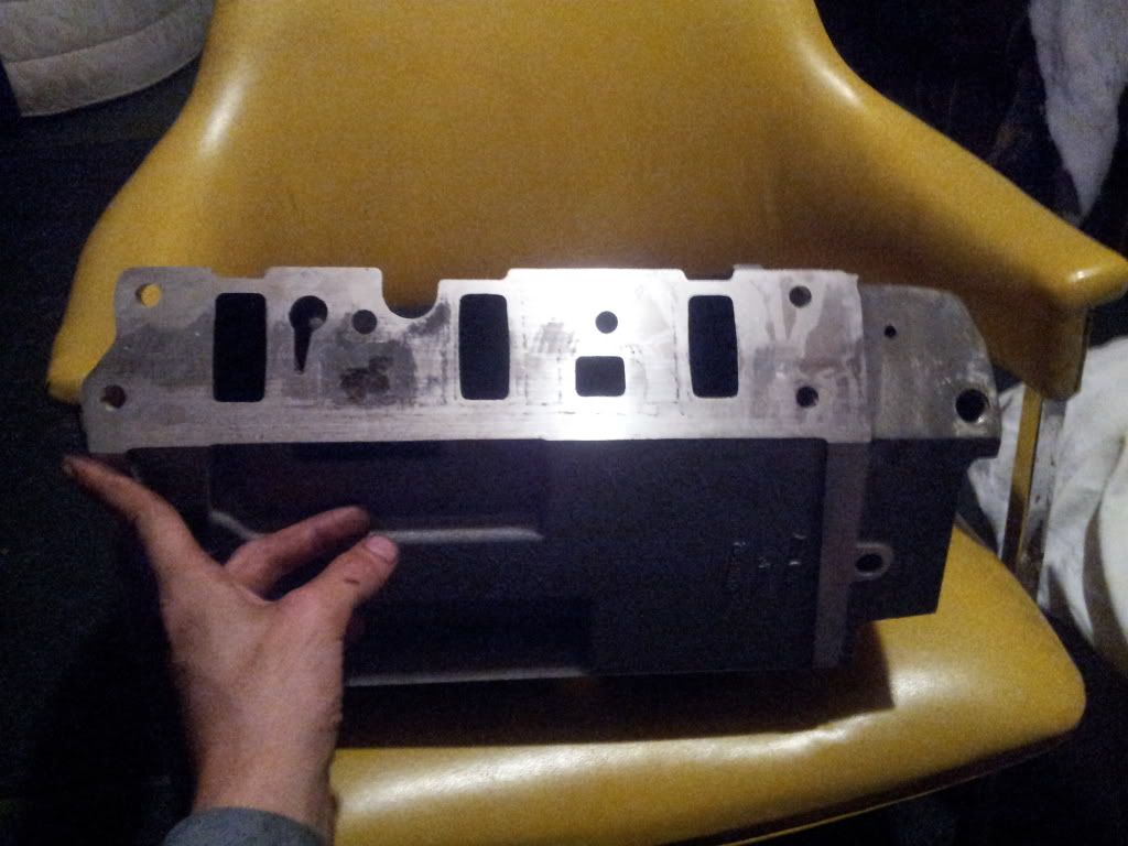

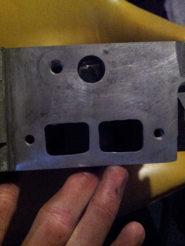

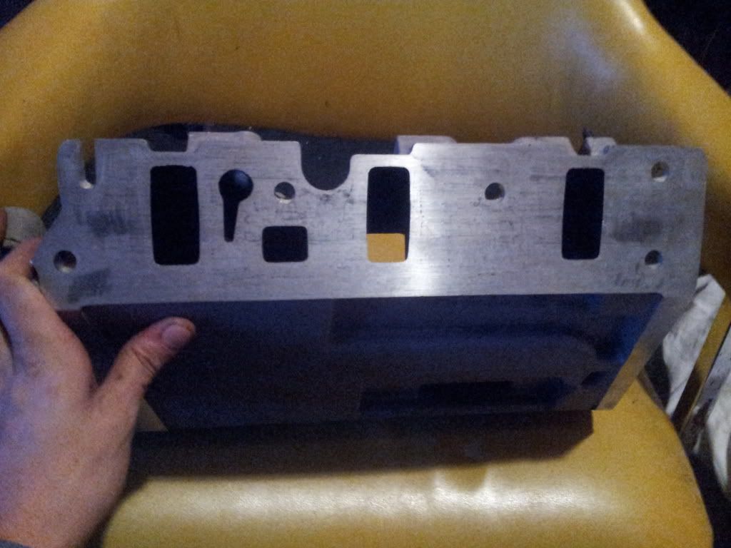

Looks GREAT, Are you gonna plug the coolant holes on the top side? If you don't the coolant will just get stopped\blocked by the TB adapter plate, but the coolant will still be going into the supercharger. GREAT work!

Yeah im groing to try and find something to block them the dimes sit up to high with the metal gasket

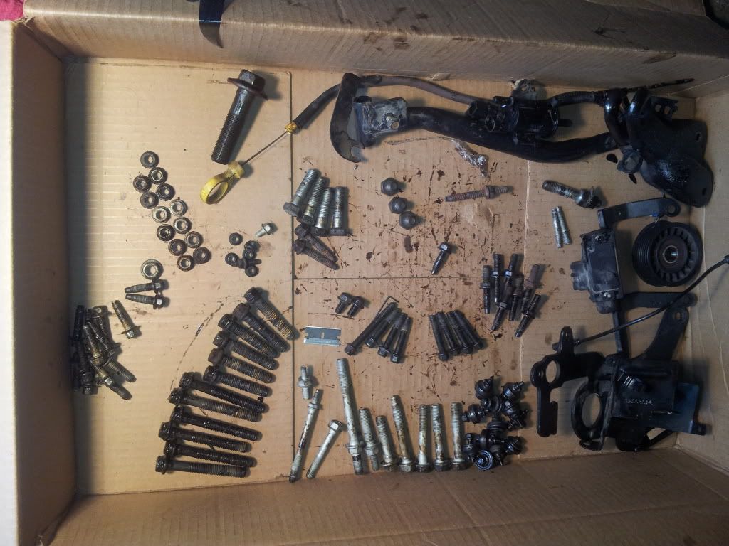

http://i1341.photobucket.com/albums/...pscb942aad.jpg ok so here is a big box of nuts and bolts I got alot to remember lol

I used a Dremel to bevel one side of the dime's edges, I may have had to make the dime smaller overall, but if I did it wasn't much because I don't remember, lol. Once the dime was a tight fit, I put some RTV in the LIM holes (to help seal) and tapped it in with a socket.

Is that just rtv sealer packed on?
Re: started tear down of the 01 motor
JB putty for the coolant holes. For the EGR just a penny or dime and some rtv in case I ever decide to throw the egr back on.

Alright sound good, now a question can I get it bit that fits my torque wrench with allen key?

You should open the driverside of the lim up where the coolant flows.
I'm pretty sure he said they did do that. It doesn't look like much lol
The little squares I had opened up to the wall, doing another az run for the jb puddy and hex bit.
