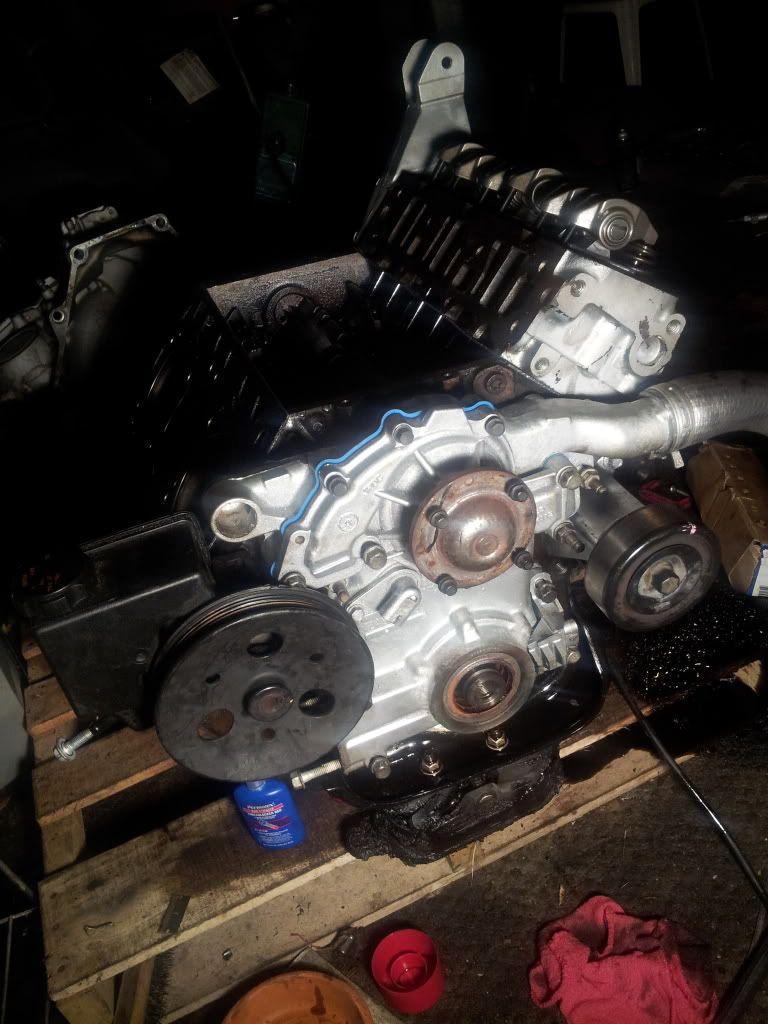

Maybe my build will get you motivate, and yeah I it should be interesting building this motor completely
Nope it hasn't lol

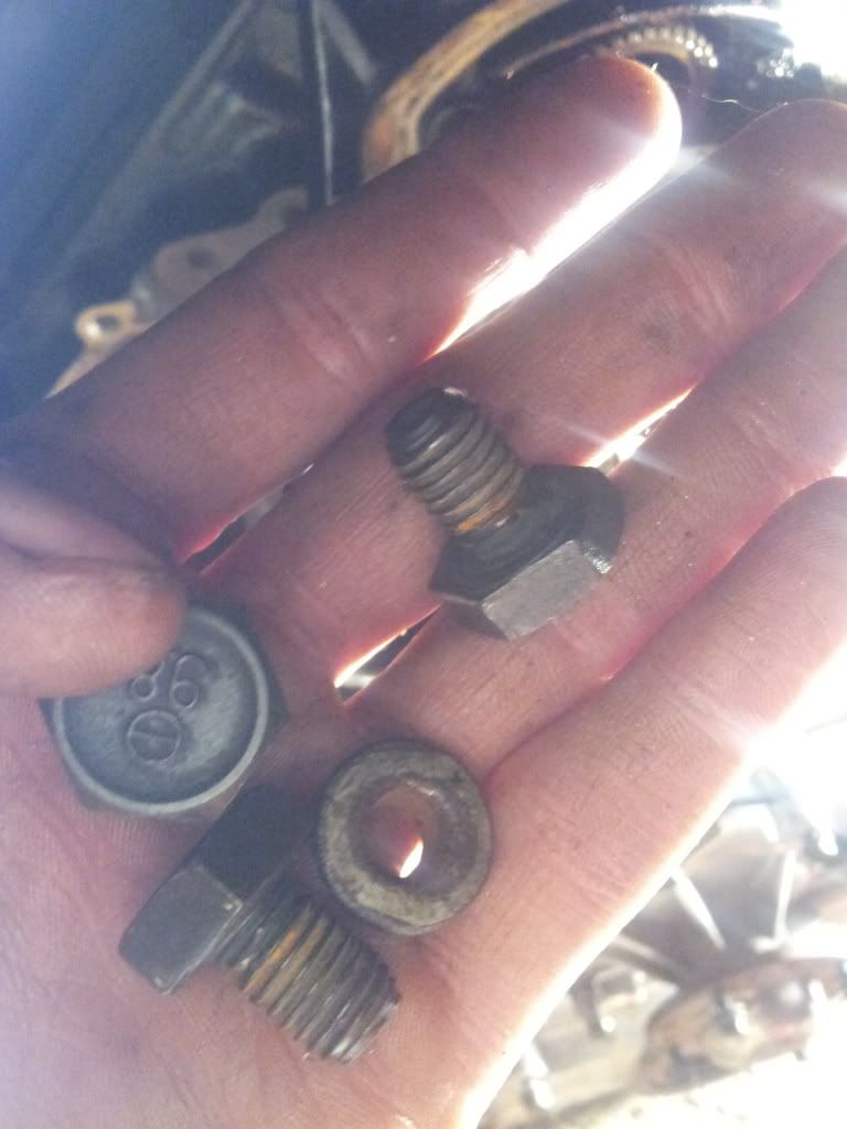

http://i1341.photobucket.com/albums/...ps394760a7.jpg okay so I messed up and I can't remember where these three bolts go and the one nut I placed it with my timing chain and cover bolts any ideas lol and I have heads on weith push rods in going to work on it with my buddy's tonight told him I would get them beer to help lol
those 3 bolts look like the torque converter bolts. the nut no clue.

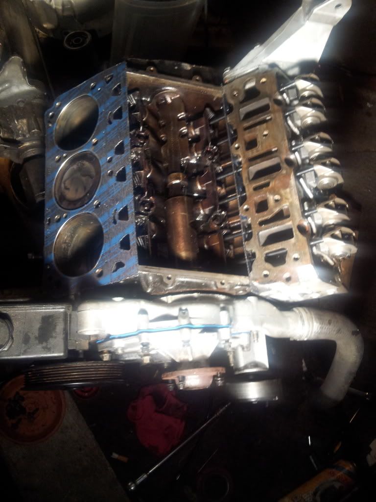

Ok so buick is home, I think its the starter put a battery in and nothing still. But im going to go outside here and work on the motor some more I dont have a 13 or a 8 that fits my torque wrench and I need a bit that will fit it as well to use on the rockers, or can I just put the heads over them?
