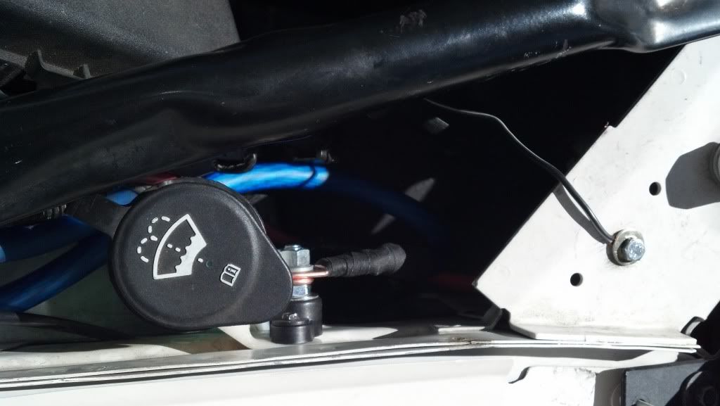

How'd u mount that battery post and what type is it? I like that way better than what I'm planning. Hides more wires
http://www.ebay.com/itm/77037-BATTER...item3387552c55
conviently it mounts to the washer resovoir brace using the screw already there from the factory
for your ground wire i used the battery tray bolt and washers and screwed it to the body. that was a temp solution at the time but **** it, it works awesome
