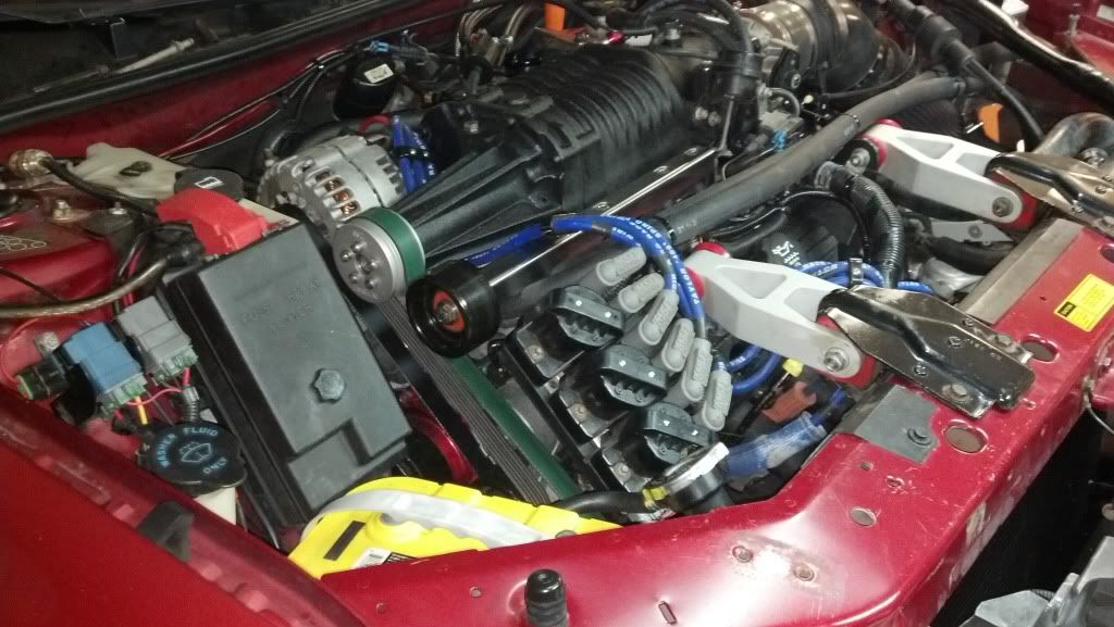

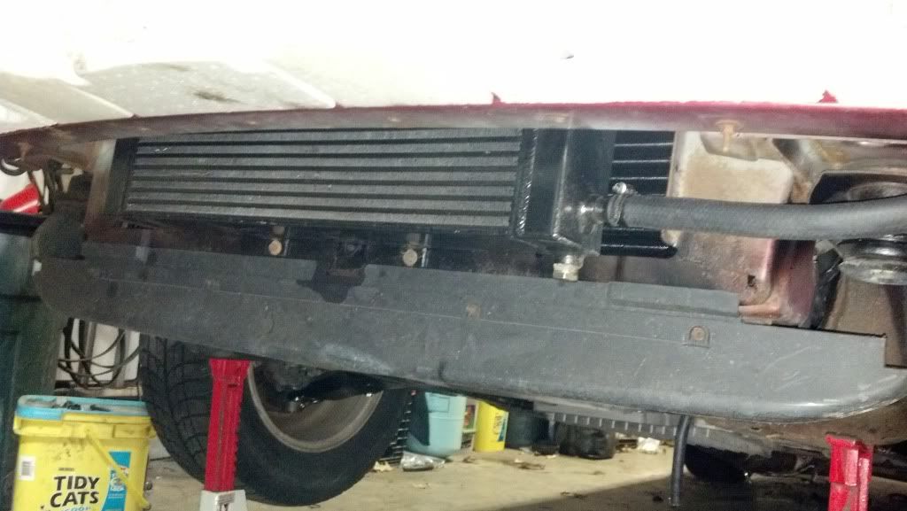

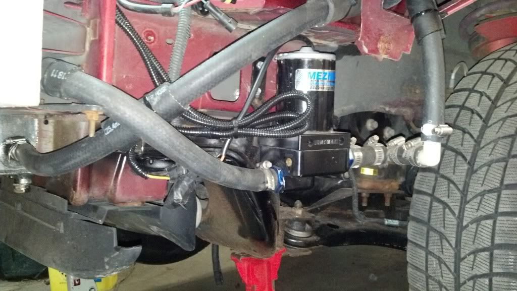

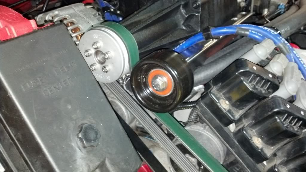

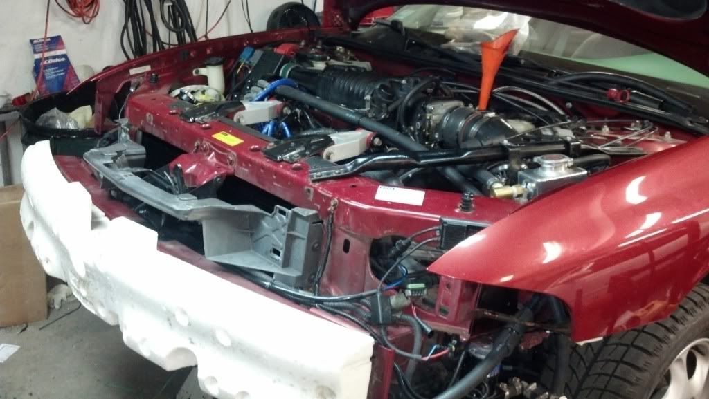

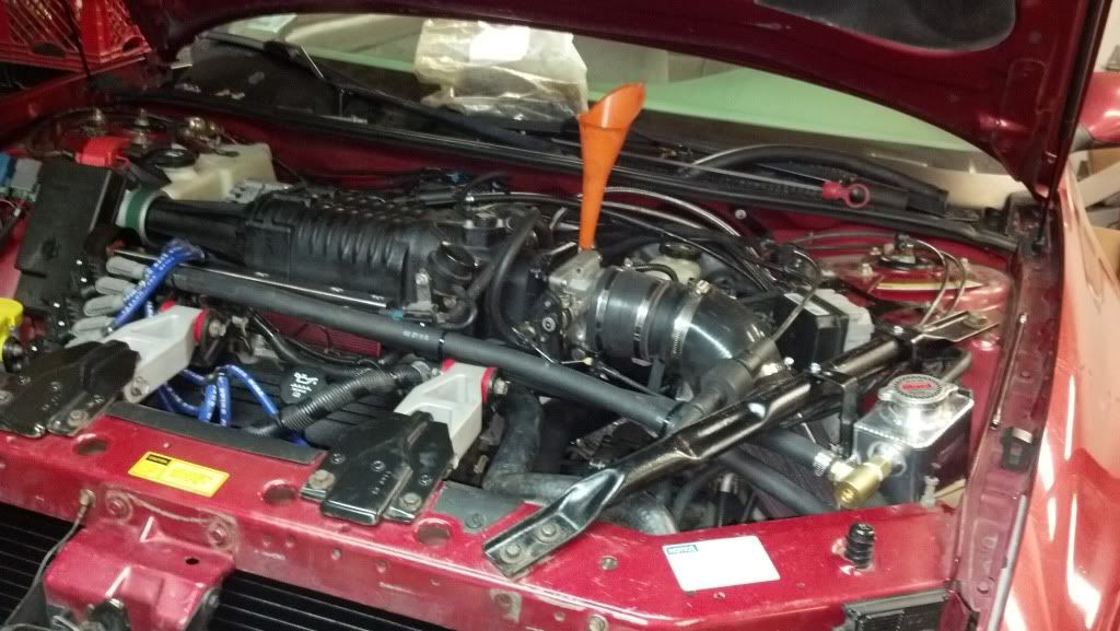

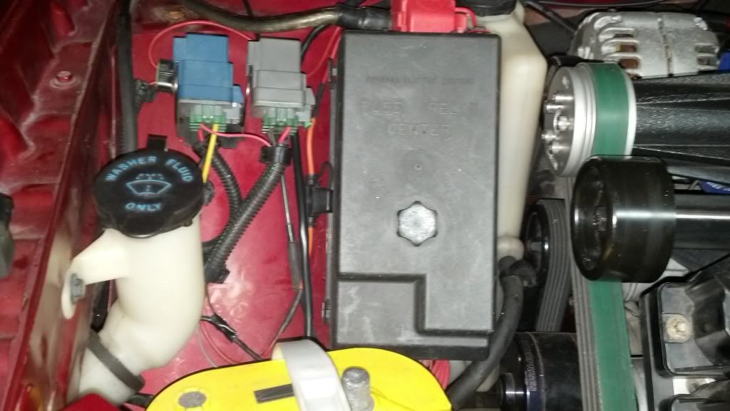

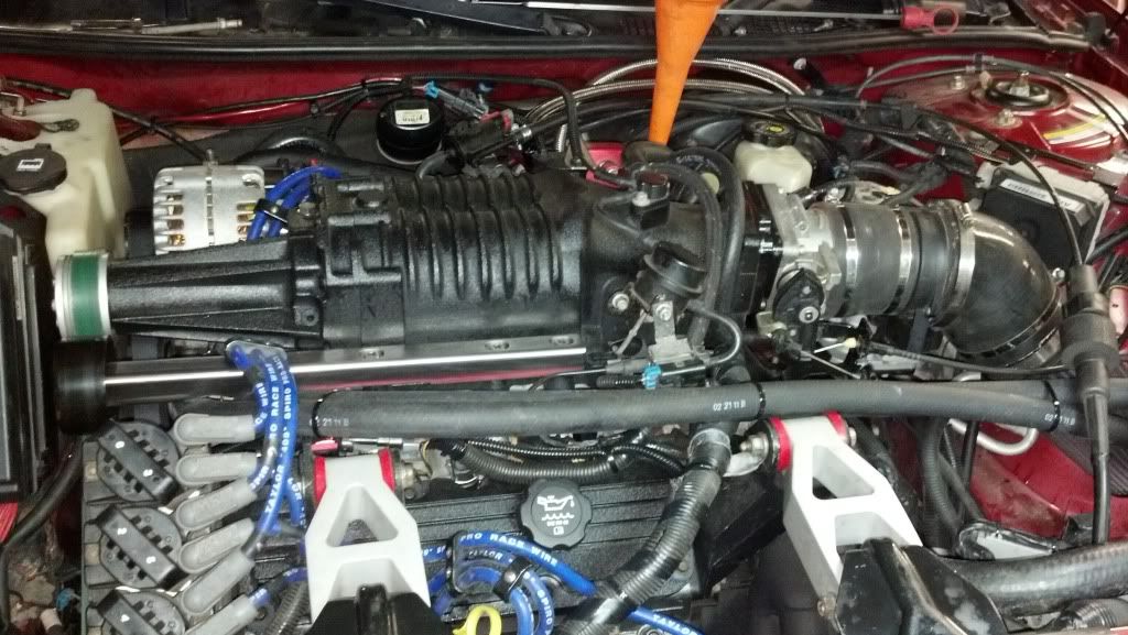

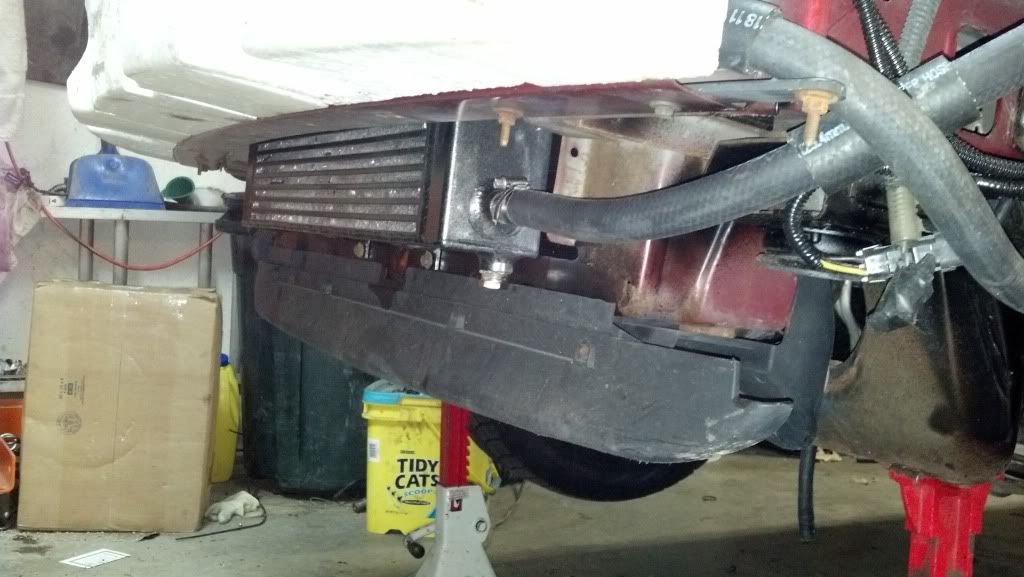

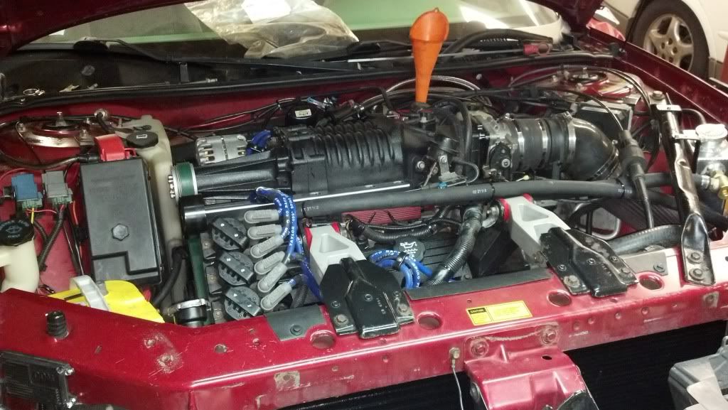

    The Good: As of today, the car is completely all back together. As far as how everything came out under the hood, I'm pretty happy with it. I have a few more things that I'll be doing to clean up the engine bay but here are some pictures to show how it looks.
    The Bad: The car does not run since Bill and I are trying to figure out which L67 PCM file to use and flash the car with. Since I have a 98' Intrigue, HPT does not support it. But, even though I can use DHP, its an L36 file. Since I have the supercharged MAP sensor and BBV, I need to start with an L67 bin file. Can't get it to work though. For some reason we were having a hard time just using DHP to write over an existing 99 GP GT PCM but once that was finally fixed, we flashed a stock 2000 regal file onto it using DHP. Then, since Bill has the 2000 regal wide open on HPT, I created a 2000 Regal GS file and copied over the appropriate MAF, injector tables, torque management, and transmission settings. Once we flashed it in HPT, we then tried to start the car with it and didn't work. Since my security light was on and would not turn off on the dash, i thought that the theft deterrent system had to be reset so I performed the security relearn procedure. That didn't work since the security light never turned off after the 10 minutes. So, upon further investigation, we noticed that the shift indicator on the dash was not lighting up when changing gears. Its almost like the car is not getting a signal from the transmission. Next step is to flash a 1998 regal gs file using dhp and see if the car likes it. We were thinking that a newer bin file (from a 2000) may not be the same as 1998. Hopefully that'll work. If anyone else can offer any help it would be appreciated otherwise we'll be just trying different things until we can get the car running.
