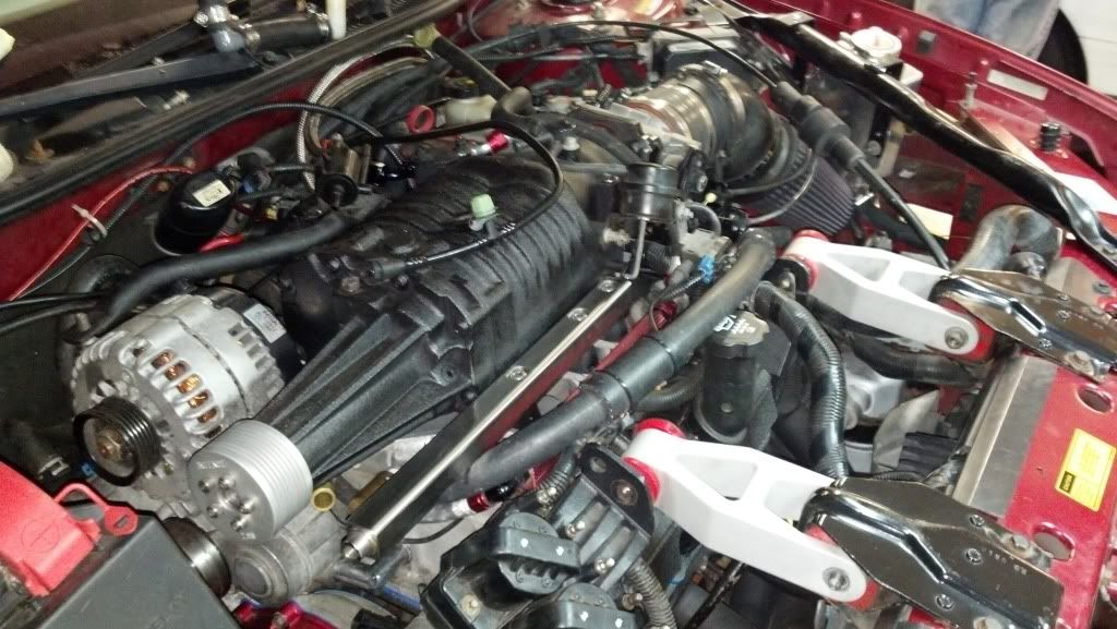

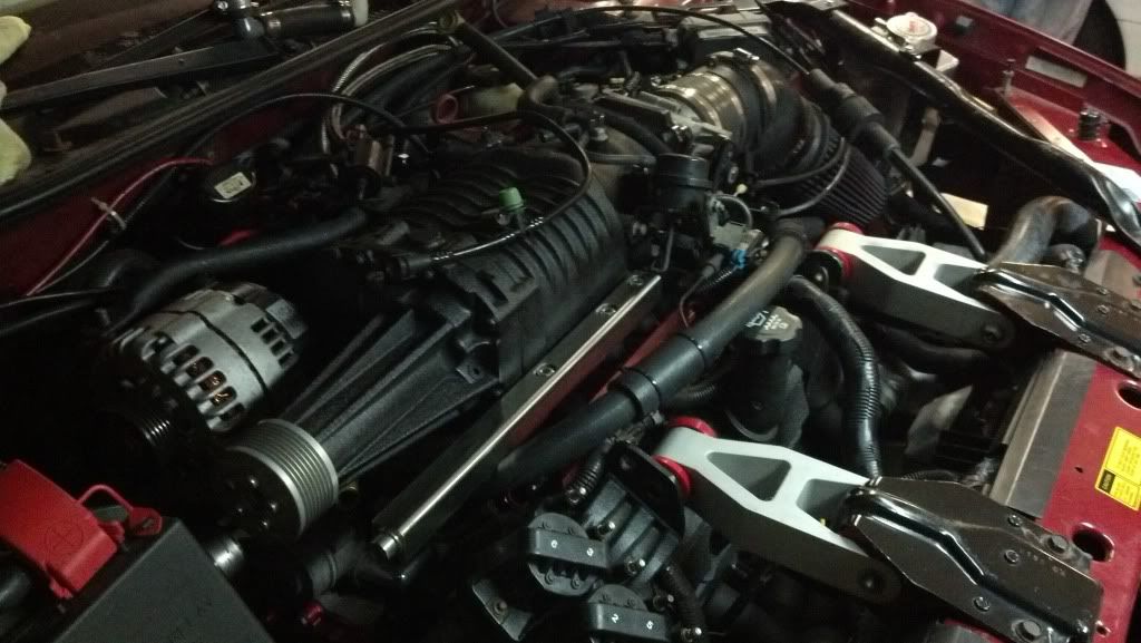

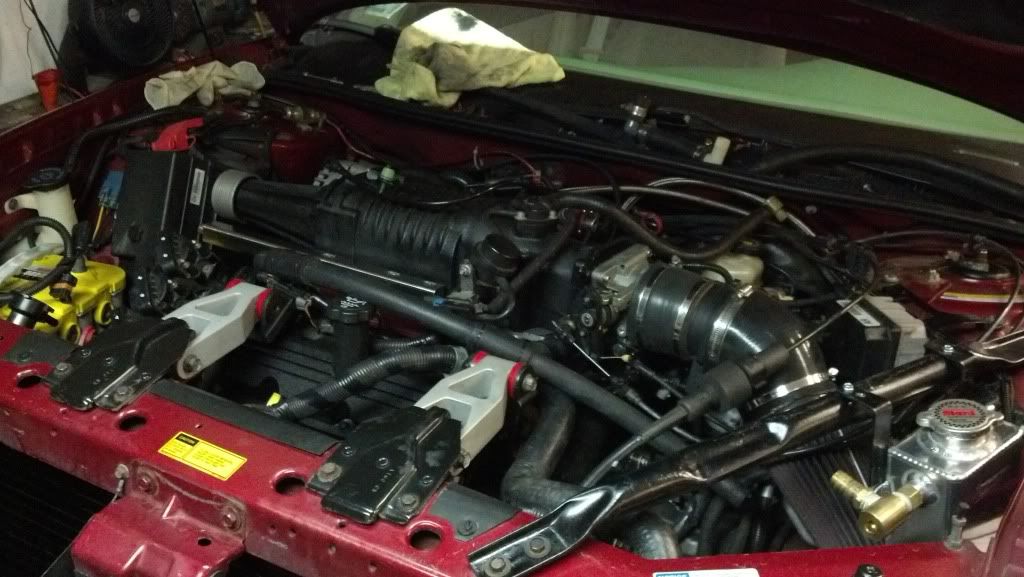

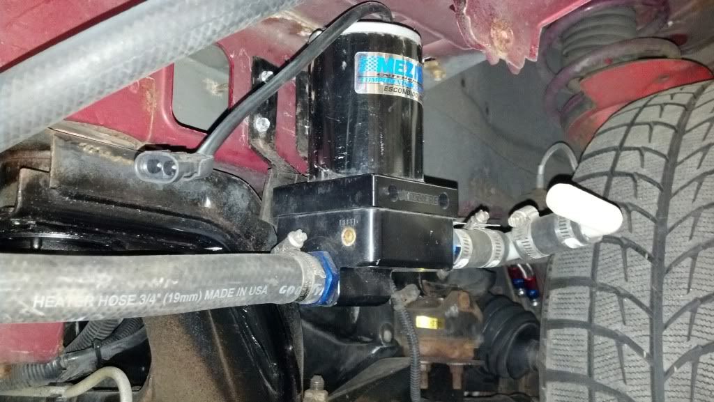

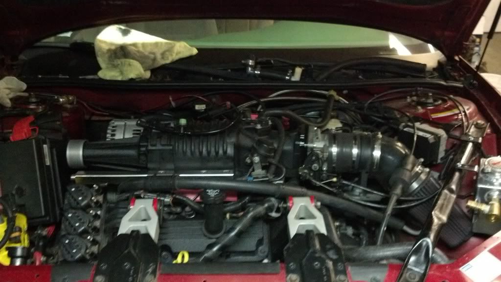

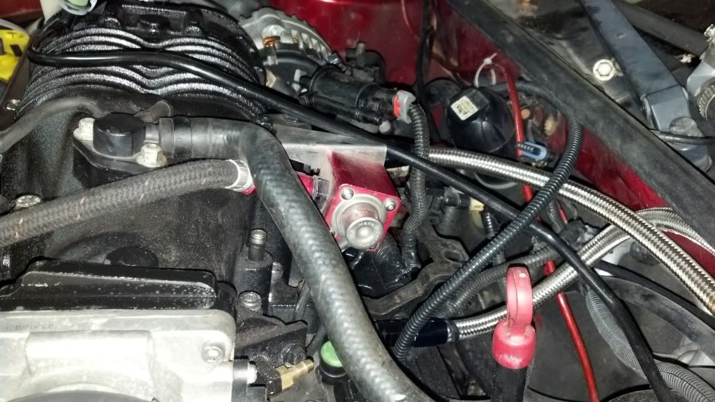

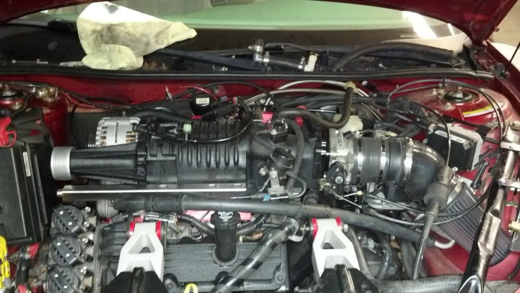

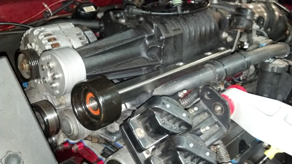

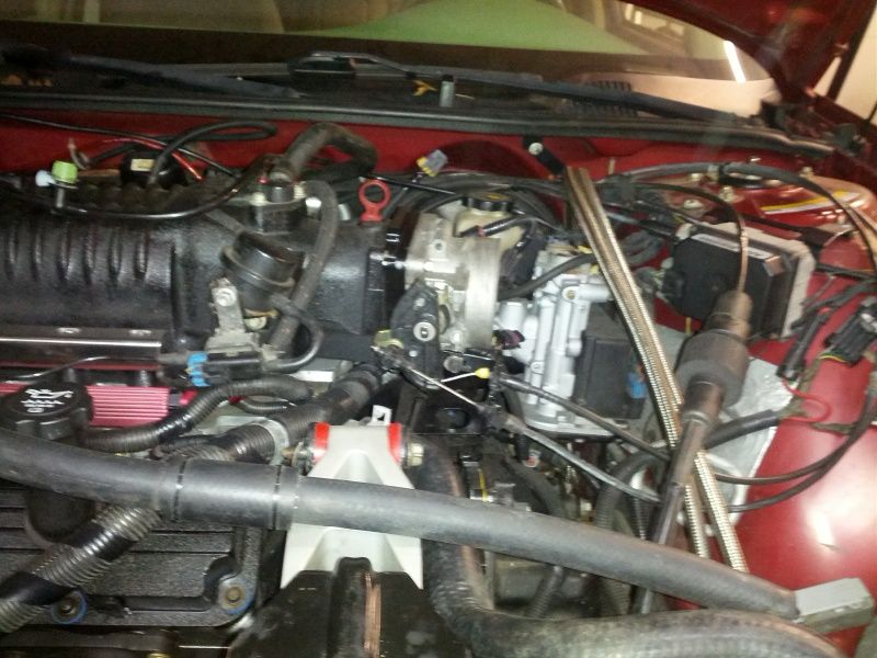

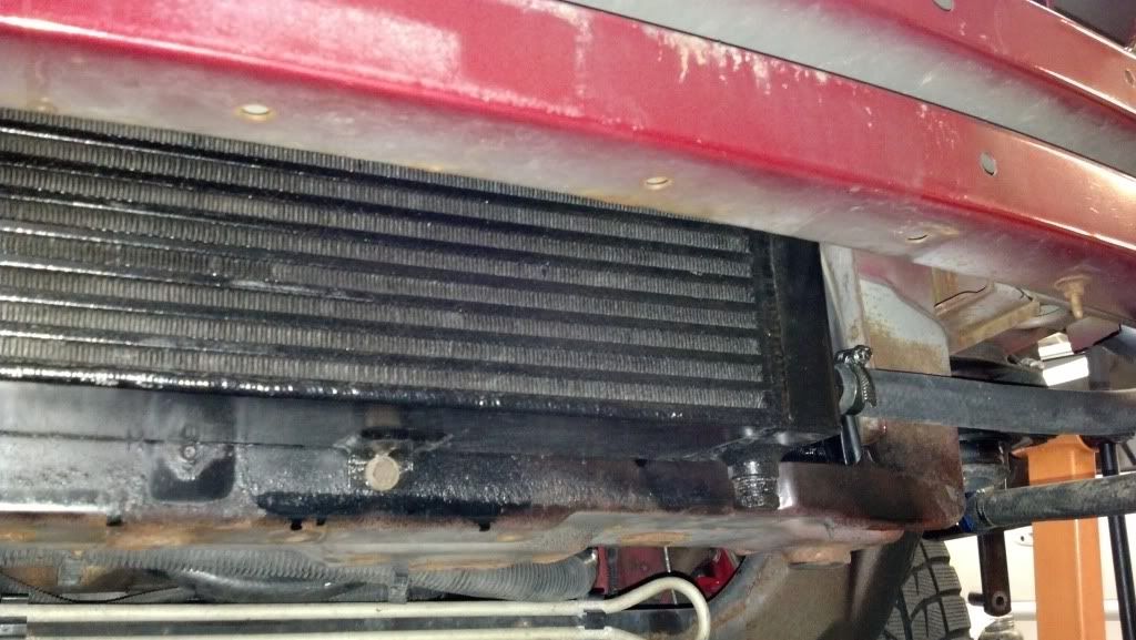

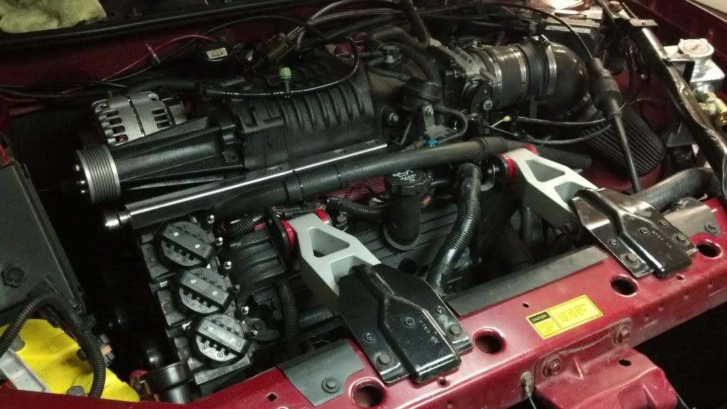

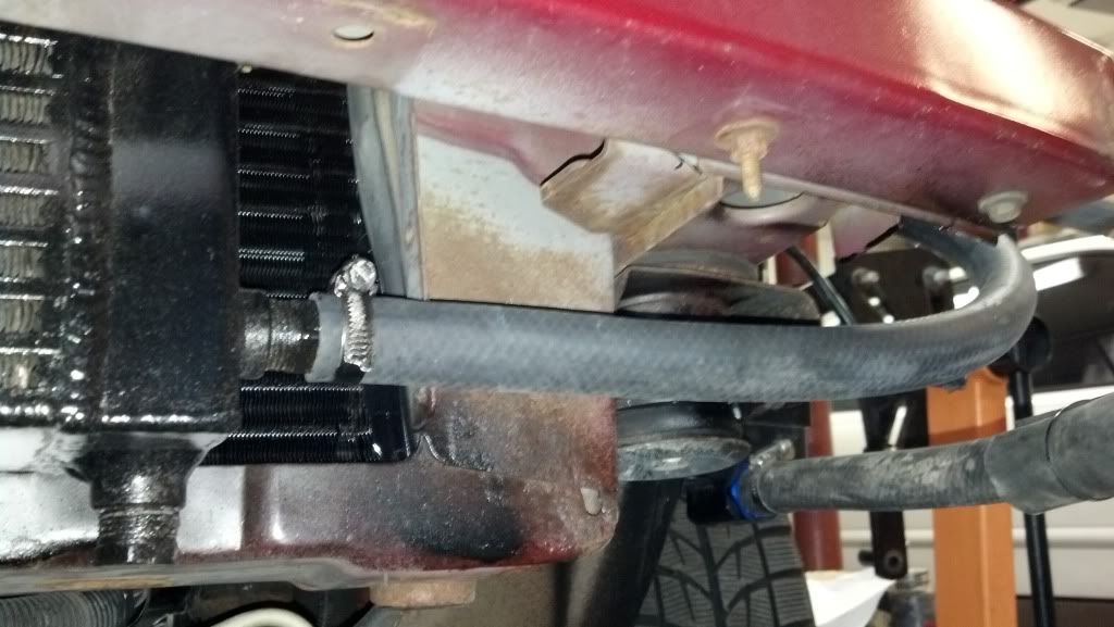

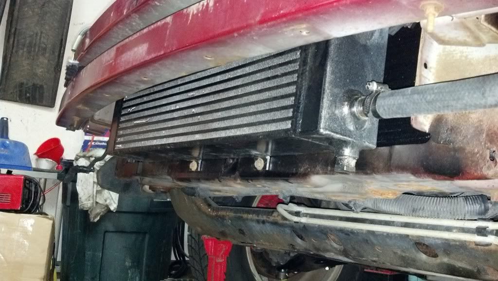

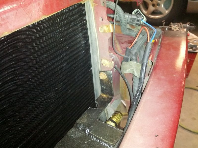

    As promised, here are some pictures from tonight's work. Bill got some things done ahead of time (since he is Bill) so when I arrived the heat exchanger was mounted, N* flipped for hood clearance, and the subframe was ground down to make it easier to route the hose for the IC setup. Tonight we finished the trans lines, finished the fuel lines, MAP sensor, mounted IC reservoir tank, and started routing hose. Things are getting there! Saturday I'm expecting start-up. If things go well tomorrow night, might try cranking it.

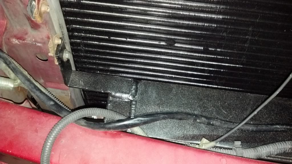

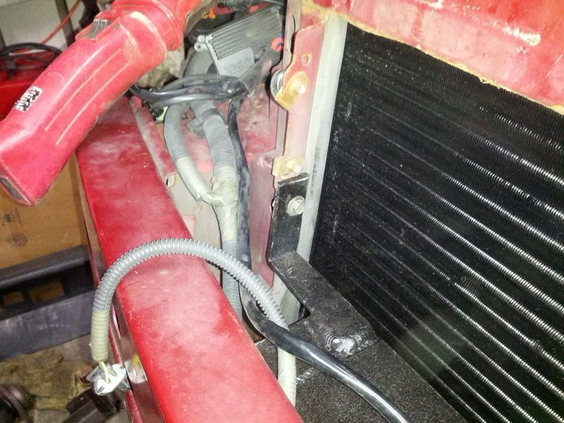

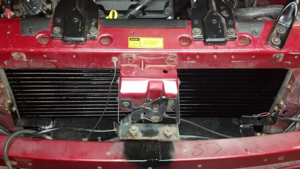

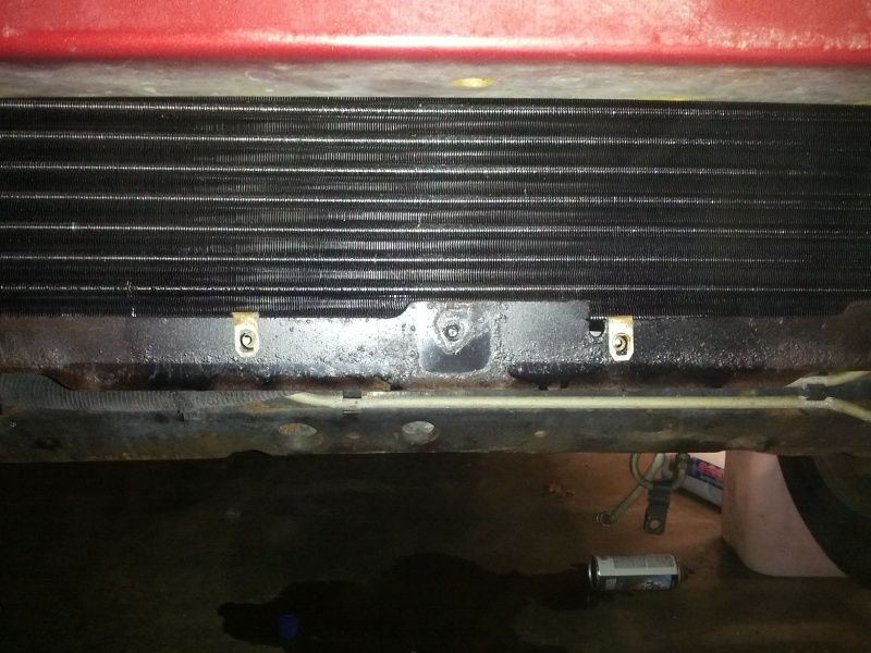

    The pics I took of the install:
    Held IC core in place, marked where the bottom holes would line up, drilled them, painted them, put the clips on for the bolts.
    Once the bottom was held, did the same to the top using existing body holes.
    Bye bye tow hooka and corner piece
    N* flip

    With an allen/hex key stuffed in one vacuum line, no belts, no power to ewp or IC pump, barely putting the plugs and wires in/on...yup we turned the key. I think it's down a cylinder and Max thought maybe one wire wasn't on. Did we mentioned wrong maf table, wrong injector table... yeah that started on the 98 stock L36 Intrigue tune.
