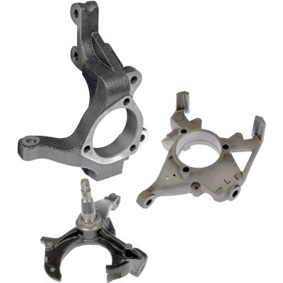

The bottom, dogbone shaped part of the thing is touching the rotor, guaranteed.

Yep, exact same problem, no noise going forward, squealing in reverse from passenger side only. It's just a little sheet metal tab. If you can get under your car, just pry it gently away from the rotor a few millimeters. It's the same on the other side, kinda o==o shaped, so you may need to give each side a little prying.

Those tabs are under the ball joint right behind the wheel? Looking at the image it looks to be only one circular tab attached to the control arm?
EDIT: Actually no on location. It's in front of the ball joint, I *think* attached to the steering knuckle OR the wheel hub. I couldn't find *any* pics online so that was the best blind reach around pic I could take since car is too low to get under. The tab is mirrored on the other side, all one piece. It looks like a bow tie, or dog bone shape.

There we go. This is from a 97-03 but same tab in same location on ours.
Looks to be those tabs are connected on the steering knuckle.

The brakes are actually PowerStop brand, Brakemotive is just another reseller of them. The tab is pretty thin sheet metal, doesn't take much to bend it, I think it's a gasket to prevent the hub from corroding to the knuckle.
I had pulsed squeaking at first, every time I backed out of the driveway and was told it was just fresh pad dust plus the zinc plating and just needed to wear through it. After a week of that, I took the wheel/pads/rotor/caliper off (got new caliper at same time) and wiped them all off and THEN got a constant squeal every time I reversed. Wasn't till I got the car on ramps that I could see it was BARELY touching the rotor.
Turns out I had the exact same problem. Got under the car with a flathead screwdriver and some pliers and pulled that clip back some and the noise is gone. Last thing I would expect it to be lol. It seems the thing that was causing the problem was in front of the ball joint.
